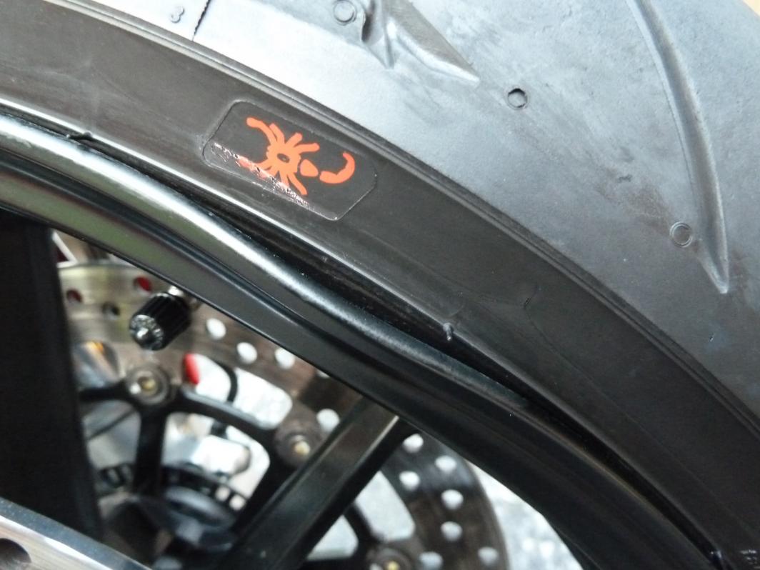

    Hi Guys, I have a 2010 Speedmaster with a front wheel slow puncture, it loses about 8lb of pressure a day, I have had a new tyre fitted, I have put it in a water bath and there is no obvoius leak, there is the odd bubble appear round the rim about every 2 mins,but that does not seem to be enough to lose that much pressure, I brought it into work yesterday and had the wheel bead sealed. I checked it this morning and it was 8lb less than last night. I am now at a loss.

    You would think a dip underwater would expose any leak anywhere, guess you have checked the valve? Could try over inflating the tyre by about 25 psi and then re- dip the whole wheel and tyre to see if it exposes the leak.

    Yep could work but I think I would personally still like to find where the leak was. If its only doing it since the tyre change it could be a defect in the tyre itself, or has the inner rim of the alloy wheel been scored at all by a tyre lever? You can get porous castings within alloys but then the tyre would have always had a slow puncture.
    You can certainly damage them:
    This was on my nearly new Ducati and cost me £700.00 + for a new wheel!
    I always carry a can of Holts puncture sealer for emergencies.
    Done when I hit a pothole :frown:
