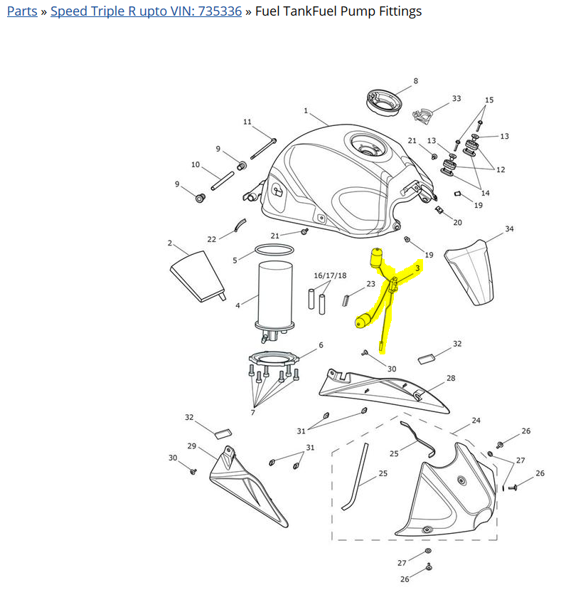

    Reading your post a third time, you do specify the issue is mostly with fuel indicators being lost, fuel remaining in the tank, miles to empty etc.
    Could it be just a faulty fuel sensor (or wire connection to the sensor) which is indicating it being empty (even when not) it cuts the ignition to avoid fuel starvation :confused: ?

    Gonna lift the tank tomorrow and check the fuel sensor and the wiring relay and fuse despite dealer saying this couldn't be the problem it seems to be a common problem looking around other forums
