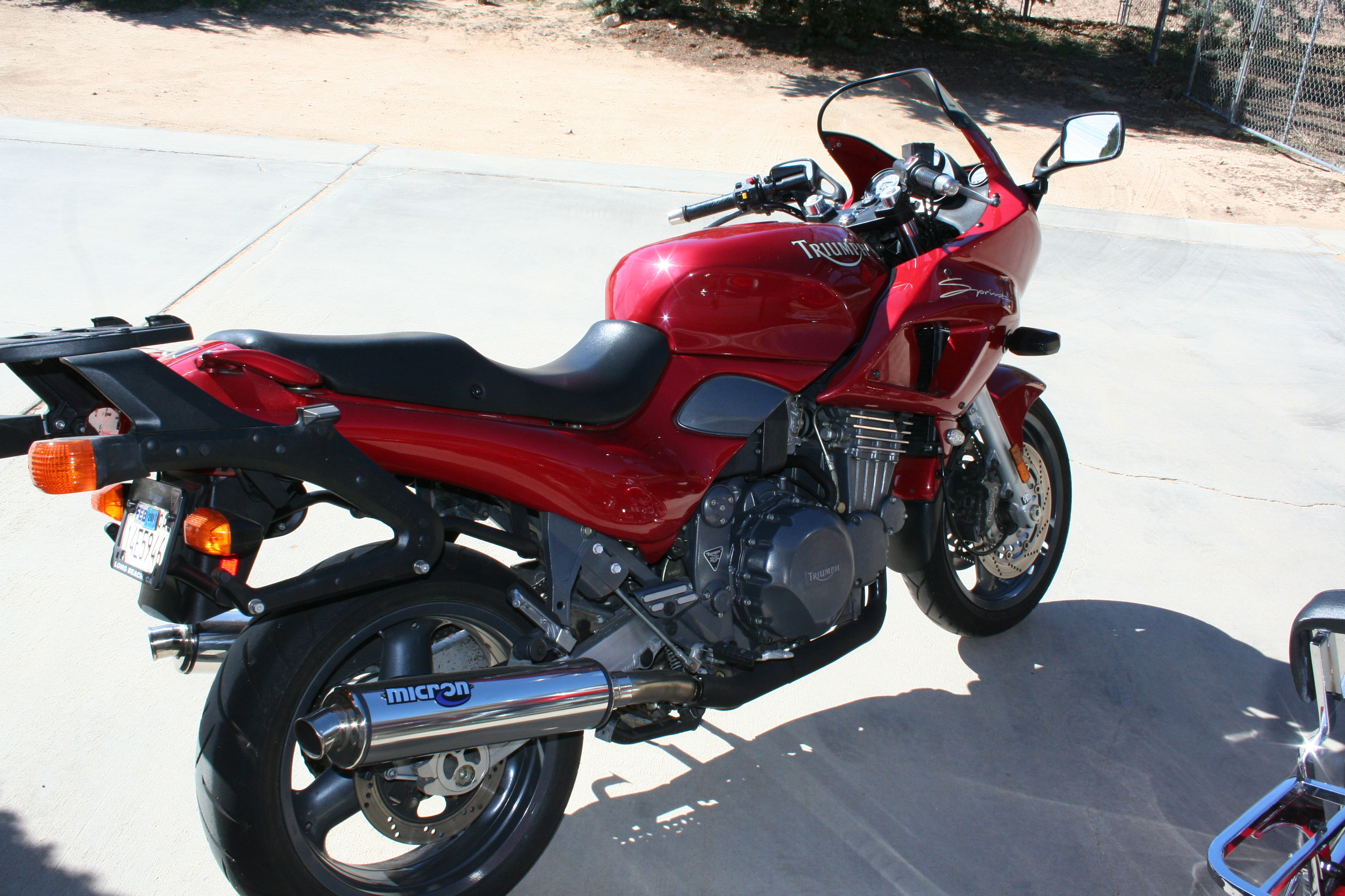

    Welcome: I have a 95' Sprint that I have played around with for 18 years. Between myself and the previous [original] owner it has been through a few chassis changes. It's forks were actually RAISED a tiny bit. Mine has the 17" wheels and runs a 180 rear tire and has RaceTech front springs. I am using Super III front calipers. I find if I want to take it "out to play" I only want to use about 1/2 fuel load. That helps keep the center of gravity a bit lower. Mine has some well sorted out Mikuni's, a set of Micron off road cans, some air box mods, etc. These are kind of a long beast for playing in the twisties. I have another bike I like better for that use, but I have run the Sprint up in the Southern California mountains a few times. ...J.D.

    Lovely immaculate looking bike J.D. :cool:
