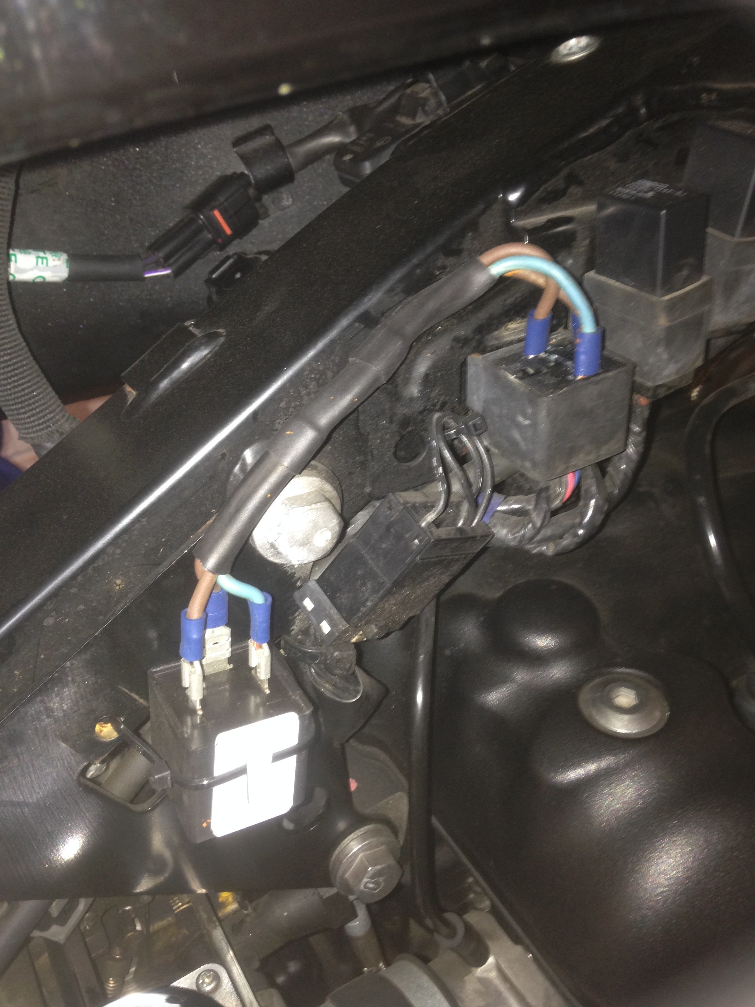

  13. dilligaf
    Sorry I took so long to post this but only got round to lifting the tank today I mounted the adjustable relay on the frame and made the wiring up then swapped the polarity over
    The blue and brown wires
  14. Sprinter
    5,993
    (If you dont ask) How did you swap the polarity?
  15. dilligaf
    If you look at the relay at bottom...where the brown wire is...this contact would plug into the relay socket where the blue wire is....and the blue one would go where the brown one is....this according to someone on YouTube....an Australian doing it to his car reverses the polarity....I'm not sure if reversing the polarity is an accurate description of what is happening but it works :cool:
