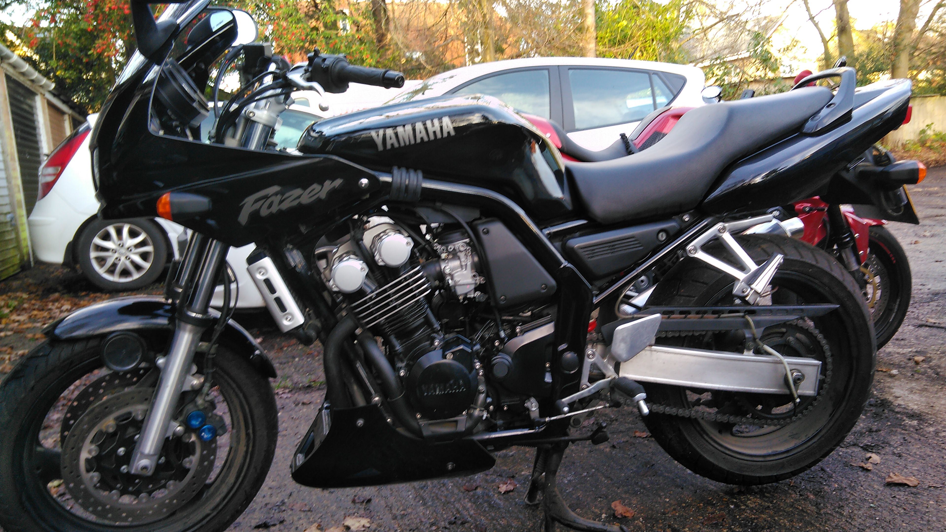

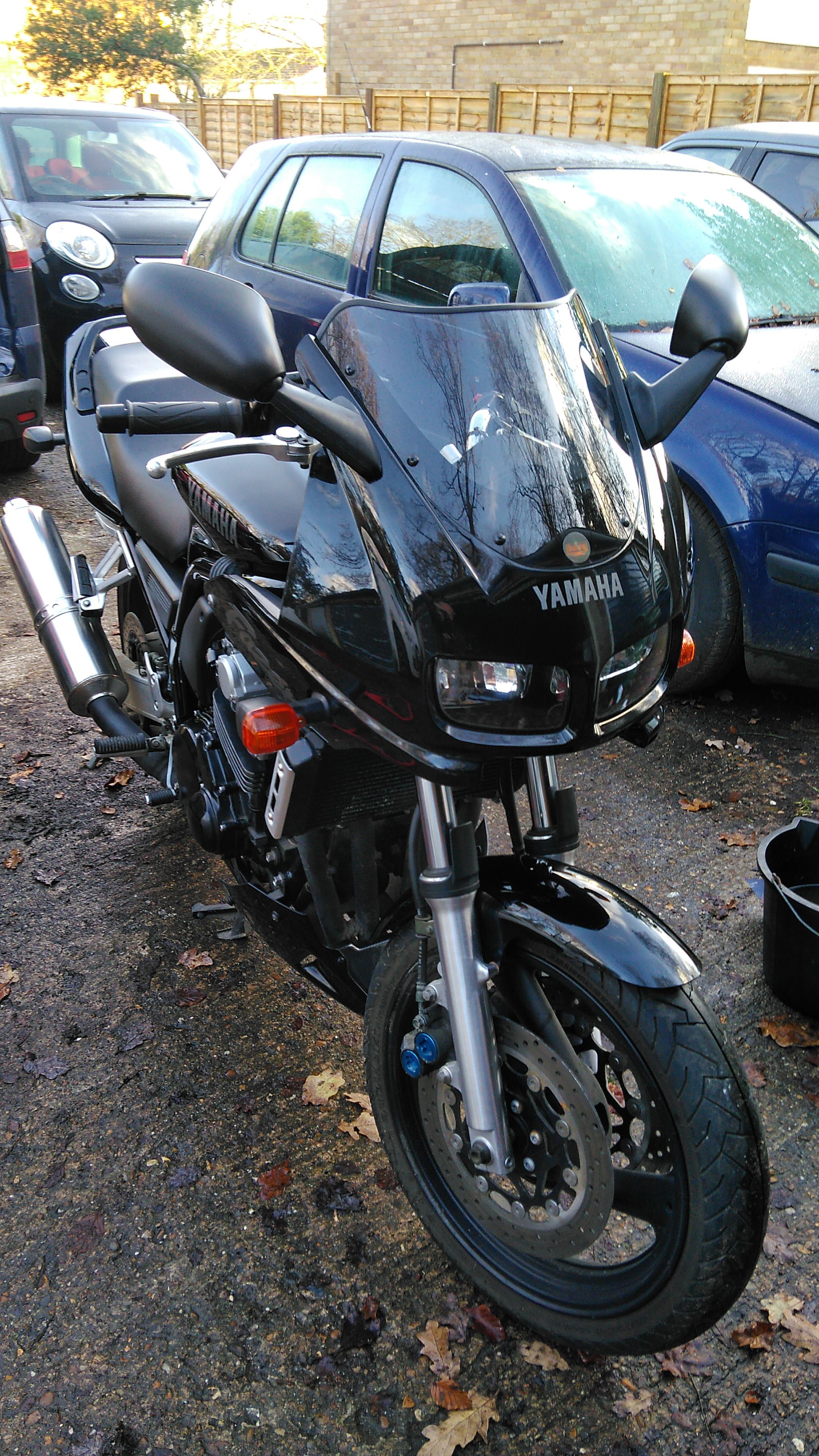

A mate has picked up a Yamaha FZS600 with 2,000 miles and has been in storage for 15 years or so. Last fired up two years ago I am helping him get it road ready Regarding oil, the normal is 10/40 semi I believe. I plan on draining the current stuff without firing it up, replacing it with inexpensive oil for a week and running a few heat cycles through it and then replace with decent quality oil. My question is can I use a lighter weight cheap oil to help dilute any sludgy nasty stuff, clear all the oil channels etc If so what weight to use! Am I doing the right thing here, I guess an oil filter would be needed too New battery and tyres on order Coolant, spark plugs and brake oil will be replaced Anything else?

Opened up the tank this morning, I can only best describe the contents as rusty sludge with the viscosity of watery syrup. And by Jeezus was it stinky Opened the drain ports on the carburettors and nothing came out, not a dribble So that is our focus now, fuel tank deep clean, fuel filters, carburettors clean out Then oil, oil filter and brake caliper system flush n rebuild
Fork seals, master cylinders rebuild. also and has anyone mentioned spraying some oil in the cylinders.
