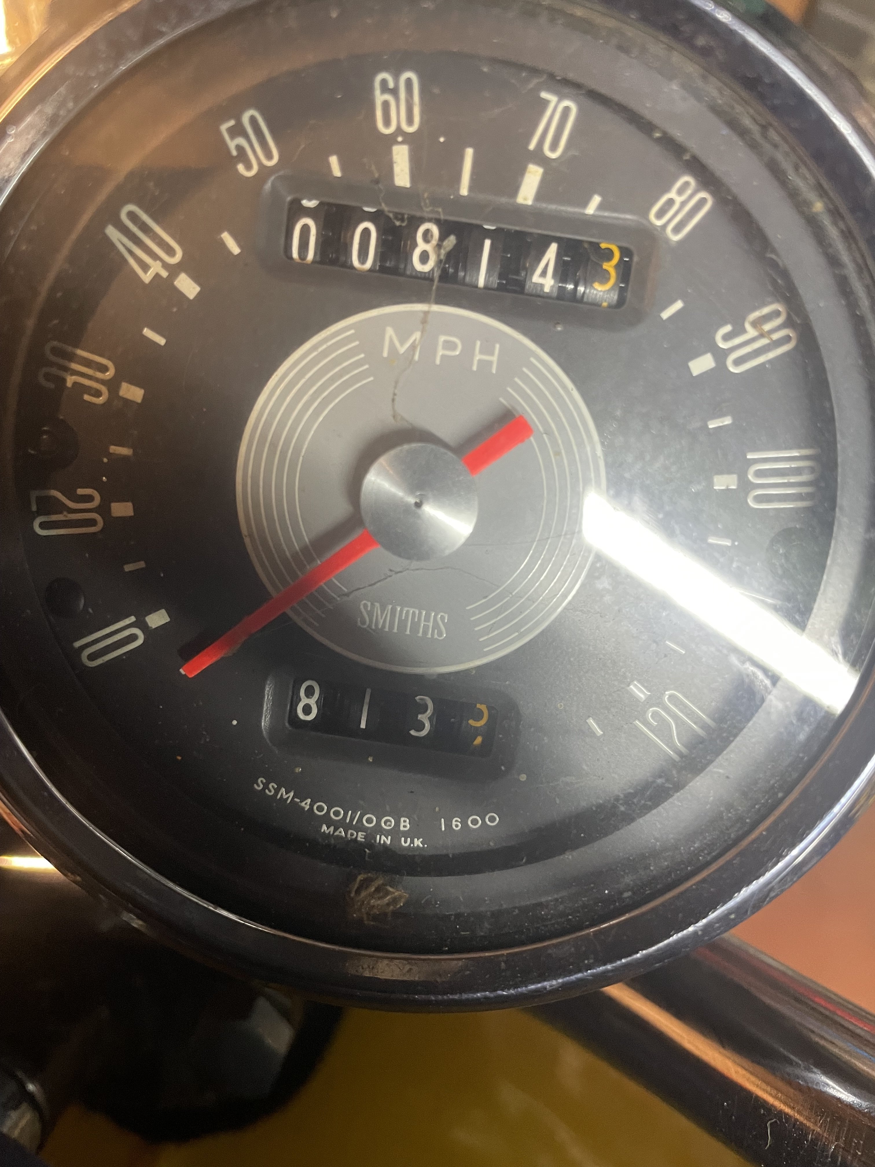

    I have aquired an old bike which is apparently a 1967 6T ex police machine the engine is from a t120 dated by engine number to 1970 ,not a problem as matching numbers not a problem as i remember the days when no one cared.However the speedometer drive is from the gearbox? still not a problem but it needs a new drive cable the present one is approx 4 feet long not as long as the wheel drive ones so does anyone have advice please

    Police bikes used the chronometric speedo so would have probably had the gearbox drive casing from 63 to 65 and when the engine was changed in your bike they used the early outer gearbox casing on the 70 engine. Do you have a chronometric or magnetic speedo ???

    Thanks for your input Darkman not sure which i will try to post photo but im not great on this tech IMG_2624.jpeg
  8. darkman
    7,656
    You have a magnetic speedo, not correct for a police bike but correct for a 67 bike. There are two cables listed for your bike, one is part number 60-0542 that is 44 inches long and 60-0543 that is 40 and a half inches long.
