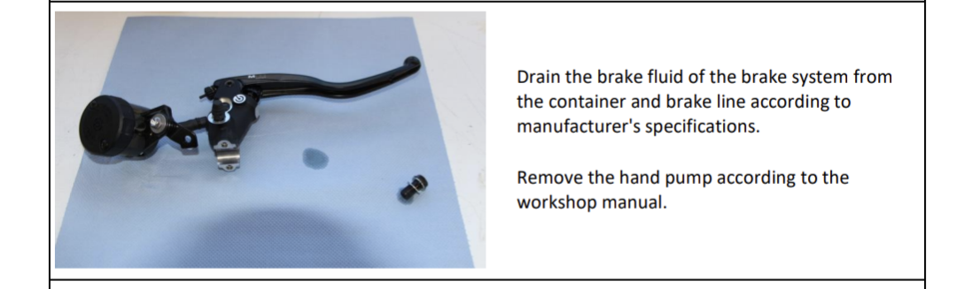

    I've bought some ABM clip ons for the RR. Hopefully help with the issues around comfort.
    Any how. Reading the instructions.
    It mentions a few things.

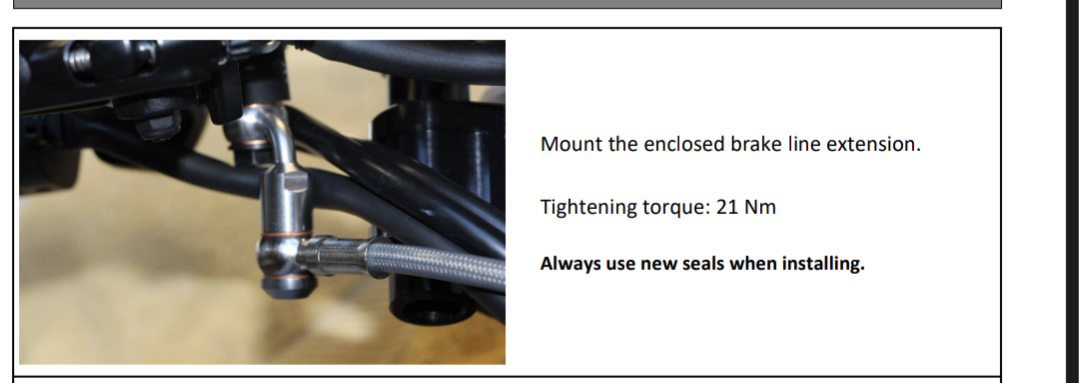

    1. The workshop manual for bleeding brakes. I assume bleeding the brakes on the RR isn't particular special. Or do I need 'the workshop manual?'
    2. I need new brake seals. Anyone got a link to what I need?

    Brake seals, I assume they mean the copper washers you use on the banjo bolts. On my Speed Triple, to bleed the brake system you need to bleed the ABS pump which requires s/w similar to Dealer Tool.

    Yeah I found out I just needed some crush washers. Good old amazon to the rescue.

    Hi BT81, what members are saying re the DealerTool (or alternative) for bleeding the brakes, and requires the pump valves to be open, this allows all old fluid to be removed and new fluid circulated within the pump, otherwise there is no point bleeding the brakes as old fluid will remain in the pump and over time has the potential for the pump to fail for obvious reasons. I have attached the DealerTool instructions that explain the ABS pump purge.
