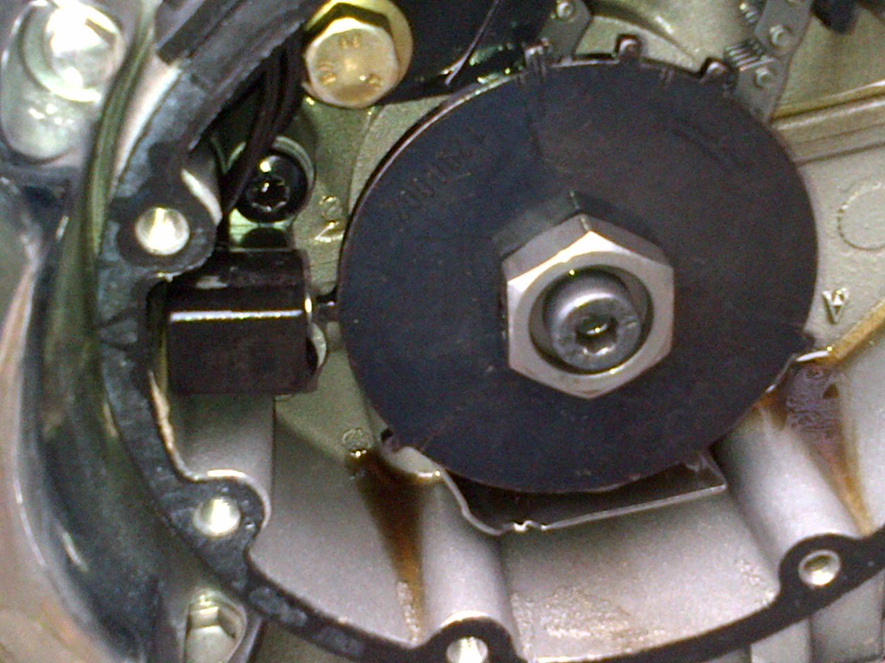

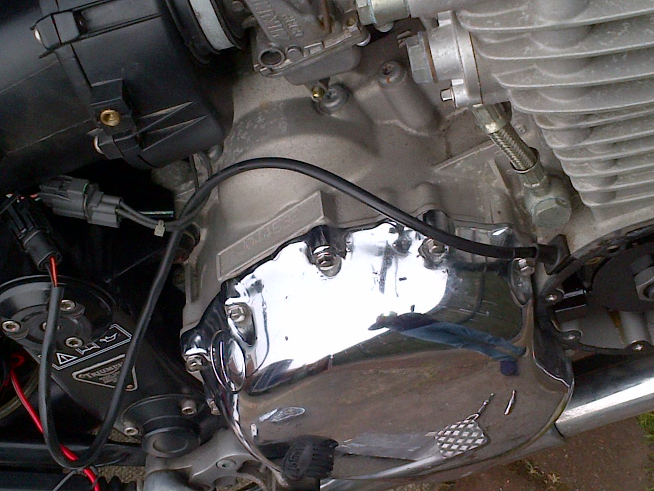

    Hi. Big Day fingers crossed???. The ignition sensor and new gasket arrived yesterday afternoon and I set about replacing it this morning. Removed RH crankcase cover and the old sensor was clearly visible. The wiring came from the sensor and through the crankcase via a grommet to a connector below the carbs. The wires were quite easily accessible after removing the air filter covers. Two bolts held the sensor in place and it was easily removed. The new sensor was a direct replacement and the socket was a perfect match. I bought a set of metric feeler gauges, as the air gap between the sensor and timing rotor needs to be between 0.6 and 0.8mm. Replaced the crankcase cover with new gasket and fired her up. She started first time and ran like a dream. Replaced the air filter covers, got kitted up and went for a ride. After staying close buy for a few anxious miles without any probs, I realised that the bike was fixed. Rode out for a couple of hours weather great Brilliant!!!!
    Thank you for all of the advice> I would not have had a clue without your help.

    Nice one, great stuff, glad you put up photos.

    Yes they are torx bolts holding the sensor in place and yep, looking forward to a hopefully problem free summer. Cheers
