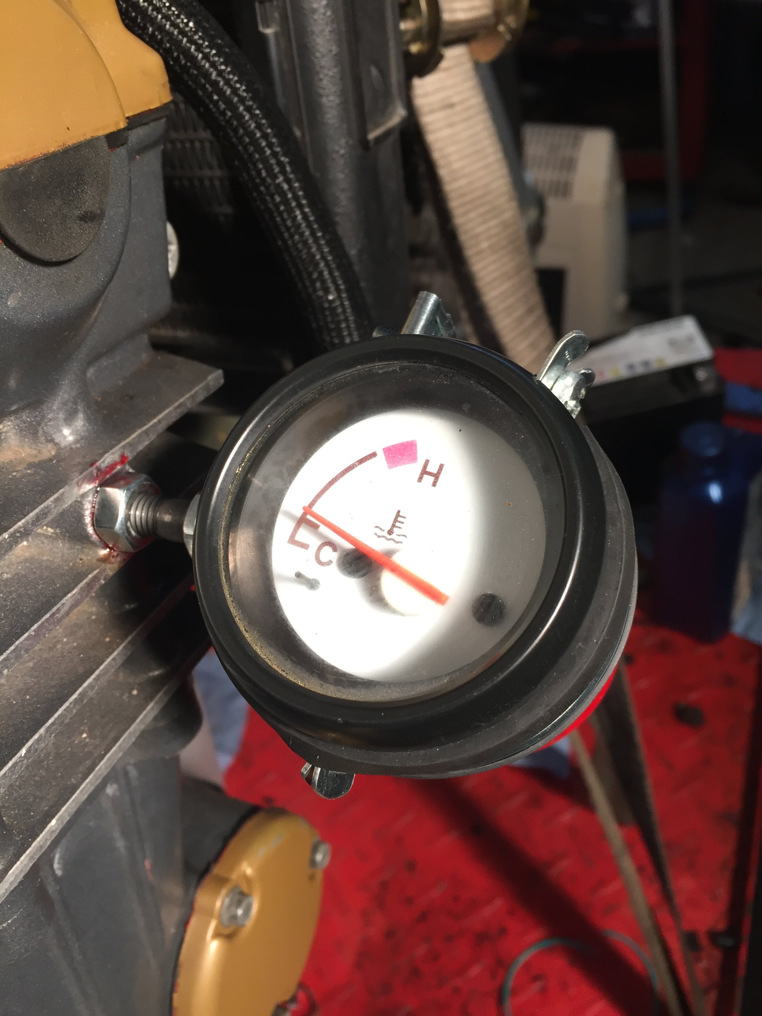

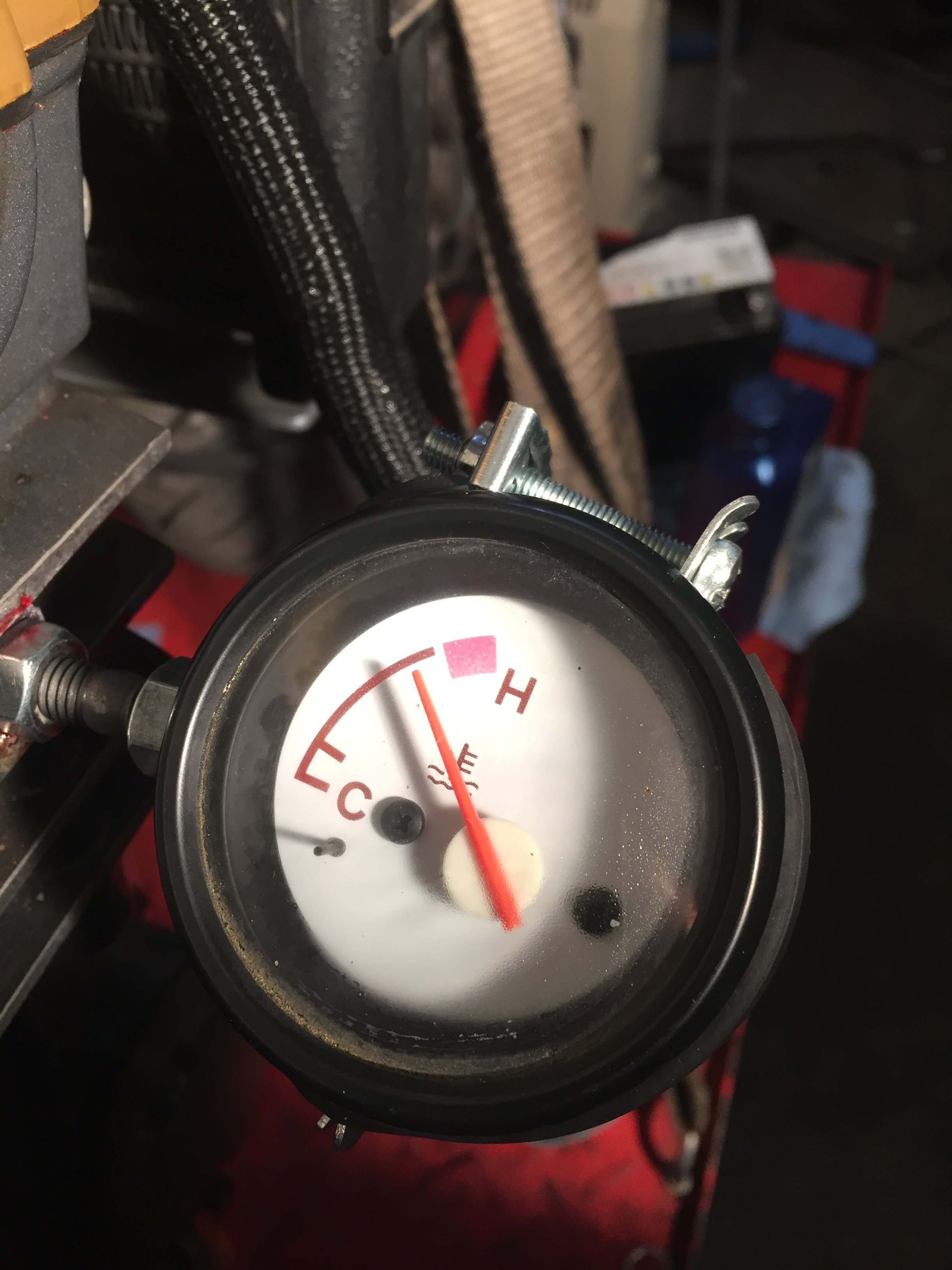

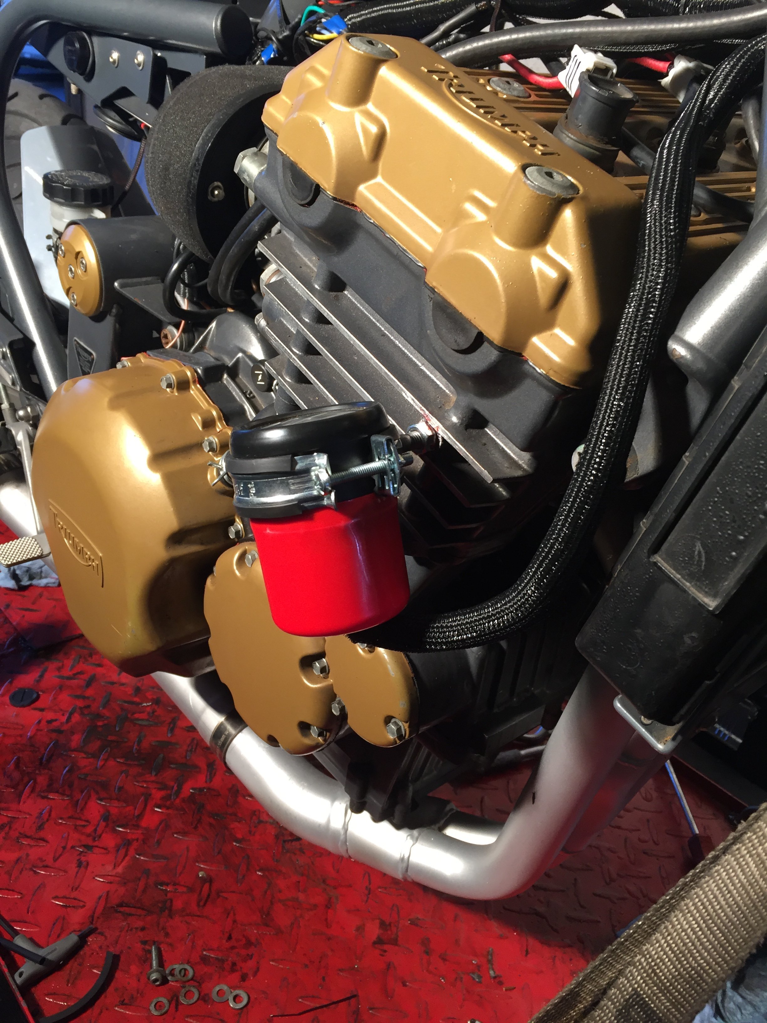

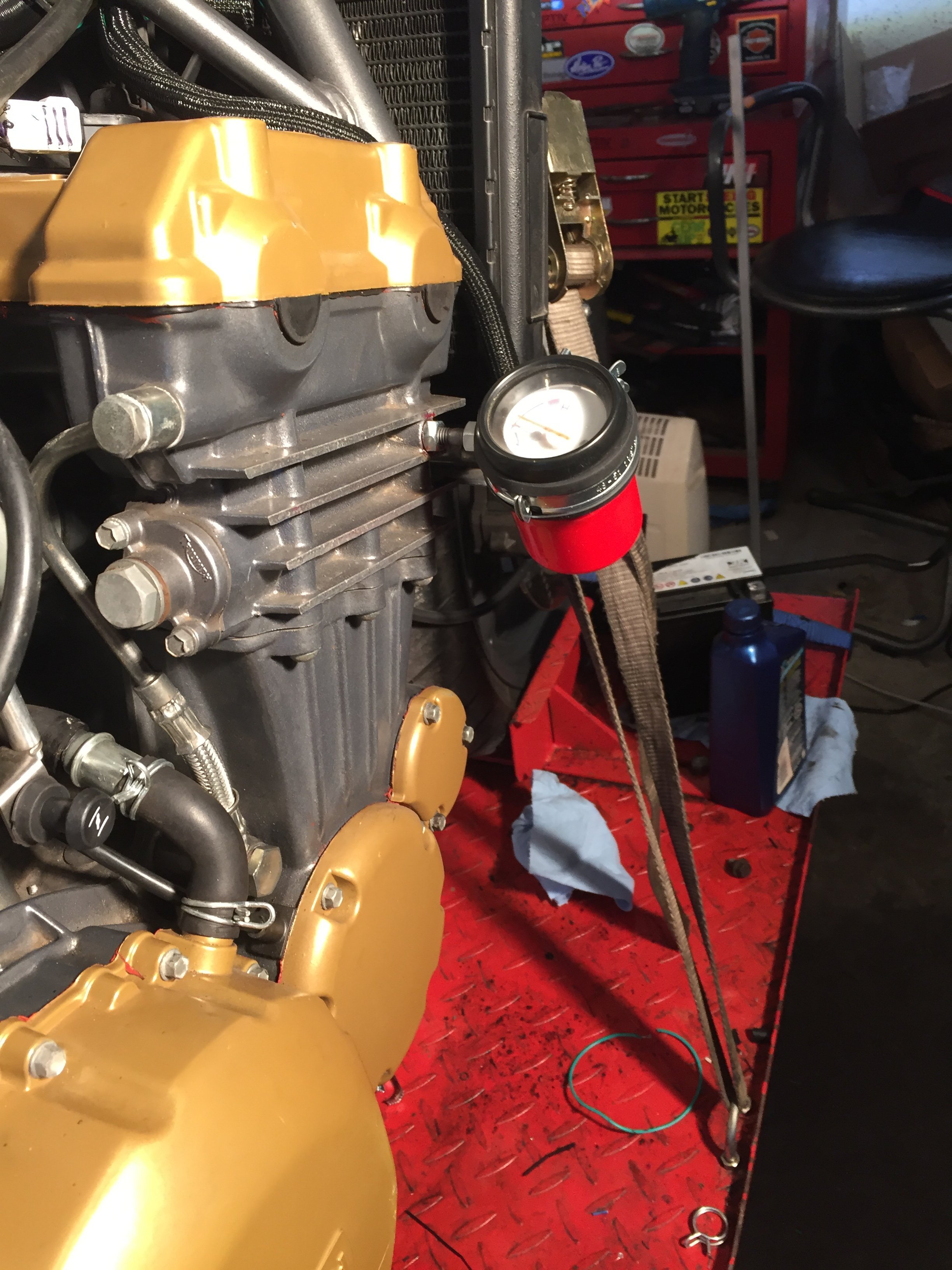

    Final verdict:
    I replaced the 24 year old radiator cap , to go along with the new hoses, temp sensor, fan sensor, fluid flush and refill with waterless coolant (thank you Edd Chyna fir the recommendation). I then ran a heat cycle and bled/refilled the system. and according to my infra red thermometer the fan cycled on at 102 celsius. My CRK kit idiot light was shining bright from way before the fan kicked on.
    I wired up my OEM temperature gauge and made a mount using a new exhaust stud and a electrical ring fitting sourced at the DIY store. Capped the instrument with a red top to a chain lube can, and...great looking temp gauge.
    From cold; it took 15 minutes for the bike to get hot enough to cycle the fan. The temp gauge never went into the danger although it was close up there. It dropped when the fan cycled and it appeared to be operating within specs. I no longer fear the blowing of said head gaskets and I feel much better watching a gauge rise rather than waiting for the panic of a warning light.
