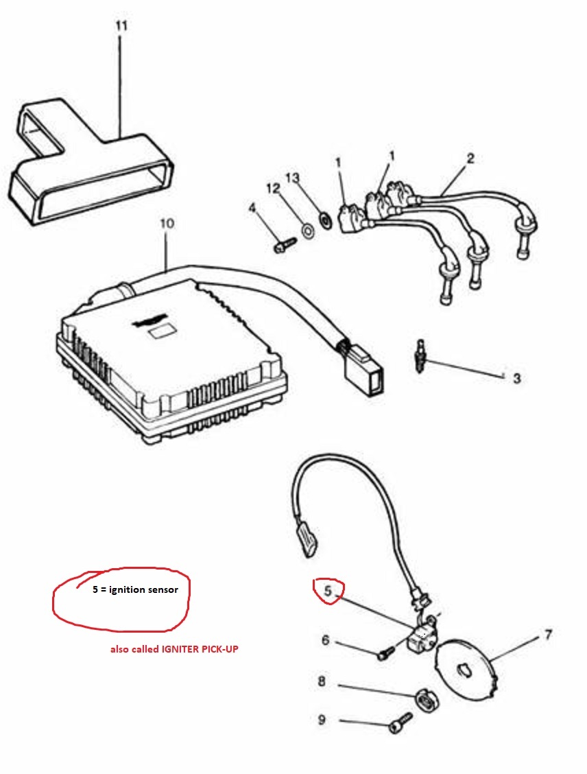

    looking at the official Triumph manual Adventurer wiring circuit diagram, 16.52, 16.53 , number 27 is labeled "IGNITER PICK-UP", which to me looks like the IGNITION SENSOR. I am just trying to make sure of the nomenclature of suspect part prior to ordering. Replacing the Ignition Coil won't help me if the problem is the Ignition sensor. thanks for advice

    thanks for advice.
    I am going to try and replace this ignition sensor myself.
    ...If I don't tear or booger up the gasket...
    I should be able to do it without any special tools.
