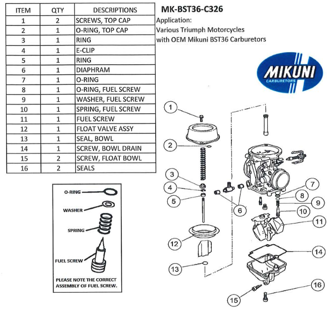

    The shop that's working on my bike said that there are some plastic components inside the carburetors that have dried out while in storage and deteriorated to the point where they have split. They are needed for the proper function of the carburetors. They can get the bike started but it won't stay running. Back to my original ask. Does anyone have a line on possible replacements or which aftermarket parts I could use?

  8. Stuart Budd
    Stuart Budd New Member
    Sep 11, 2020
    5
    Gloucestershire
    BST36s were used on lots of Jap stuff too … there is a plentiful supply of spare parts / rebuild kits and it's not a difficult job.
  9. Wire-Wheels
    Wire-Wheels Elite Member
    Apr 26, 2019
    2,515
    California - USA
    Just plug in Mikuni BST36 in to your search engine. You should have no problem. I have a set on one of my 900's. I haven't been in to them in a few.years now. Your mechanic should know how to find this stuff. ...J.D.
  10. PFEDave
    PFEDave New Member
    Aug 26, 2020
    Rockford IL
    What I need are the float assemblies. What seems to be strange is that these are plastic parts instead of brass or other metal and I am having a hard time finding these. Part #11 in the above diagram. Actual part number is 1240061-T0301 and seems to be out of stock everywhere I look.
