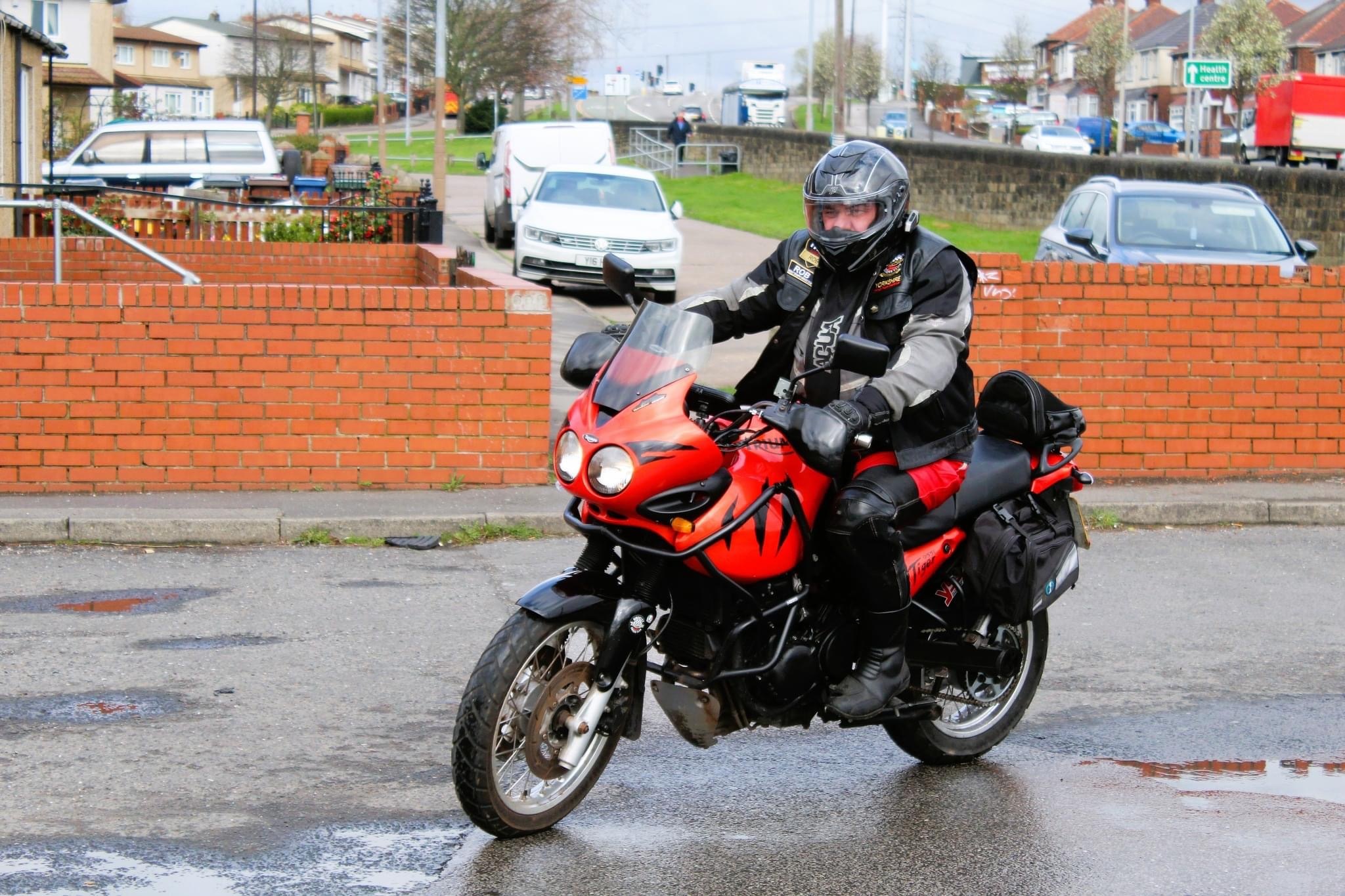

    Hi all,
    An update. The rear shock was not just knackered, but totally broken!
    I managed to get the bike on the centre stand on top of a 2 inch thick paving slab which got the rear wheel off the ground. This revealed that the top of the shock was broken.
    Over Christmas I stripped it all off, which was an utter nightmare, ending up taking the swingarm out and had the devils own job of getting the old shock off to fit a new YSS unit, with a heavier spring. While there I did the swing arm bearings, which was really easy in comparison.
    I’ve since got it all back together and what a difference!
    We’ve done a couple of hundred miles since I got it all finished, including re doing the seats with new covers on runs with HTOC. I’m a bit in love with the old girl, it’s a great old bike!
