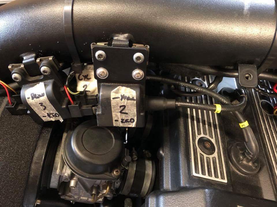

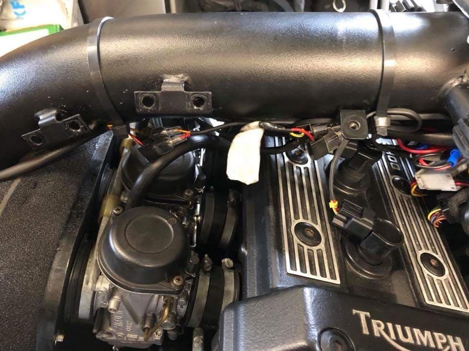

    I make up stick coil conversion kits fot t3 models. Plug and play. Sub looms are colour coded and numbered wires. Pm me if you are interested. Only 12v (LT) into the plug cap/coil, not 10k's volts.[​IMG] [​IMG]

    Ii did a lot of research to find the exact coils that match resistance perfectly, it is non of those. Remember use the wrong ones and it can destroy the igniter.
