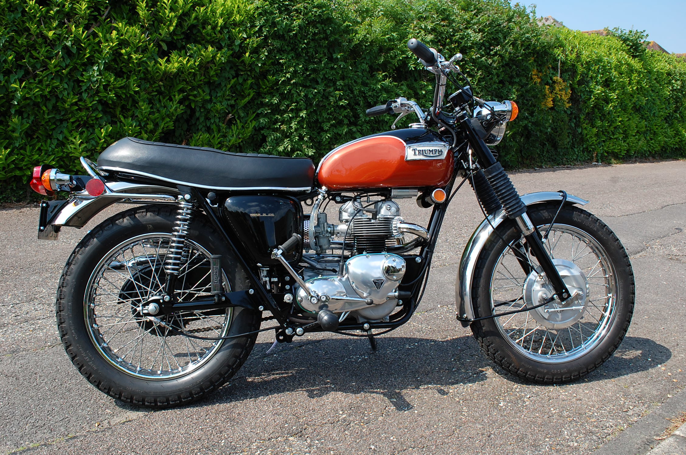

  13. darkman
    7,568
    70 T100C is a fantastic bike and quite rare as well as becoming collectable now, i built one for my partner this year a 71 and parts are more readily available if you want to keep it standard.

    That is one beautiful bike you built for your partner. Out of curiosity if you could have one or the other which would you go for? mid 60s 650 or 70s 500? I have ridden many bikes and never felt under gunned with the 500. I Had thought if I wanted to build a vintage adventure bike using the T100C as the base for the bike just seemed right. But again I had a friend who had a Rickman with a Trophy motor that was a great bike as well. choices choice..so many choices. :)

  18. darkman
    7,568
