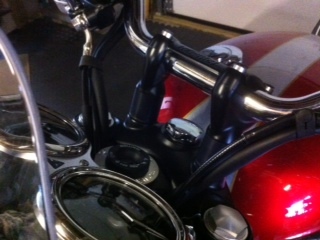

    image.jpeg I have fitted 30mm handlebar risers, moves the bars back a little as well. Got a short 30 mile road test today and found the riding position very comfortable and together with the mirrors at a higher position giving a great rear view I am well pleased with this modification.

    I have a 2017 T120, no need to reroute cables, no tightness.

    Hi sixties - After a 75-mile blast on my '16 T120 this morning, I think my shoulders and wrists would benefit from some risers, so if you don't mind my asking where did you get them from and how much ?

  4. SixtiesBiker
    SixtiesBiker Well-Known Member
    Feb 13, 2018
    61
    Northern Ireland
    Hi New member, welcome. I got the risers from www.classicbike-raisch.de
    German as you can see, very nice to deal with, I emailed first to sort out correct riser, then ordered it using PayPal, total cost was Euro 60.75, well packed, east fit, good quality metal and new Allen key bolt. For my bike there was no need to lengthen cables, they fitted ok, was out today for a ride, it helped my shoulder but not eradicate the pain completely, a slight modification of my upper body position has also helped. Hope this assists you. pleasant riding, Bob.

    Thank you for this. The T100 is comfortable for my 5'8 but touring screen being fitted this week, so this is helpful for me to sit up and beg whilst touring. I'll email them.

    I recently put such risers on my 2012 T-100 and it was a good decision. Got them from NewBonneville.com LLC in Murphy, TX. $55 including shipping. Much more comfortable at my 5'8".

    Just to let you all know, I heard back from Rainer at classicbike-raisch.de very quickly; it seems none of the risers for the T100 advertised on their site are designed to fit the newer water-cooled models.

    Strange, I got risers for my 2017 T120 and they fit great.
