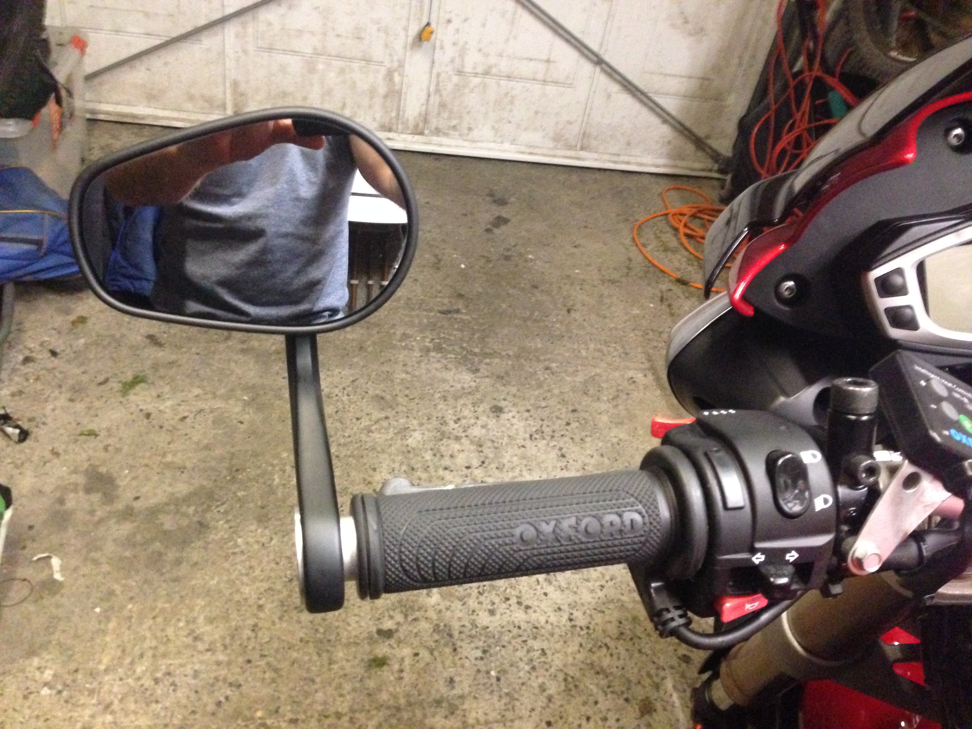

    I've managed to fit the 2016 OE bar end mirrors to my 2014 ST - Quality, usable, genuine triumph mirrors for half the price of the triumph accessory brand items that look nice but I found way too small to actually work.
    The mirrors are approx £35 each + a couple of aid for the pinch bolt - inc vat about £80 odd.
    My buddy who's an meticulous engineer made up top hat bar ends that are required for the mirror clamps to fit to - stunning over-engineered quality, way better than standard.
    I'll post a couple of photos and if anyone is interested he'll do a pair for £40.

  11. FackinEL
