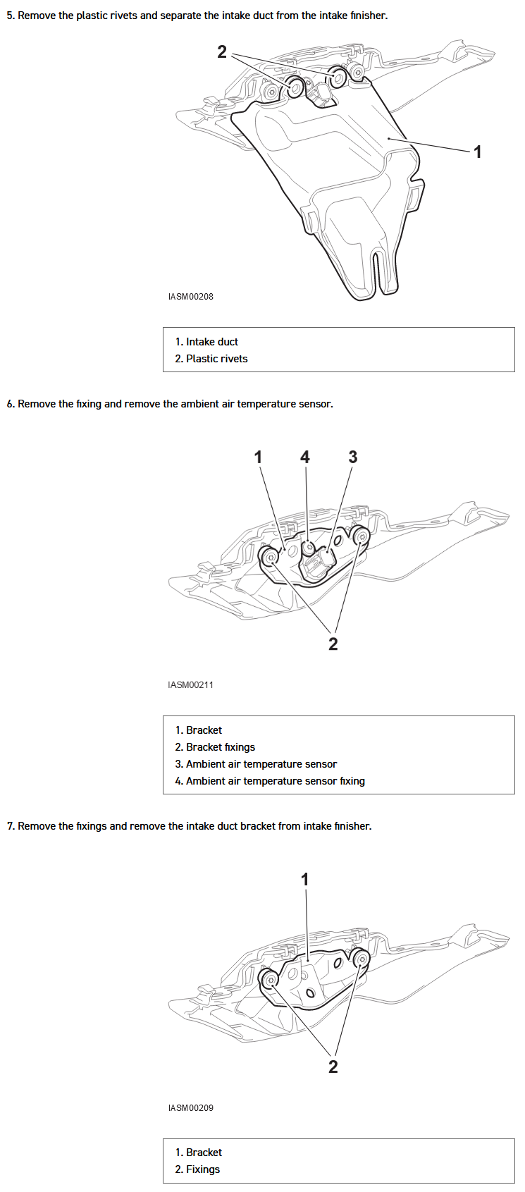

    Couple related pages from 2024 service manual.
