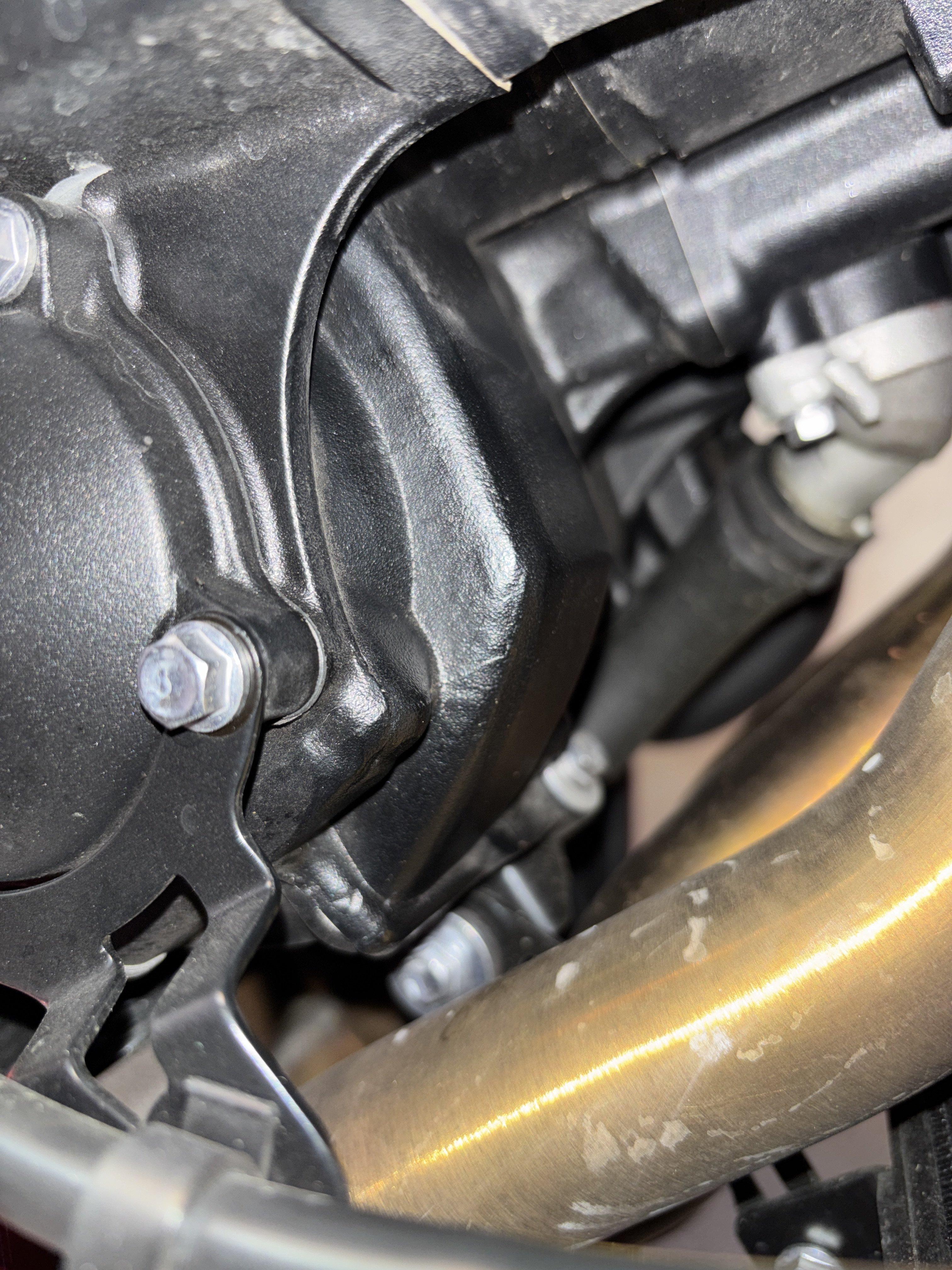

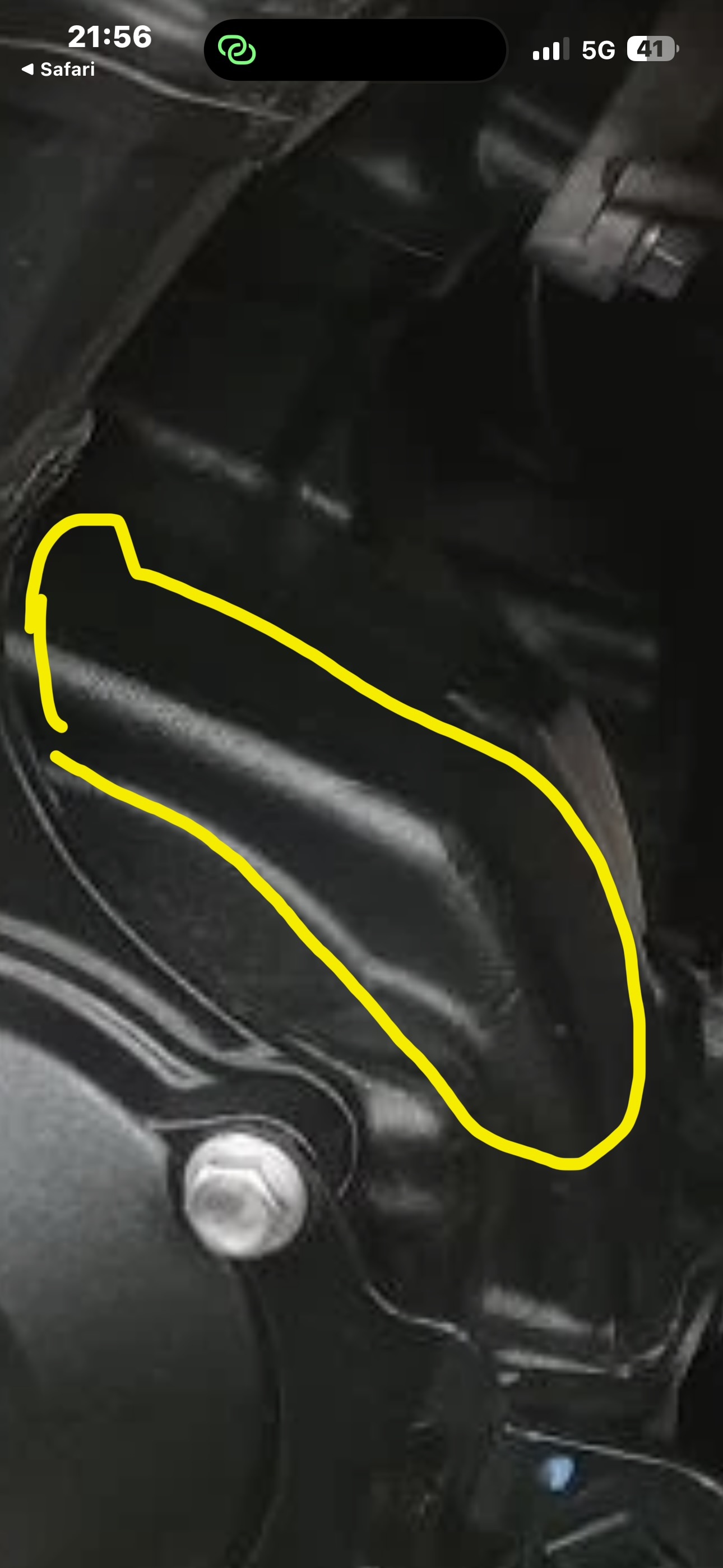

    Evening fellow striple owners, just a quick one here, I’ve had an hour in the garage this evening and uncovered the bike for a quick ogle/dust off and noticed a very small iffy area of engine case on the right hand side of the bike, not a bolt on cover the actual engine block itself, looks ropey maybe unfinished before the painting process etc making the surface look almost like the paint could be blistering slightly, has anyone noticed any areas like this on their triples, I’ve attached a pic for location reference but couldn’t take a very good pic of my bike with my phone tonight but I will upload an accurate pic tomorrow, cheers guys/gals

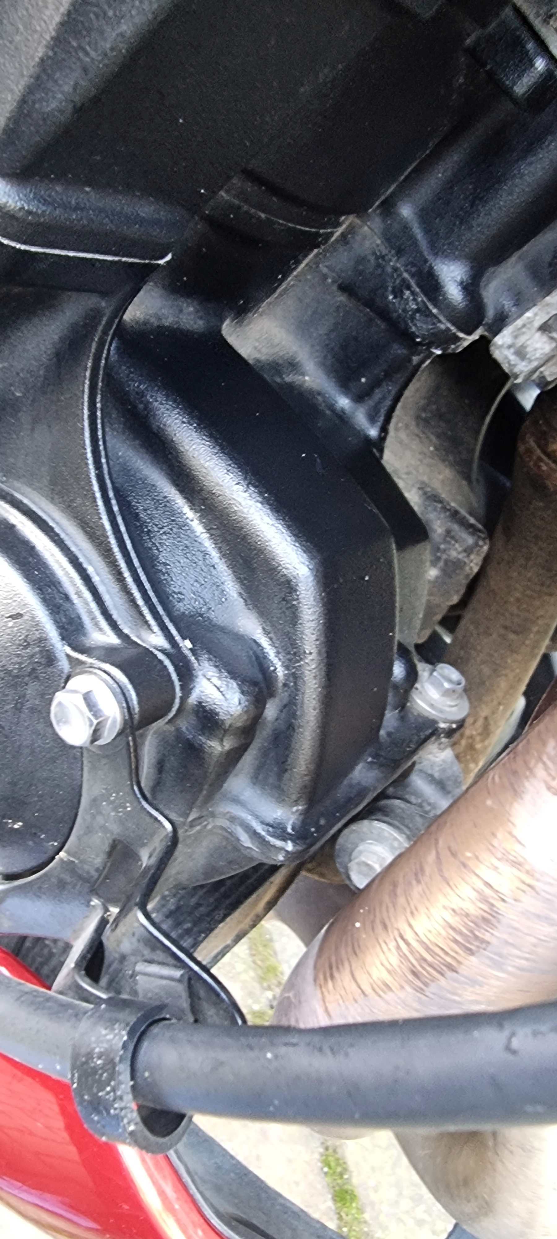

    Your picture isn't very clear, maybe you could post a better close in one?

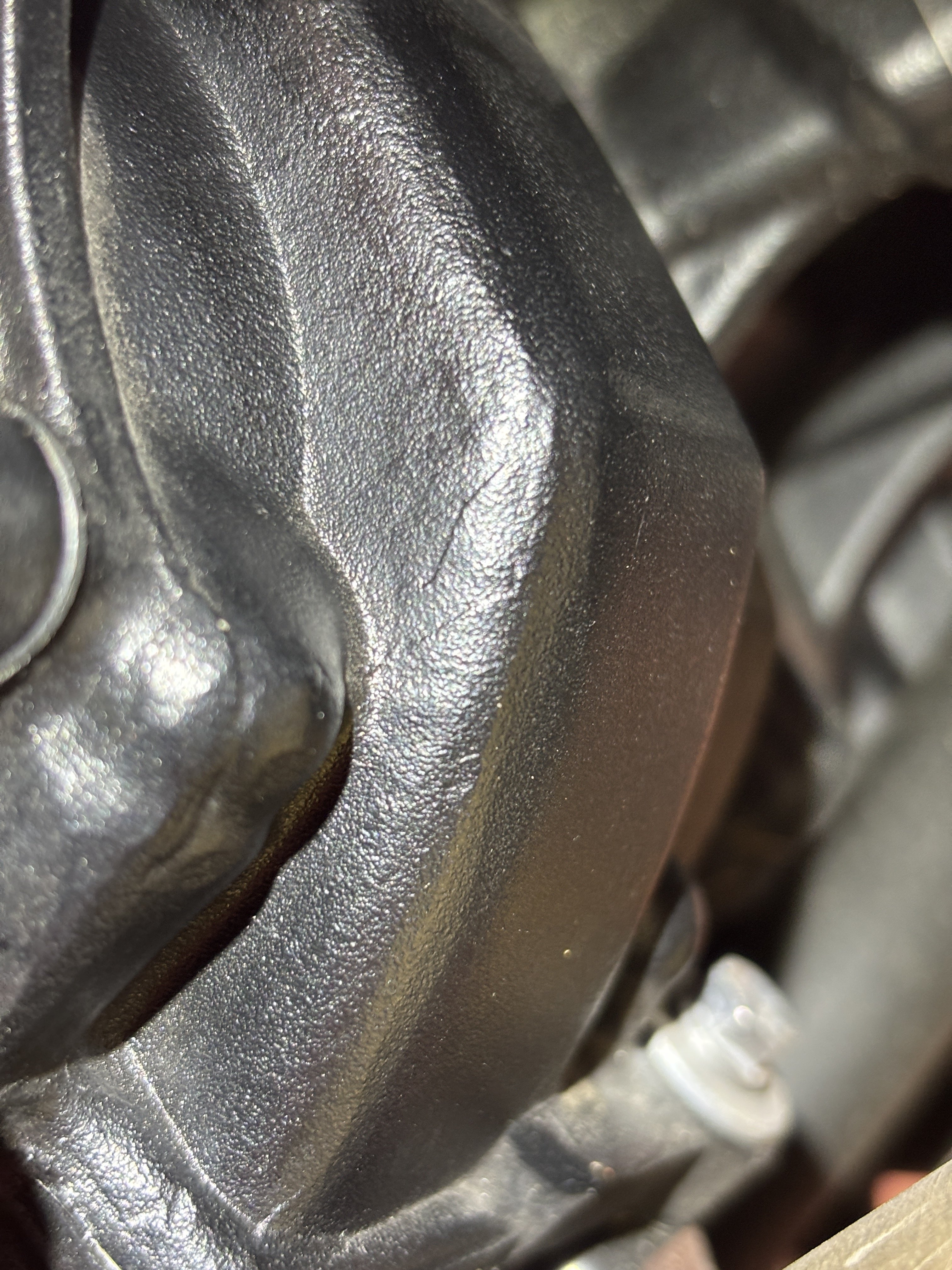

    If its like a blister under the coating then it would be down to surface preparation. I spoke with a very experienced powder coater friend of mine and he said quite often it's either poor surface prep I.e. oxide removal via vapor blasting, or it's time stored between preparation and final coating.
    My 900 st has a few blisters under the coating with no chips or external reason obvious for it to happen, hence my discussion with him about it.

    Eldon calls it right, there are a lot of owners complaining about the same issue. The same thing happened to my machine, thankfully, it was only the sump, it was easy to take off, and I completely stripped it down to the alloy, then sprayed it with high-temperature paint (primer and top coat) that matches the original finish. I have mentioned before that the QC appears very poor at present, it was not the same when all the machines were made at Hinckley. I would take it back to the dealer to look at it if it's still in warranty, at least then you have it recorded, should it get any worse.
