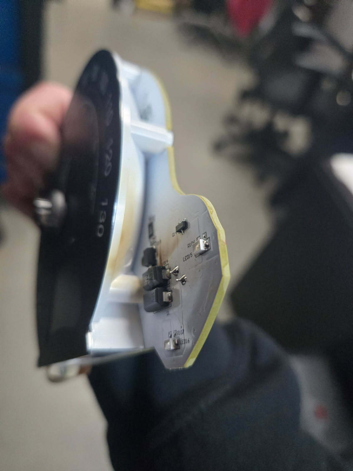

    Updates on my case:
    Dealer tech raised ticket with Triumph USA, who is contacting Triumph UK tech, apparently no one ever heard this before. So all I am hearing back from them is 'we tried this and that .. nothing solid on root cause of problem' yet.
    Dealer noticed burn marks on the instrument cluster board and suspect something foul there, Triumph wants to try replacing it and see if that fixes the issue. See pics for burn marks. I don't understand how the instrument cluster even burns out with the minimal amt of current it draws in that loop of the ignition circuit, majority of the current is sent to the solenoid/starter part of the circuit.
    Beyond frustrated.
