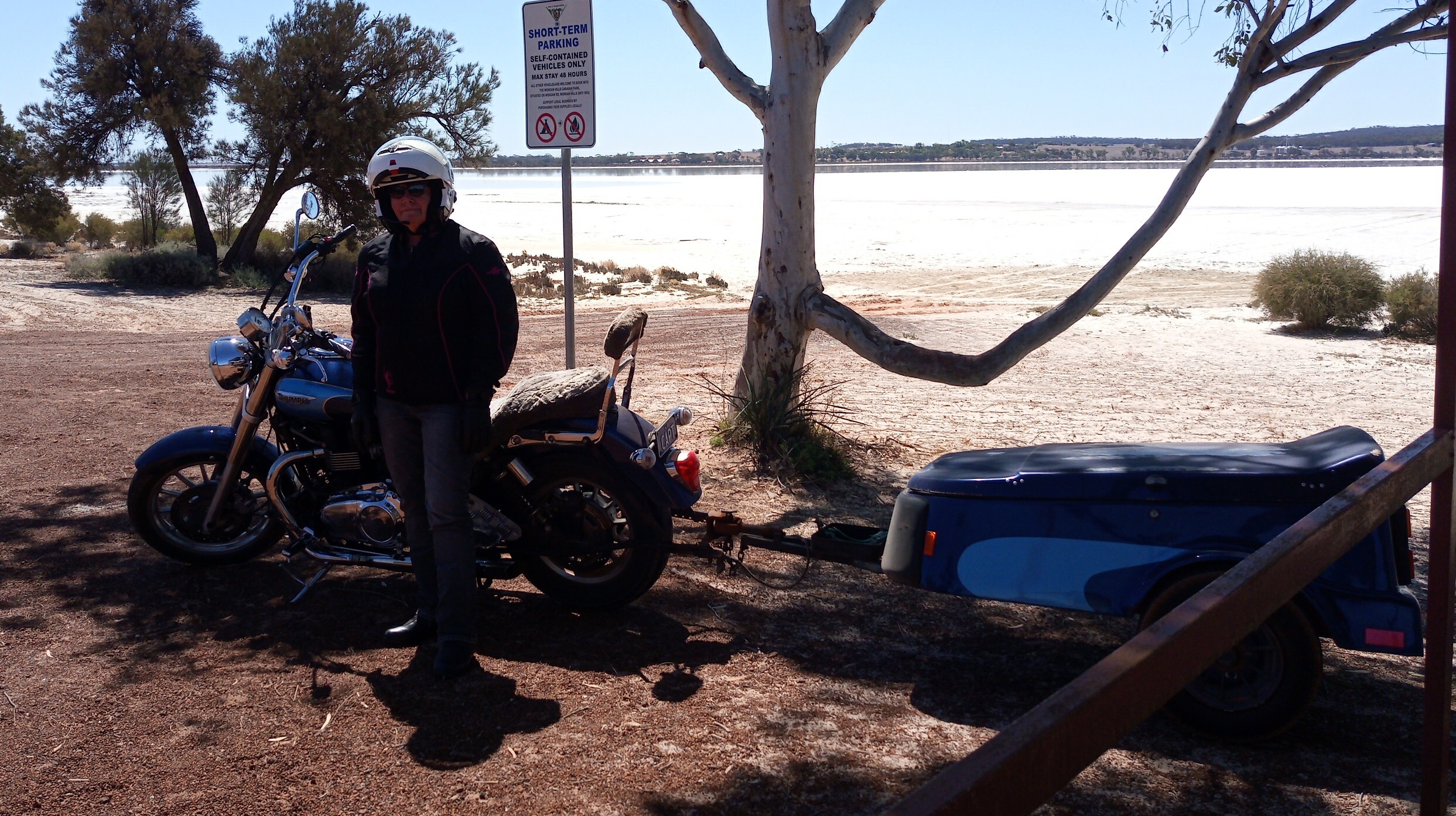

    I went this way !
    After having leather saddle bags , which cost me a lot in wind drag , lost as much as 1•5 km/lt in fuel economy.
    Key benefits.
    1:- load can be locked away.
    2:- Can carry in excess of 100 kg !
    3:- articles up to 1•3 m long , 850 mm across the body internally , as it's 900 mm wide .
    4:- wind drag is minimal ! Getting 20 km lt solo , 18•5 + two up and a full load in trailer ...!
    5:- Bike handling isn't badly affected .
    6:- You can disconnect it in Seconds and you are away ! Back to freedom of no lowered towing restrictions on speeds !
    I did 11,000 km round trip to Bundaberg in Qld 12 yrs or so back with this trailer and bike !
    Did 11,500 km to Darwin 3 yrs ago , towing a heavier weight Camper , two berth pop up canvas !
    The panniers are very restricted in capacity and change/affect the handling way more than you'd realise , towing a trailer really Surprised me on how easy it is ... !
    cheers capt

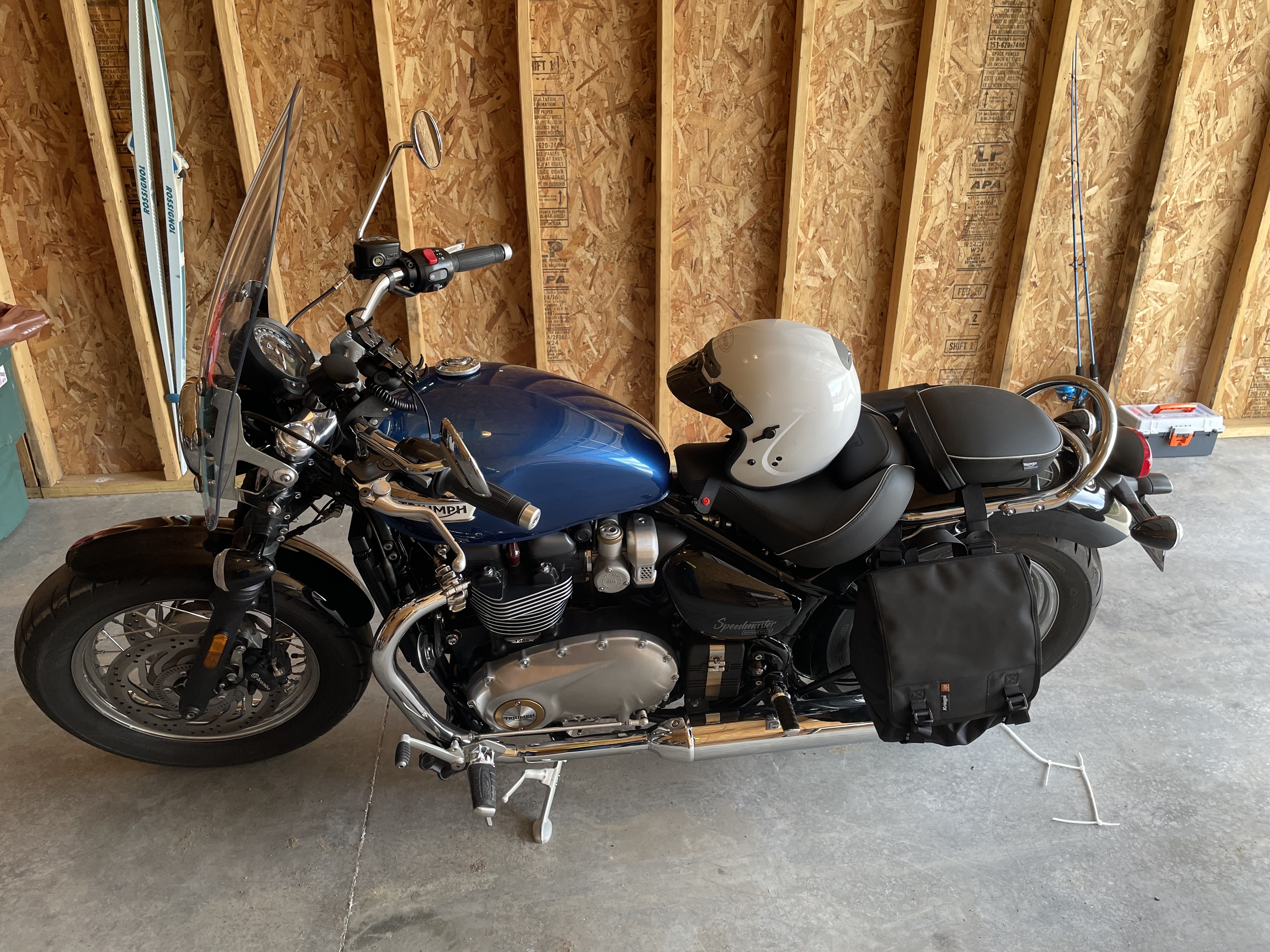

    I just installed the Motone pannier supports on my ‘20 Speedmaster and they were ridiculously difficult to install. I’m pretty pissed off about the poor design.
    The bags that I hung are Kriega 28 saddlebags. They seem fine, but I’m not entirely satisfied on how these Kriega bags hang on the bike. I could not find any reasonably priced removable bags, so I just went with the Kriega’s.
    Unfortunately, the Triumph bags didn’t impress me and there aren’t many choices here in the colonies.

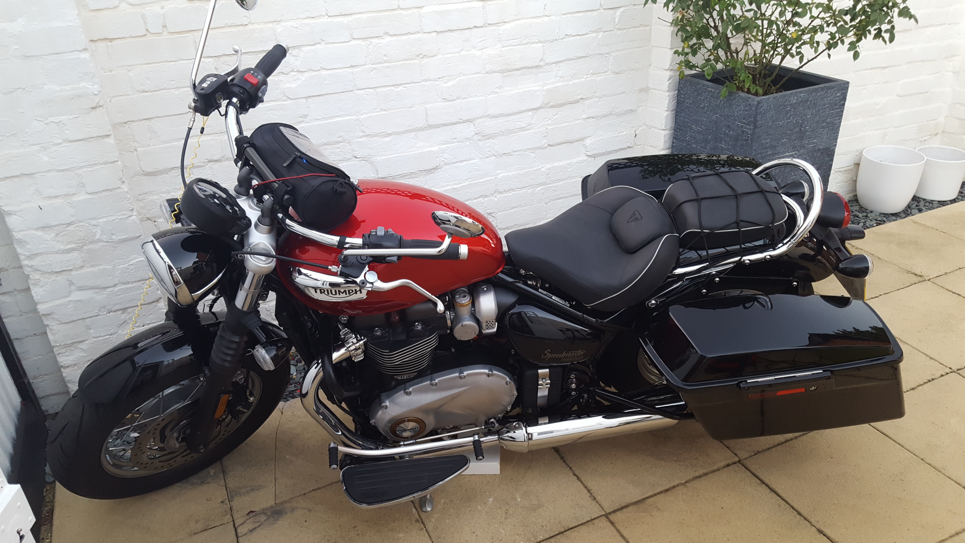

    As I often tour solo I prefer hard lockable panniers. I had Givis on my Yam previously but didn't like them on the Speedmaster. I had a Road King with Harley bags and always liked them, and thought they would suit. Only trouble is no one makes brackets.

    Those are huge!

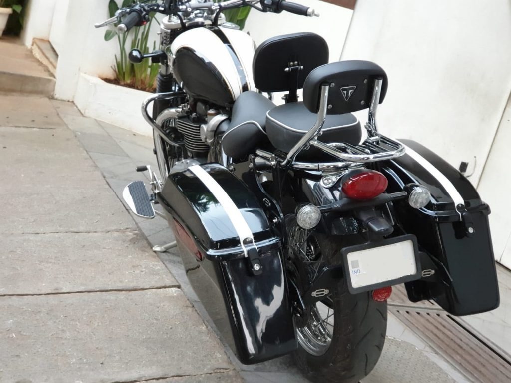

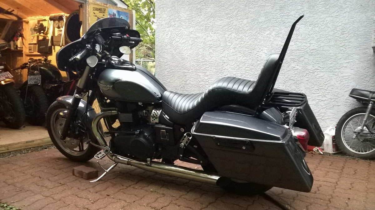

    Almost architectural. Though I'm not the first, I got these from a US forum respondent, and there's a guy in India that's produced something similar.

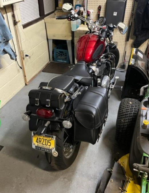

    These are Saddleman Highwayman Slant medium bags. They are not leather, but they do really look like it. They are made of Saddleman's proprietary material, SaddleHyde. I did not use any rails or braces. They are just throw-overs. The frame on the left and the chain guard on the right keep them away from ant moving bits. There is a little, nylon loop on the bottom to tie them to the frame, but I didn't bother. The only thing I did do was to install a grommet on each up top on the front to thread a leather thong through to draw them up tight. I've had them for eighteen months now. They are holding up well. I think they look pretty good for as cheap as they were. My only complaint is the buckles. They haven't broken, but they are really chintzy. They do work, however. The bags were $114. I put a small tool bag on the sissy bar for quick access to some little stuff.

    This set up looks quite wide, but no worse than the panniers I've seen on Adventure bikes.
    I'm gonna look into these.
