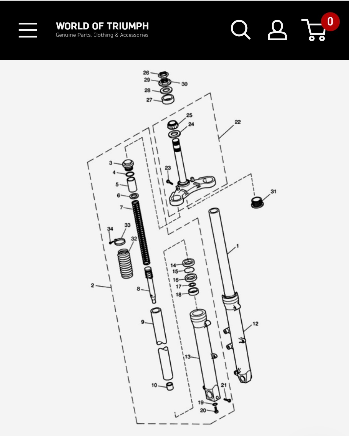

    I had a 2019/20 Street Scrambler with cartridge fork upgrade over the earlier models and the TEC emulators were not listed for it as they were not required. The cartridge is in the RH fork leg only. Your T100 could possibly have a similar cartridge fork? If it has, the top cap will be screwed into the damping rod in the RH fork leg. I fitted the progressive fork springs which were a worthwile mod.
  4. Dartplayer
    7,967
    T100 EFI Fork diagram showing catridge (as per @Pegscraper). I had the same for Bonneville Speedmaster.
    https://www.worldoftriumph.com/collections/100064899-1-2?type=bonneville-t100-efi
