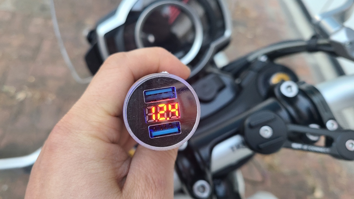

    The problem was that four months ago, restarting was not possible while stopping or parking.
    Triumph replaced it with a new battery, but the symptoms are repeating.
    If the start is not possible, the voltage is normal, I left the bike to Triumph for a month, but I can't find the cause. Please refer to the video, and if you have the same symptoms, please leave feedback. Have a nice day

  3. dilligaf
    12.4v is not enough I’m afraid :(
    It has to be at least 12.6v:confused:
