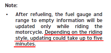

    My Street Twin takes about 5 minutes or so of riding to fully calibrate. The owners manual even mentions that. So if it eventually registers full than it is working OK.
    From the bike manual:

    I did read that in the manual, but even aallowing the time for recalibration doesn't make a difference. Have not had a successful 8 bar fill up yet
