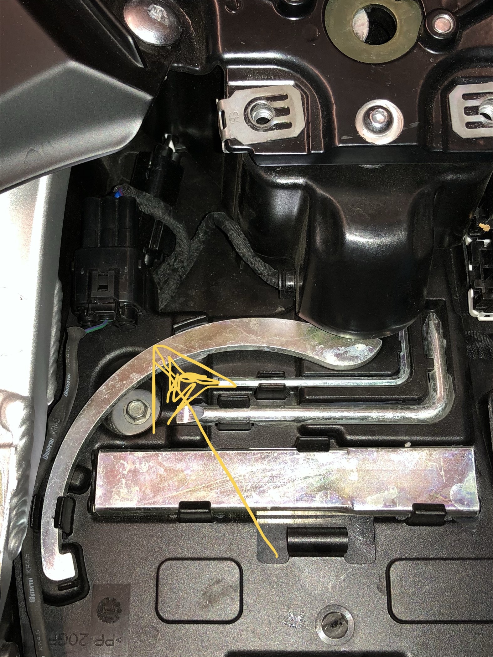

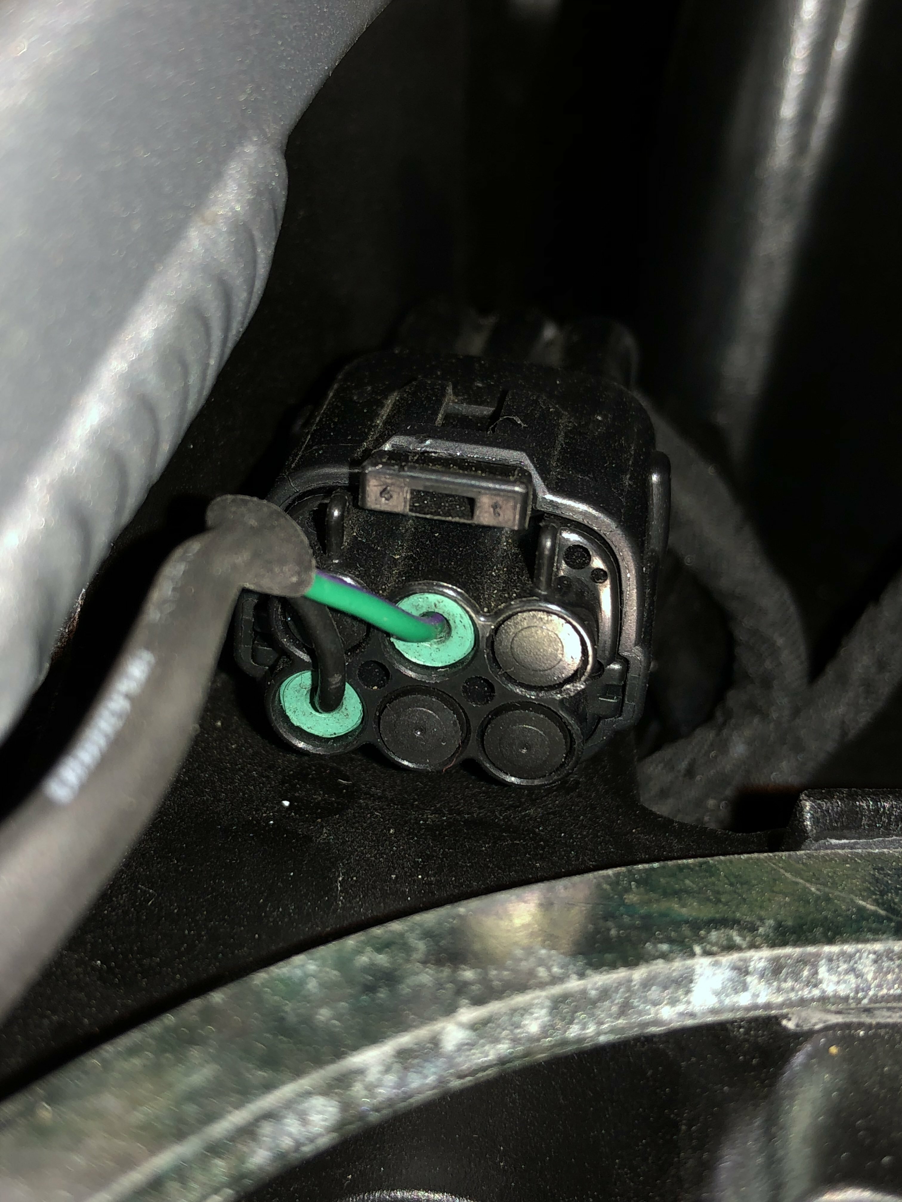

  6. Arno triple
    Arno triple Senior Member
    Aug 26, 2018
    615
    Right, obviously I’m mistaking.the connector is under neath the DRIVER seat. So took this off and made a couple pictures.
    Don’t know if connector is standard present, otherwise your dealer or internet may be of use.
  7. mappster
    mappster Member
    Jan 24, 2017
    60
    North Wales
    Thanks for the pic. I will have a look at mine this week

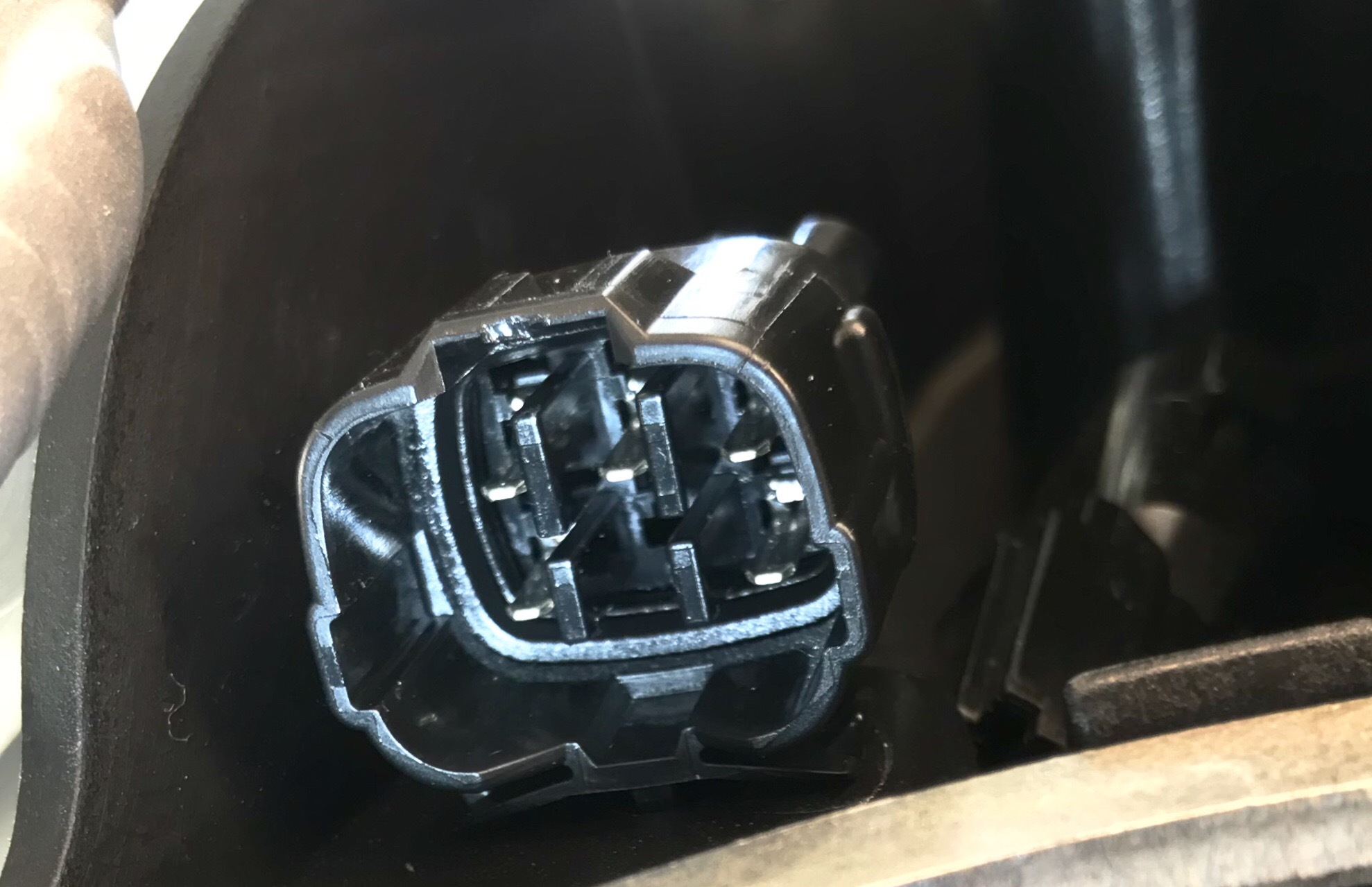

  9. Simon P
    Simon P Well-Known Member
    Dec 19, 2018
    34
    Yes thanks, wondering if the wires need some form of connector to fit into that socket, or if they just push in. I’m no electrician!
  10. Arno triple
    Aug 26, 2018
    615
    I think they need a connector, since my dealer switched pos en neg by mistake
    and could switch them in the connector. Might need to visit your dealer to sort this out.
  11. Simon P
    Dec 19, 2018
    34
    So under this connector there are 5 tiny spade connectors; if you take the cover plug off, pull out the rubber bungs, you can wire to these with 3mm female spade connectors. Got the volt meter out today, the bottom left connector is live and middle connector on top is neutral, power switches off with ignition. Bit of soldering and heat shrink tube and my radar is fitted and goes on and off with ignition. Job done!

  14. Icarus
    Icarus Member
    Sep 11, 2017
    Salisbury
    Many thanks for the info Arno...wired mine up this evening....In case anyone is interested, the connectors are easily available (electrodart on e-bay) and are made by Sumitomo as with many Triumph connectors...took some detective work to find this out!
