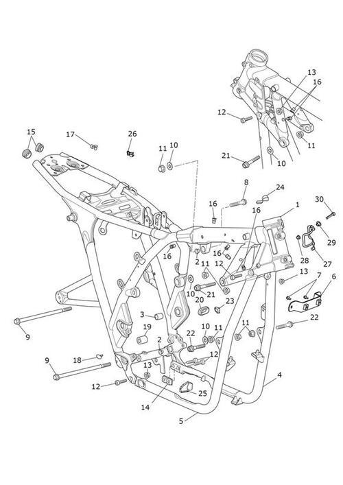

  13. garethr
    garethr Well-Known Member
    154
    BRISTOL UK

  18. garethr
    154
    BRISTOL UK
    As suspected, they replace part no. 27 in that diagram.
    The new part bolts to the lug above the VIN plate and protects the wiring harness by covering the lug below the VIN plate.
