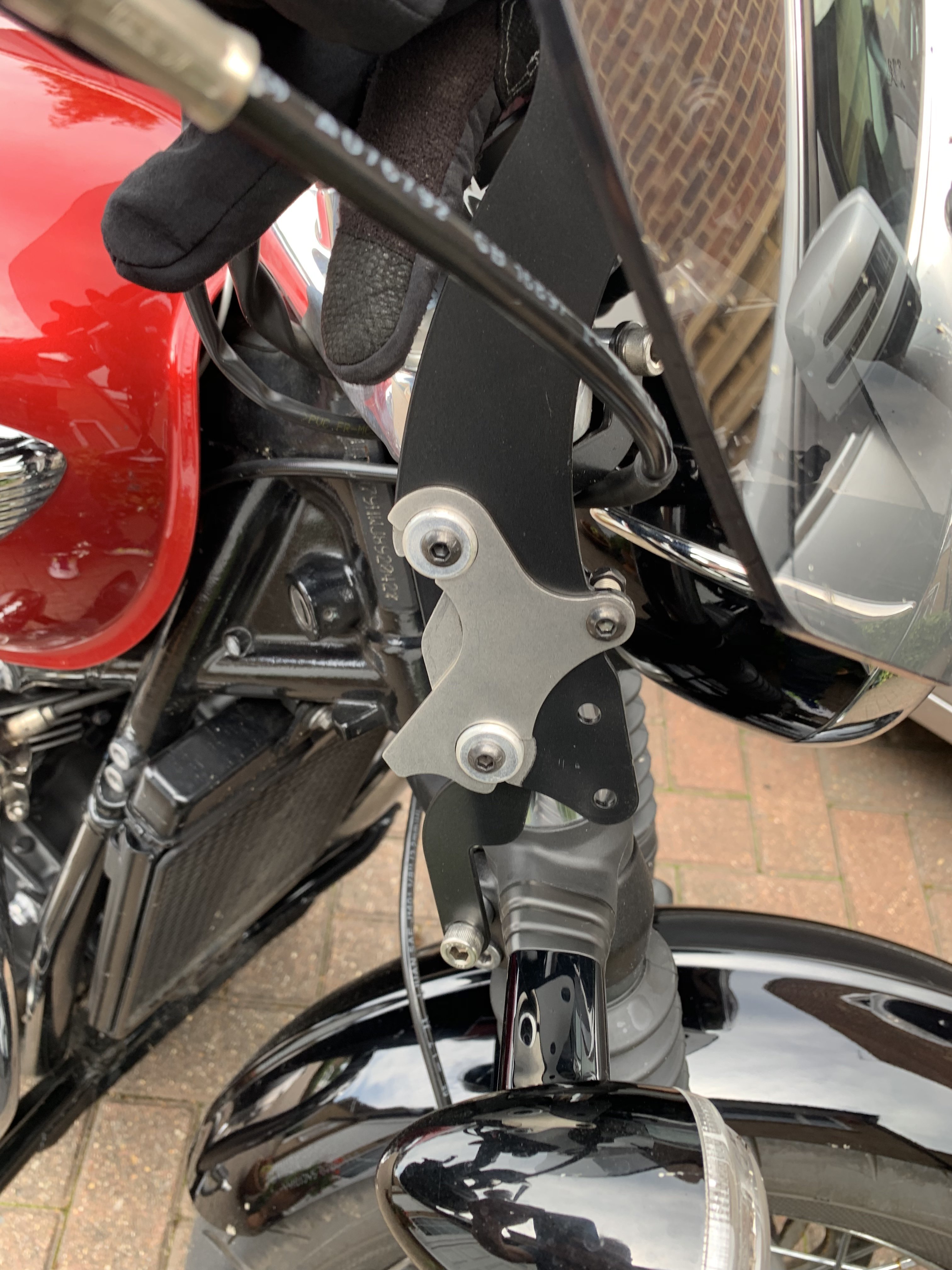

    I hope you found a resolution to this. Sorry to hijack your post but wanted to say that I bought my SpMaster screen from Madstad in US. I received it after paying customs fee and scratched my head for a few days trying to figure out where the various brackets, screws and rubber bits went. Then I read the instructions and managed to get the brackets mounted to the forks but there were no instructions on how to mount the screen to the adjustable brackets so I emailed them. The next day they sent me some pics and bingo. I bought 20inch screen as I’m 5’9 and the difference is amazing. My neck is no longer having to go through a work out and I can ride visor up. At high speed without it I was wrestling to stay on the bike but now I can cruise over 70 in relative comfort. Good luck with your screen Czechmate.

    You need a socket big enough for the top but. About 24 mm and Allan key to undo the Allen head screw's in either side of the yoke. It lifts off , might need some force as residual grip on fork leg's might be tight still. It's all easy enough from there

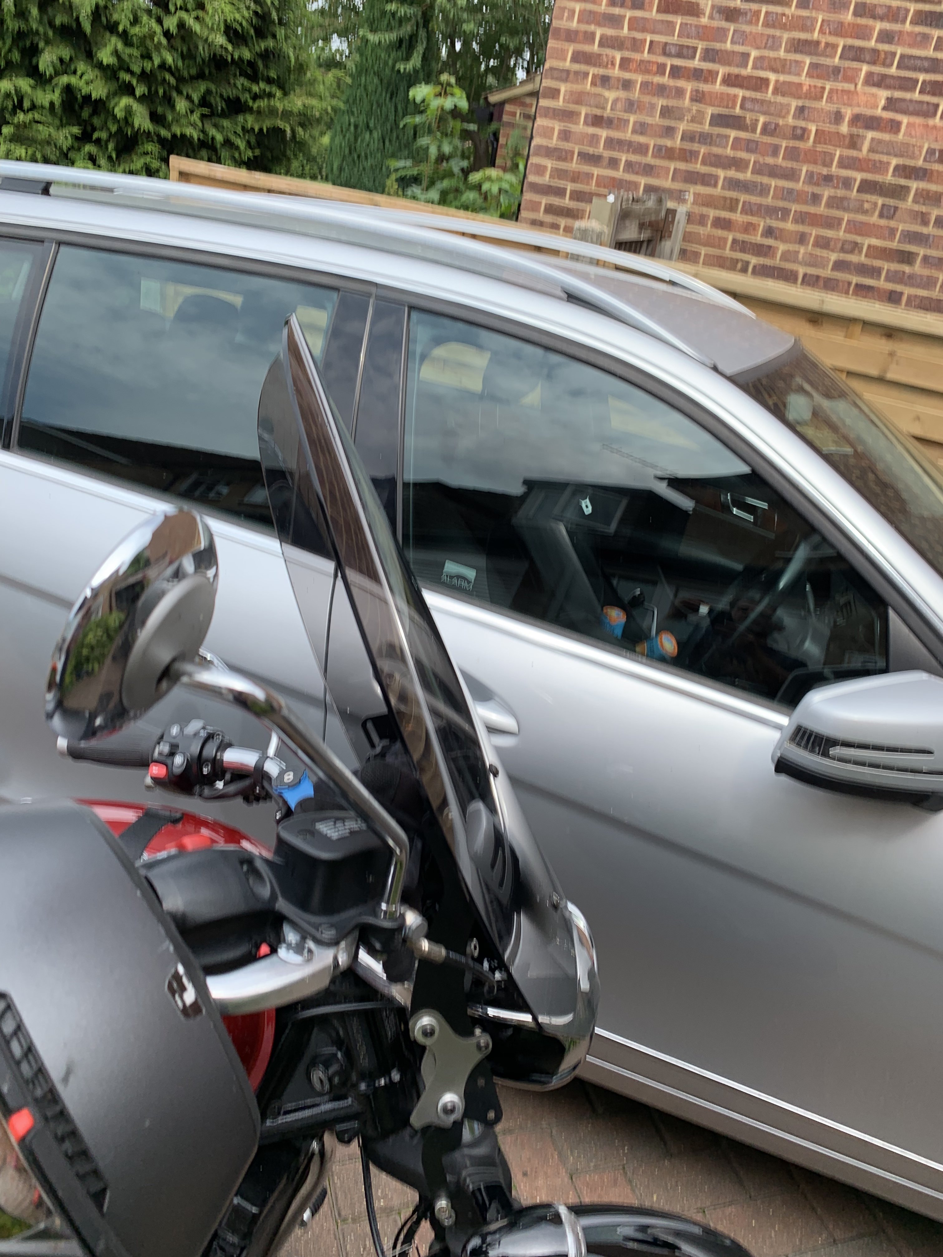

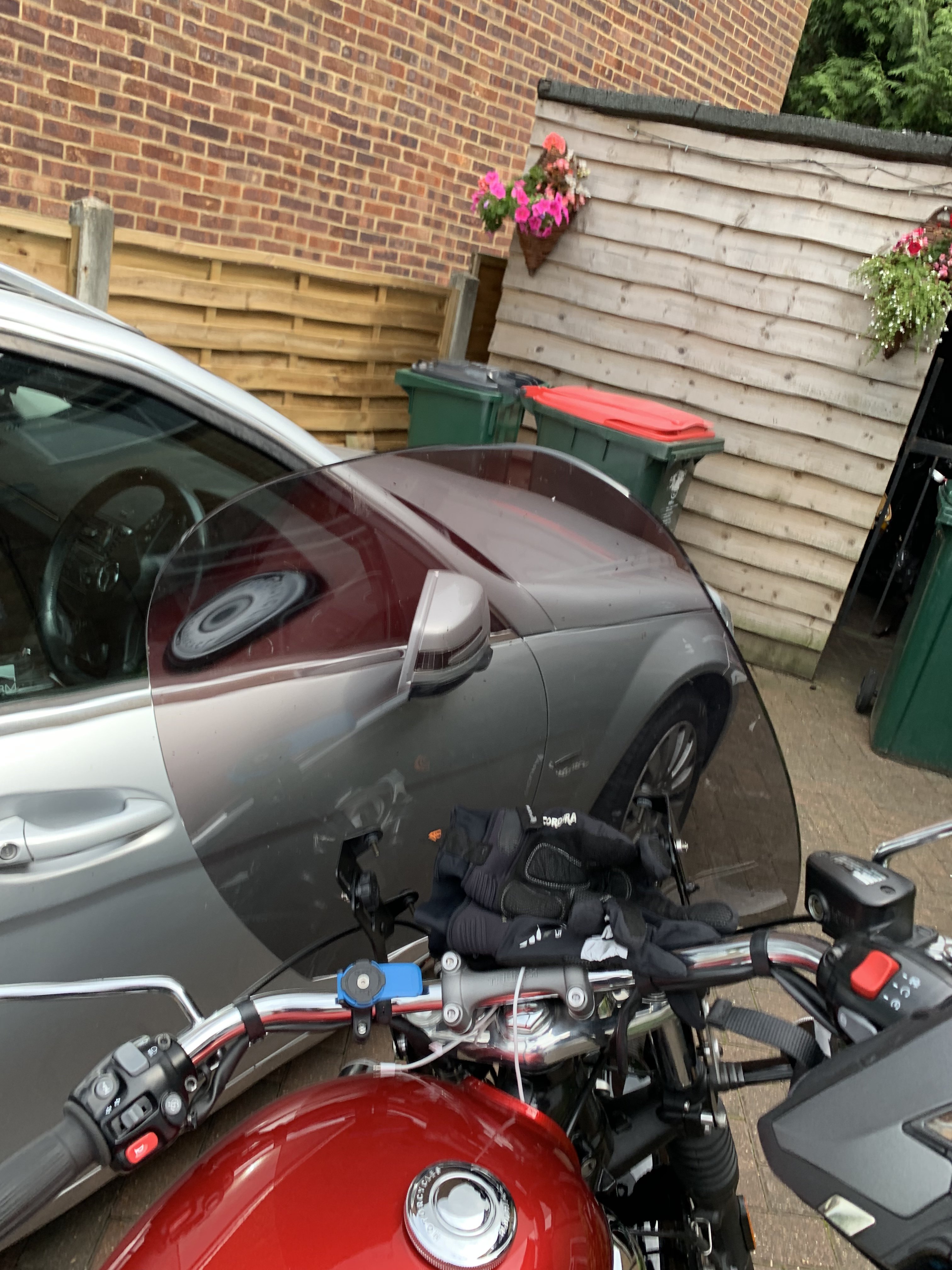

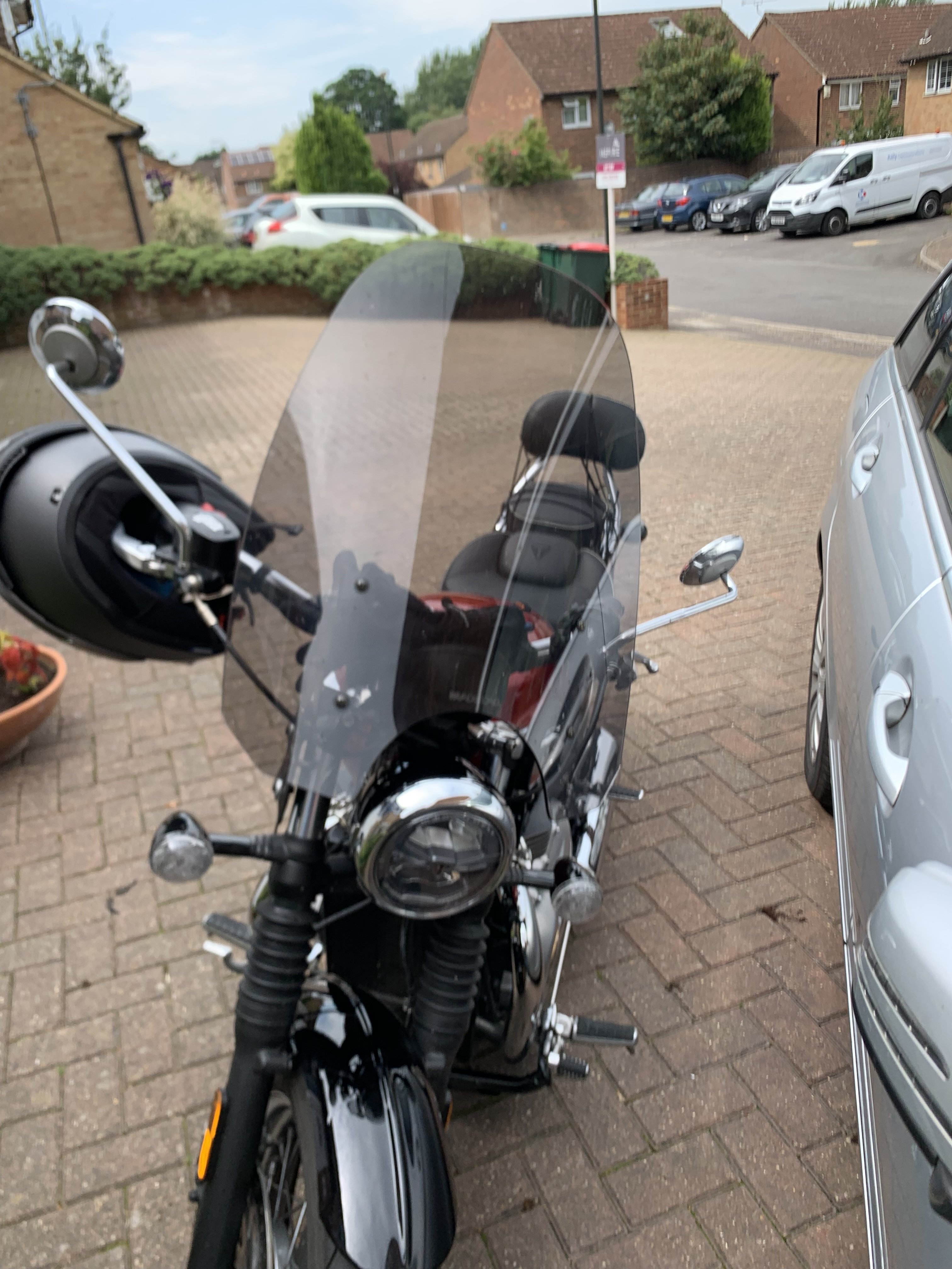

    Like that idea, any pics you can post?
  10. Croxbt64
    Croxbt64 New Member
    Jun 4, 2019
    21
    Crawley Uk
    I’ll try!

    Sorry, just looked at your earlier post which confirms my last question.
