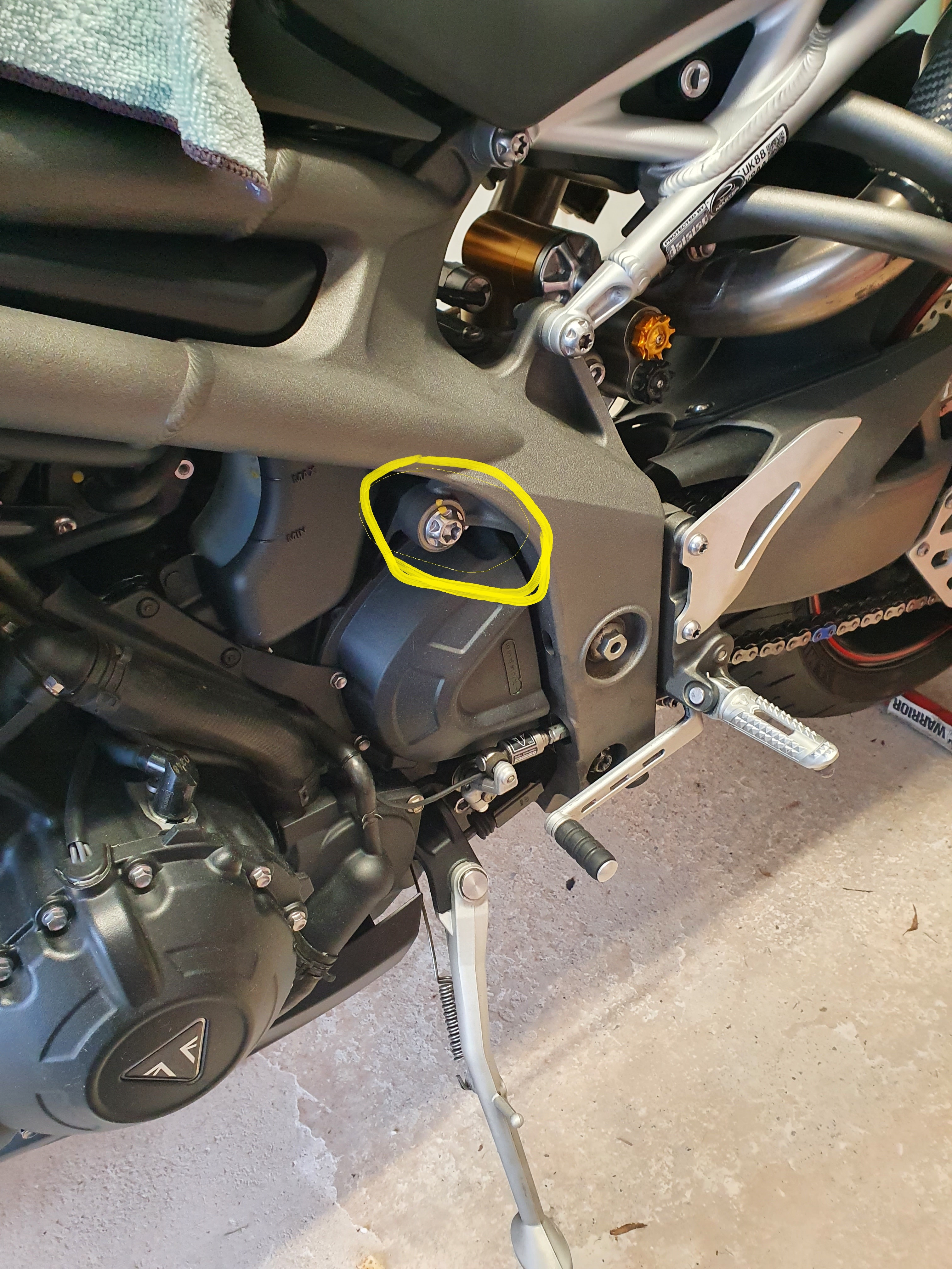

    Looking for some info please.
    Does anyone know what size torx head this is and and what torque setting it should be tightened to ?
    I am trying to fit the adapter for my new 1jac, so if anyone knows the best way to remove this bolt please let me know as the nut on the other end looks incredibly difficult to reach.
    Thanks.

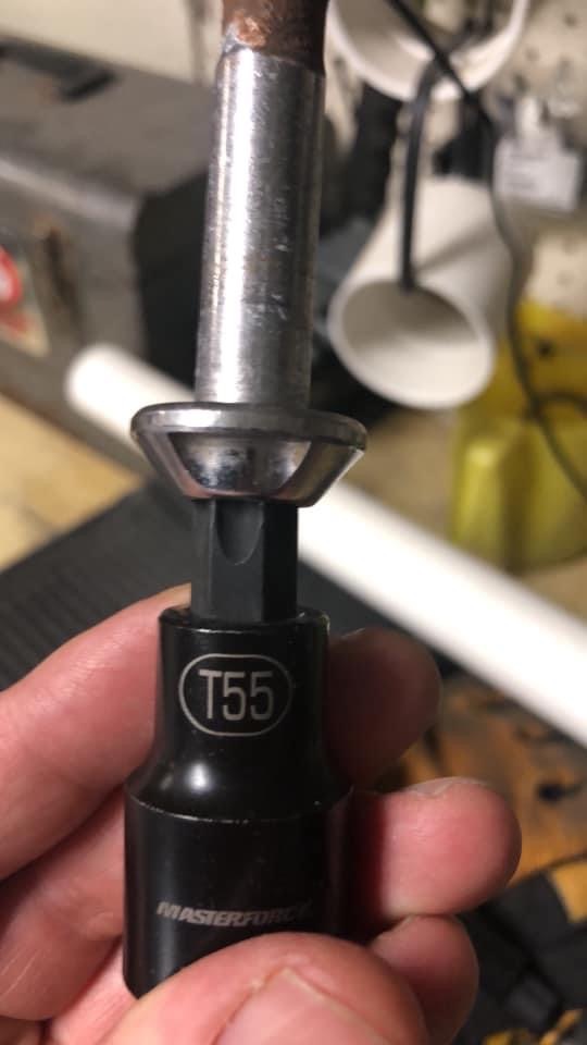

  2. Rooster
    Rooster Grumpy Member
    Sep 14, 2015
    1,639
    Droitwich, Worcestershire
    T55 - I don’t know the toque setting though, perhaps someone on here will have a manual.

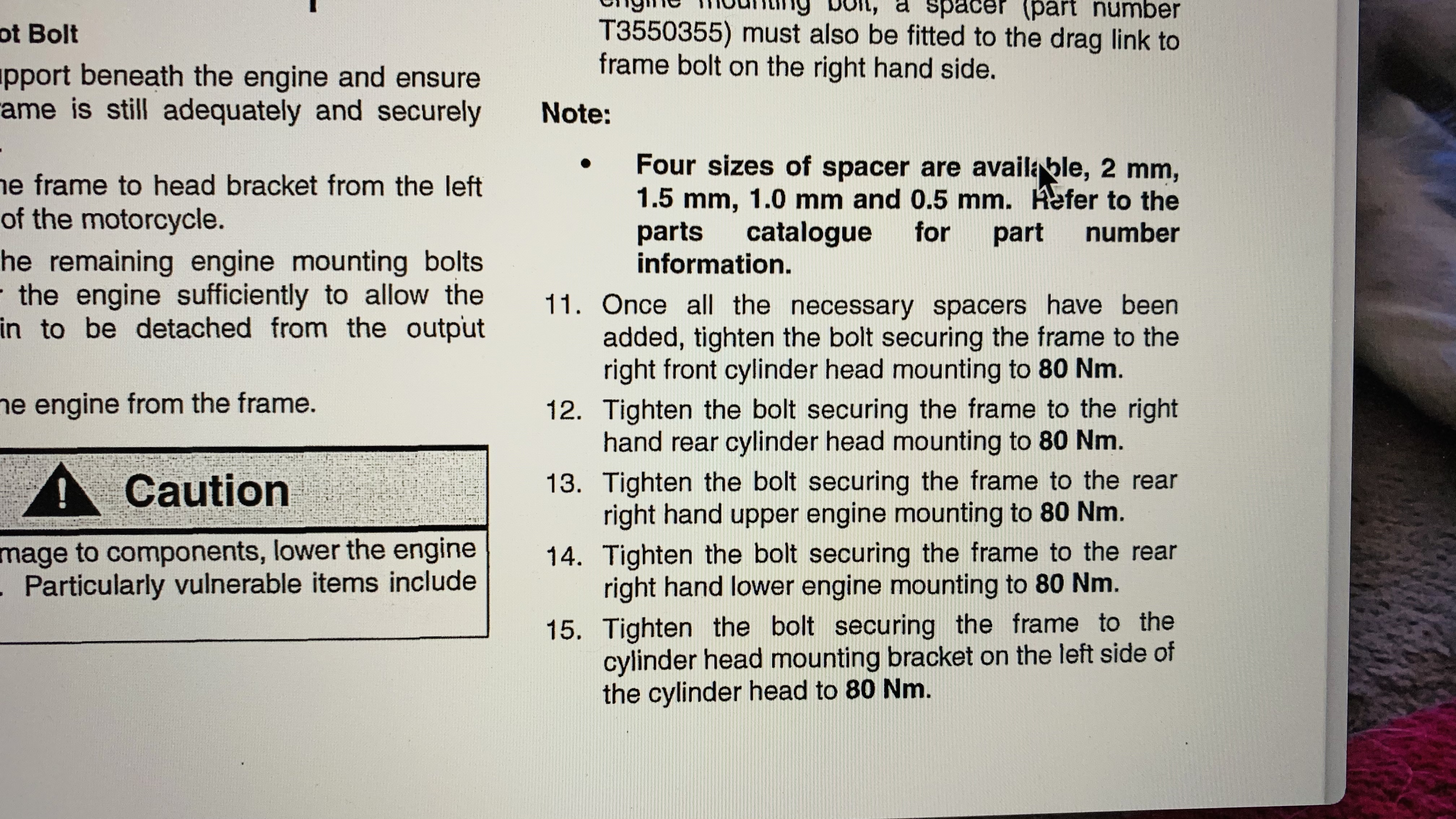

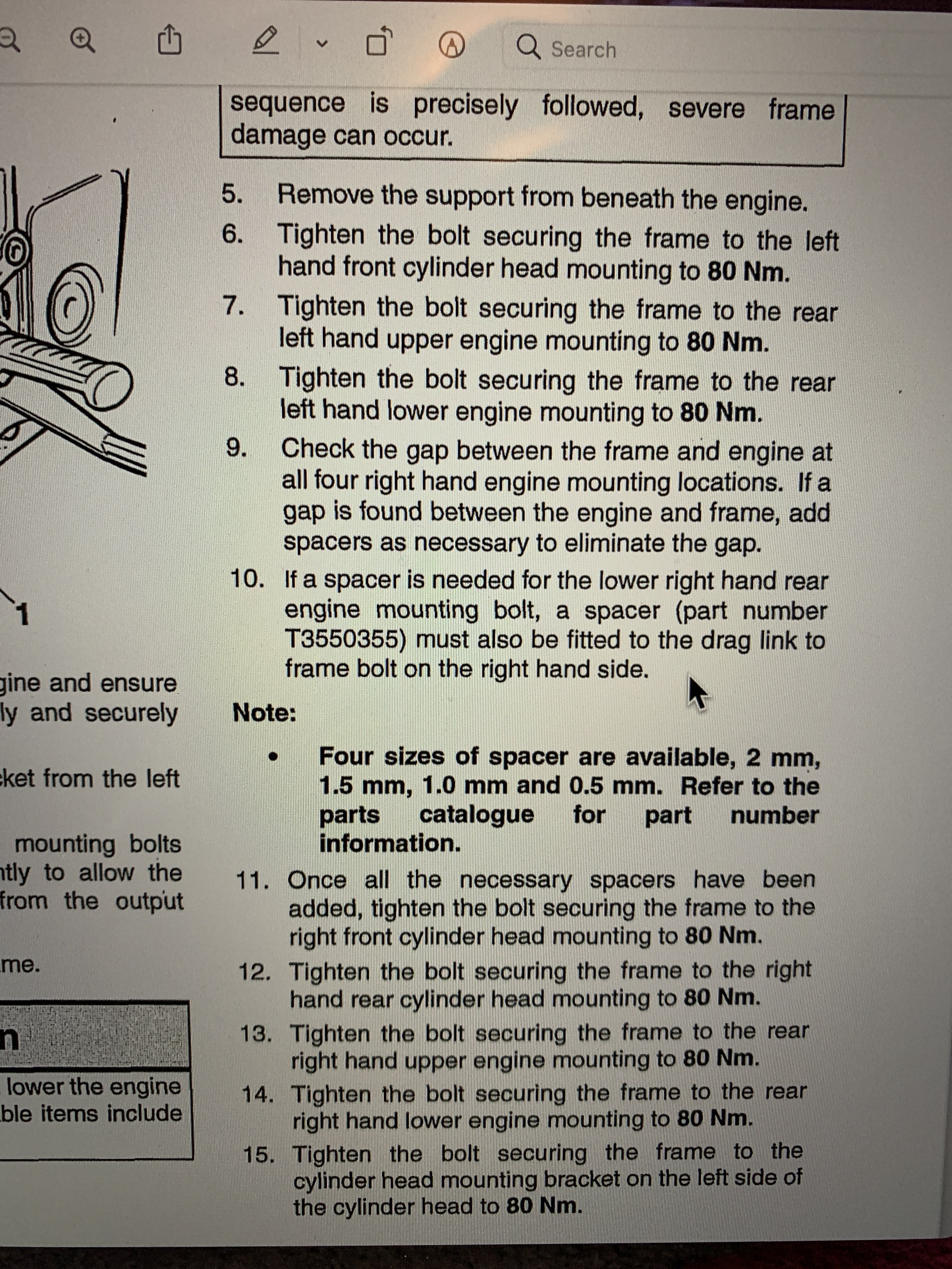

  3. Ducatitotriumph
    Apr 25, 2019
    2,181
    Rothwell
    This is from the manual.
    However, use with caution etc!!!!
    To get to the other side, lift up (tilt) the tank as you have way more access then.

  5. Ducatitotriumph
    Apr 25, 2019
    2,181
    Rothwell
    Please be careful tightening as there has been some horror stories about cracking frames as spacers weren’t put back when tightened back up!
