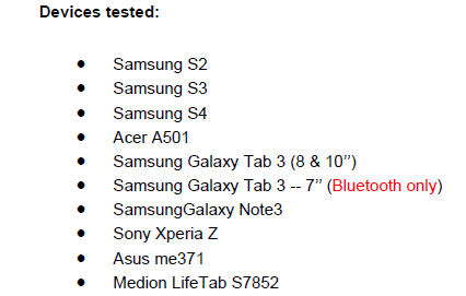

    Can I use Bluetooth adapter on a Samsung Galaxy tablet?
  15. Yorkshireman
    3,401
    To answer a question with a question can you download android apps, if so then it would seem ok. Col?

    Seems i can download the app for about £11

    I don't have first hand experience of tablets, but I assume you just go to GooglePlay and download it just the same as smart phones. The TuneECU site has tested on these devices.
    So I assume you're good to go.

    Got a Galexy Tab E which isn't shown on there. Will have to ask b4 I order it.

    TuneECU is a small enthusiast operation, so that is just a list of devices they've managed to test. I'd be surprised if it doesn't work on your Galaxy (it has bluetooth according to the 'net).
    Of course if your laptop has bluetooth also you could try it on there for free. (+ £10approx for dongle which works with either)
    For ref. TuneECU works fine on my HTC One (M8) smart phone - which is nothing fancy and quite old now.
