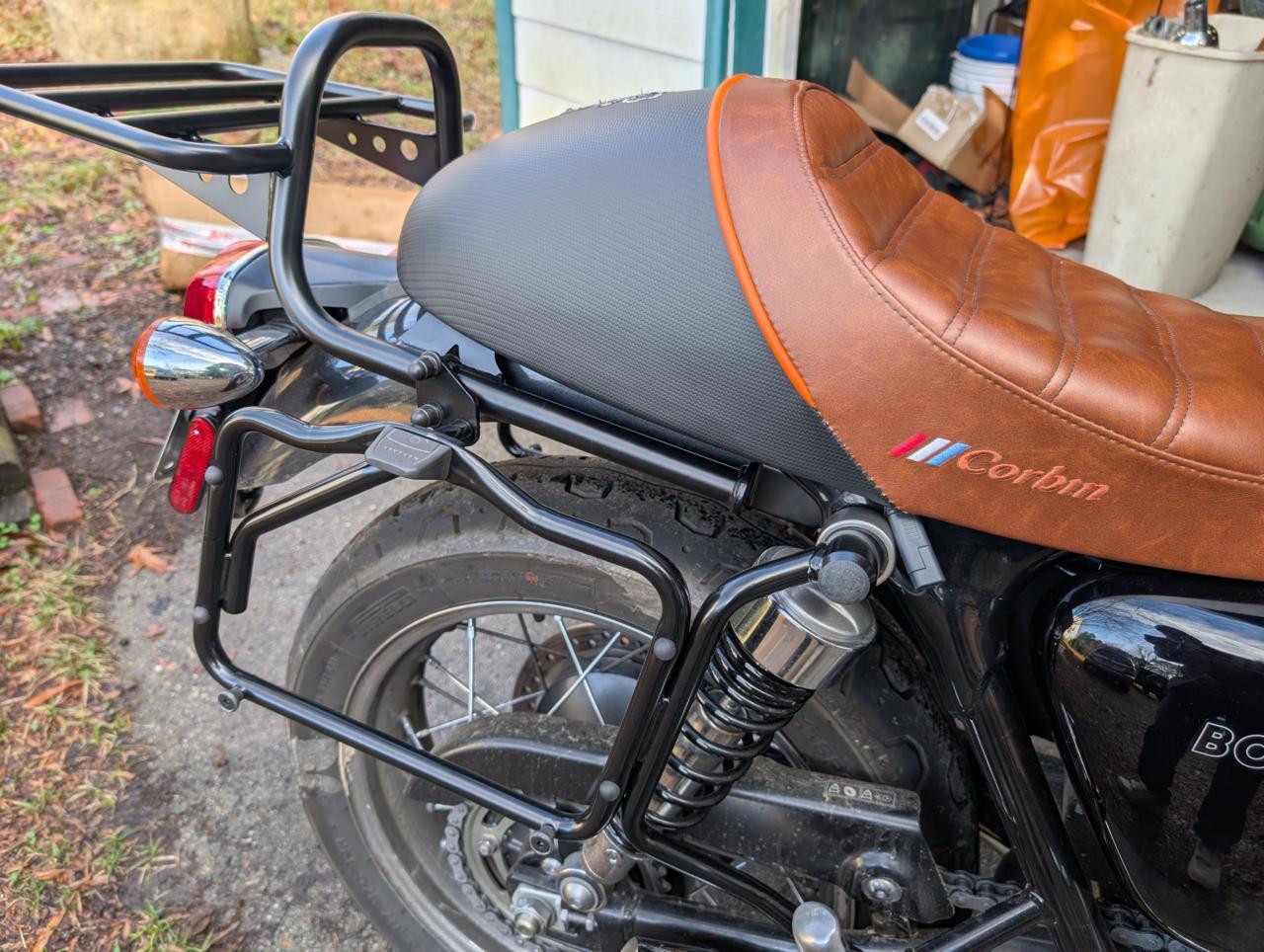

    Givi PL4610 packs two mounting brackets: One for stock Triumph two part rack, and another with "U" bolt clamp for other racks (including the Givi SR4610). The Tec rack sits at the right level, and SO fortunately, the "U" bolt fitted directly between the braces which mount the luggage rack to the underseat fender.

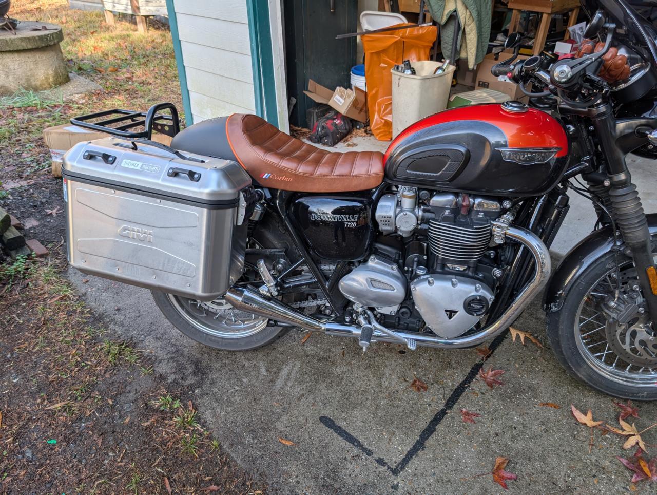

    I kinda dig the aluminum contrast with the chrome to brighten up the bike.
    The black might be too much Darth Vader hahah.

    This looks great- thanks for posting the pics! I really like that black and chrome contrast as well, and the Tec rack looks quite sturdy. (Hard to tell on their website)

    Very satisfied with Tec rack. It also uses the forward attachment points for strength, never could figure out before I installed it that there are two *threaded* holes in the frame directly behind the top shock bolt. The rear racks are anchored to those holes with new bolts.
