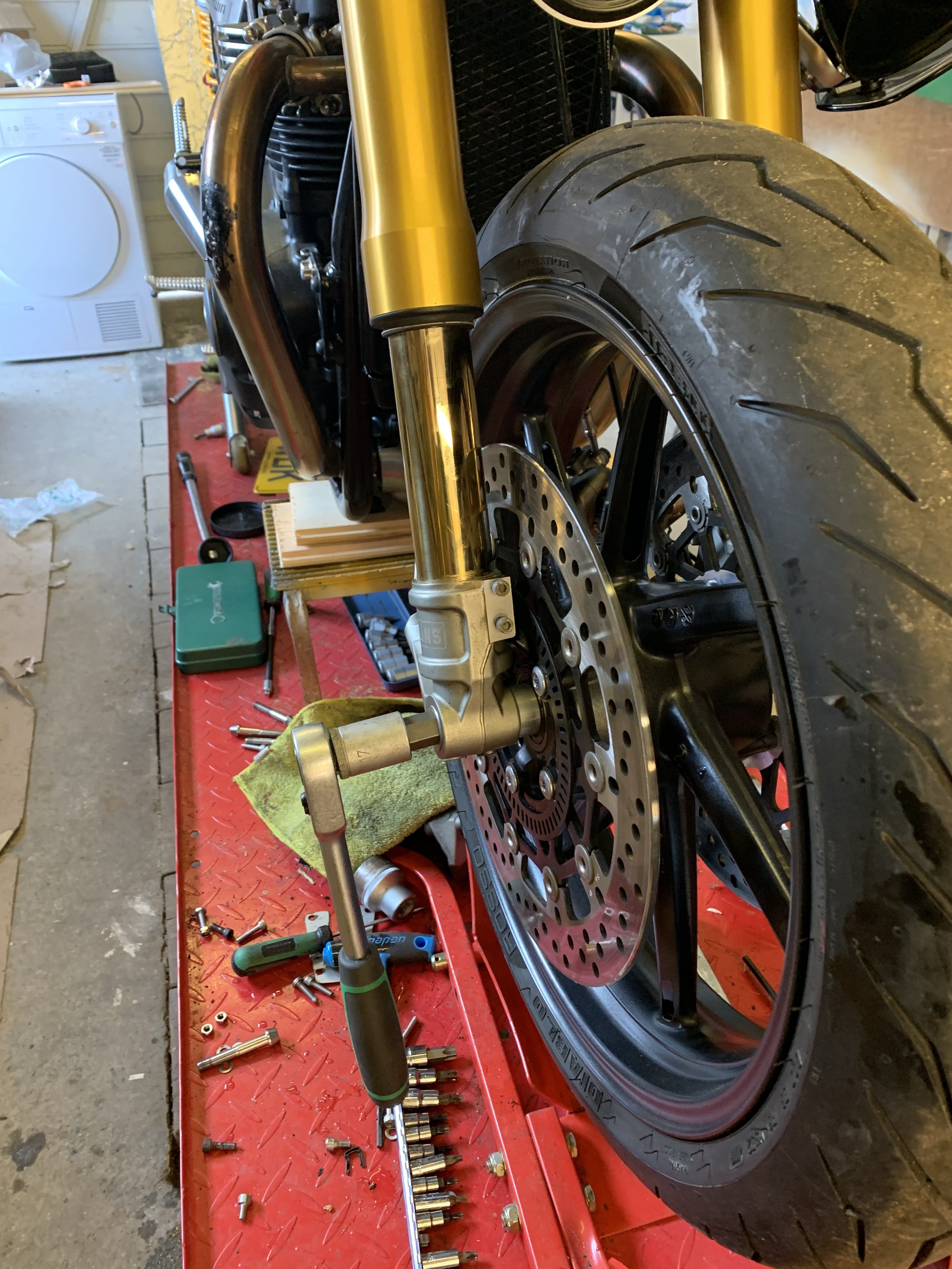

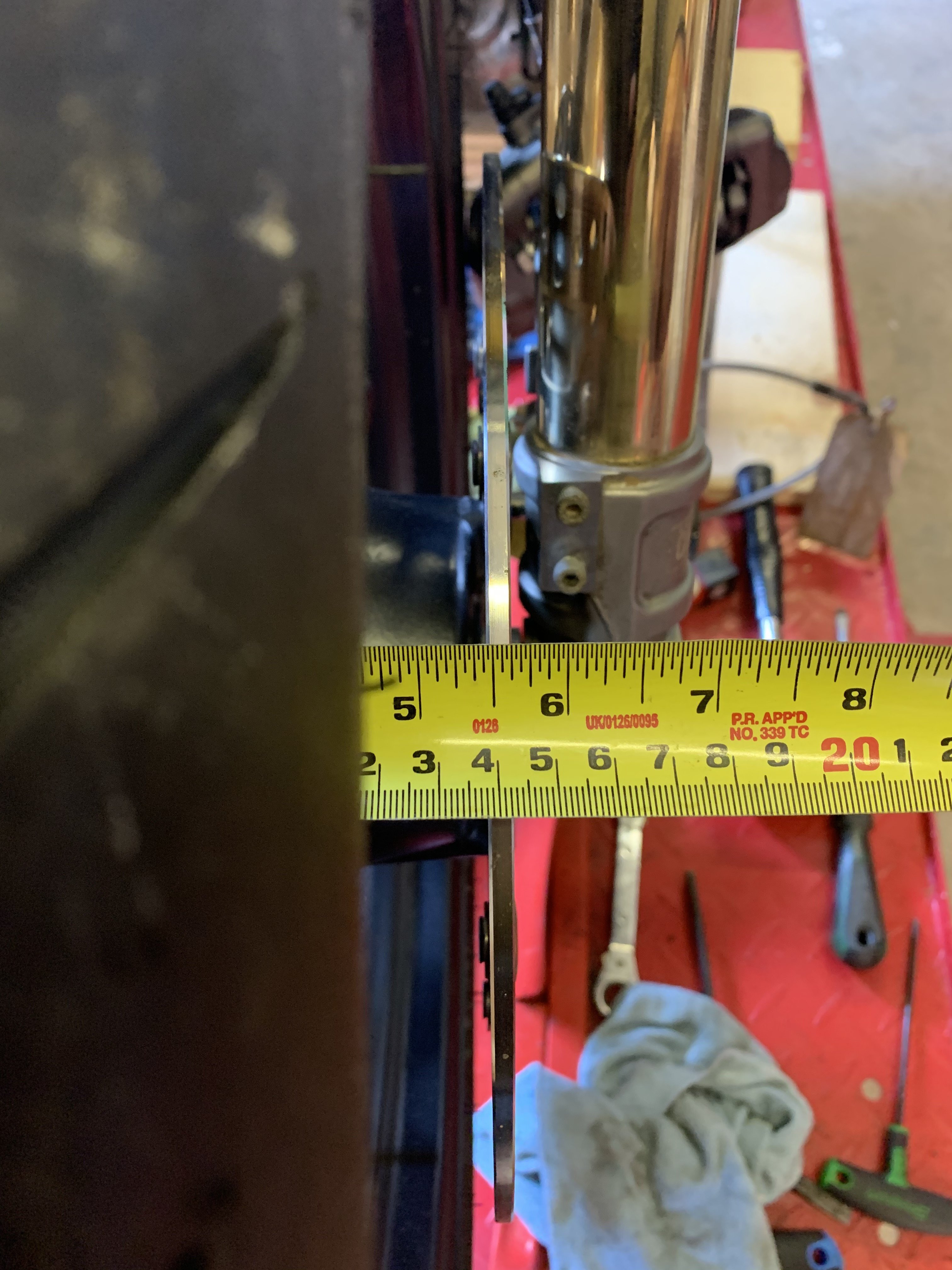

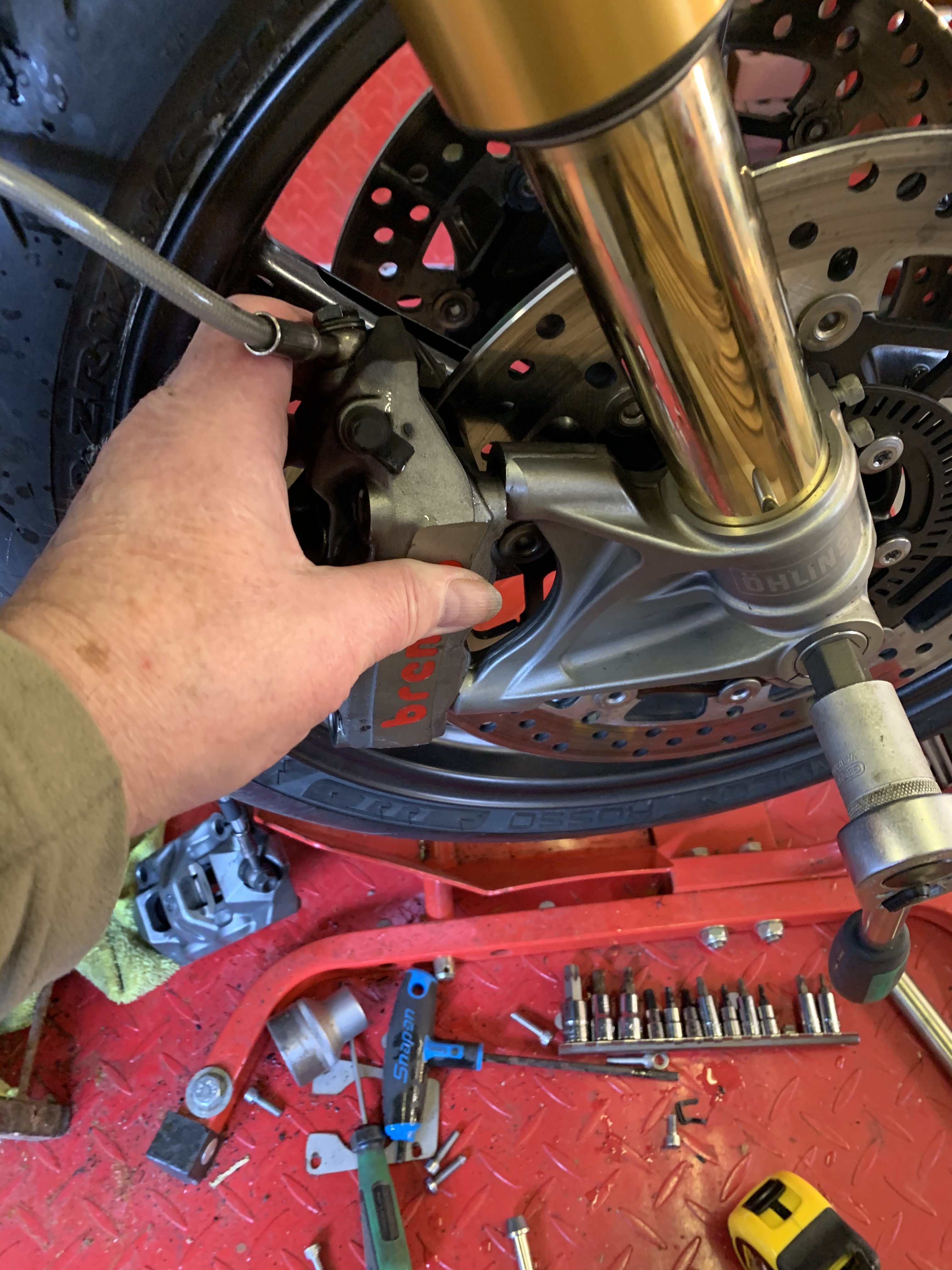

    could any R owner (2016) Ohlin's forks measure the distance in-between the discs' outside to outside, I'm fitting a R front end to my Speed Twin, and it would appear that the Speed Twin has a slightly wider front end.
    This not allowing me to mount the R Brembo callipers correctly

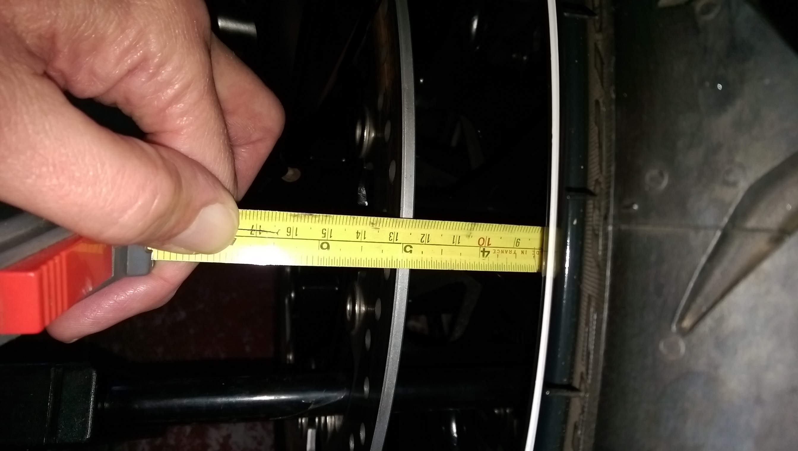

    Yes, disc mounts more directly to the wheel on the S3R, I'll go measure....
    128mm give or take

    Col, thanks for that, mattP also replied with the same measurement, "Measure Twice Cut Once" still rings true all these years after my apprenticeship

    Col I am going to look at taking 7mm of each side of my wheel , that is off the disc mounts hopefully
