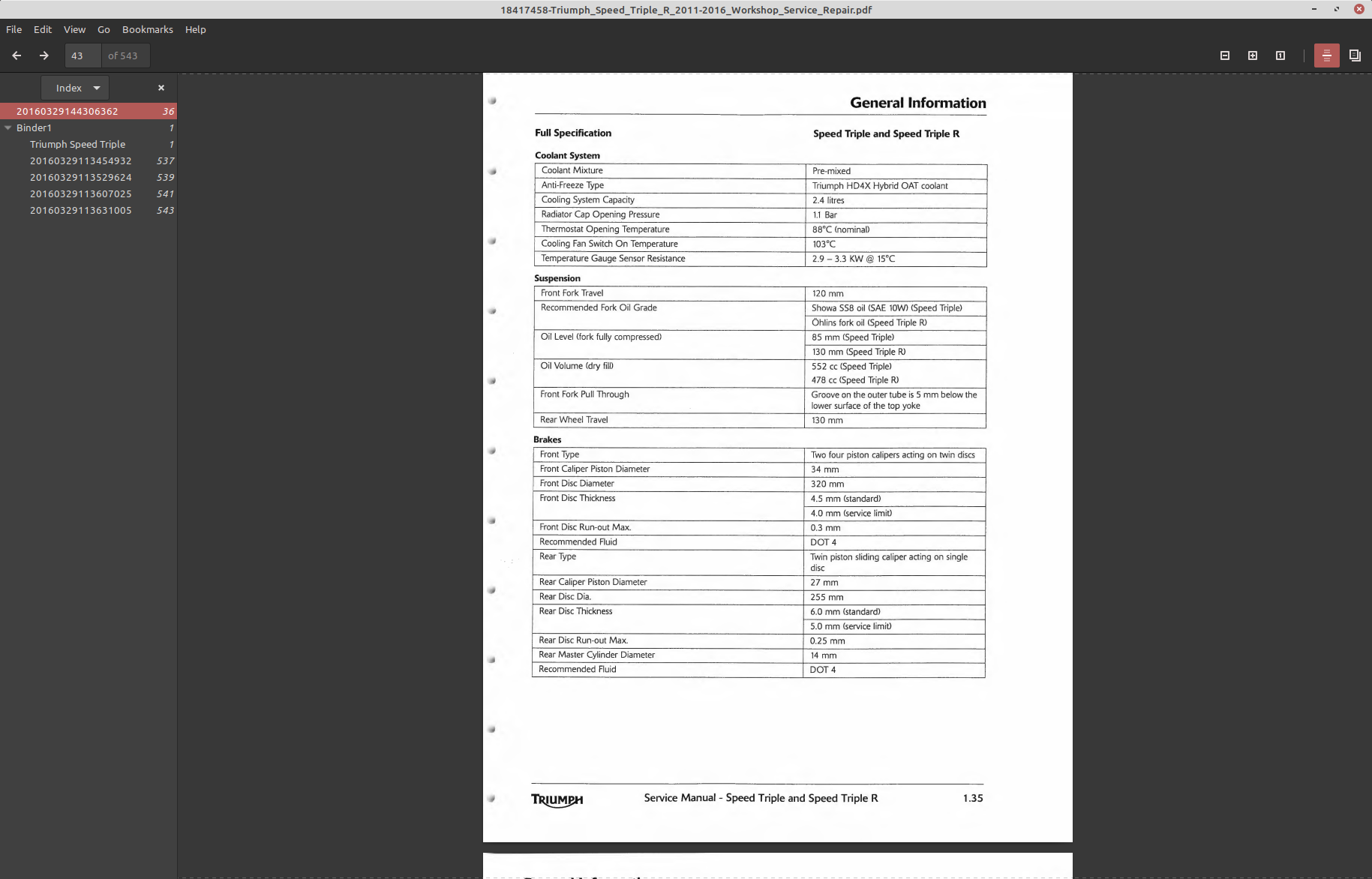

    It looks as though it is actually 14mm. If it's the same as the rear. Weirdly there's no spec for the front, only the rear MC. I've been right through the manual and there are zero other indications as to it's size.
