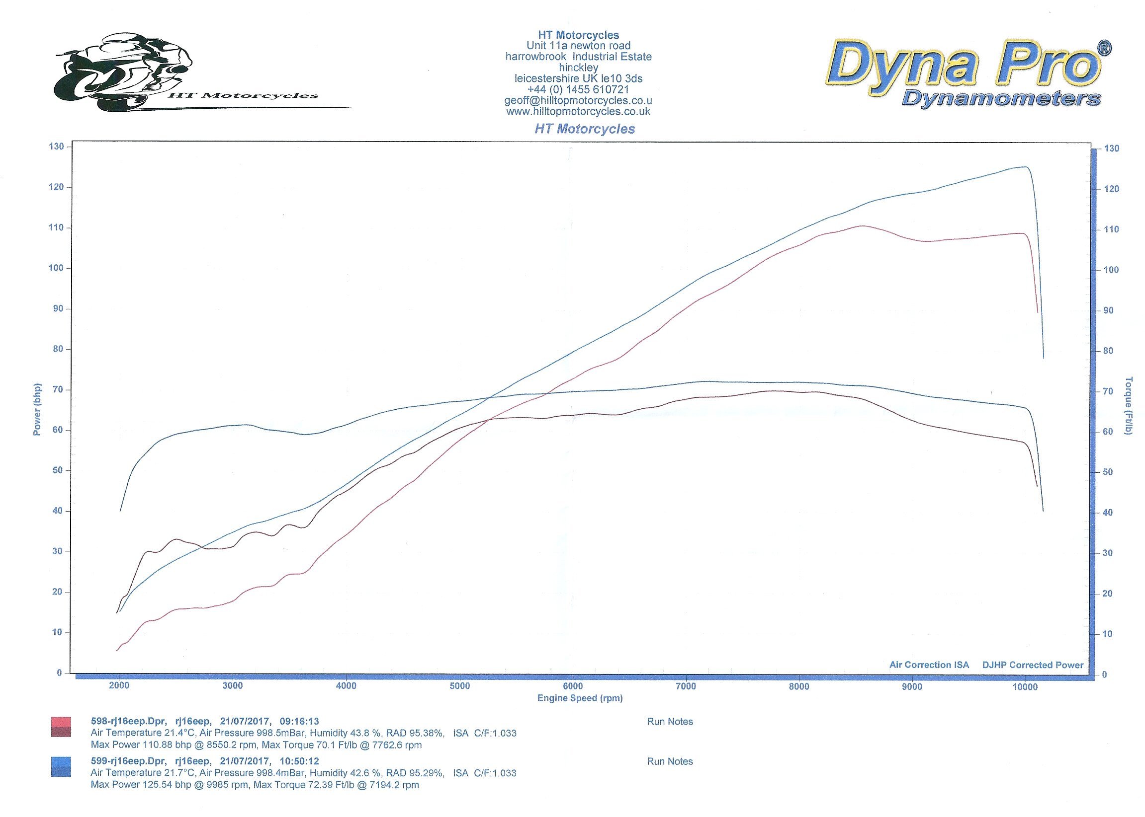

    Yes but there's not many can do it.
    This is the dyno chart for my 2017 Speed (with lowboy) after Hilltops set it up.

    Does it really only have 110bhp stock ?!
  5. Yorkshireman
    3,401
    At the back wheel, yes, and don’t forget each dyno is slightly different and a lot of criteria can affect the outcome, air pressure, density, humidity, temperature, condition of the chain and gearbox, general overall service condition, (air filter, plugs etc)
    I’ve seen dyno runs improve by several bhp just by lubing the chain while the bike is on the rollers.
    What you get with the Hilltop remap is obvious from the graphs, real usable grunt low down and midrange where we ride mostly on the road. Look at the doubling of the torque at 3000. You also get a very smooth transition from a closed throttle and more mpg.

    WOW!! :eek: That’s a massive improvement in torque the first 4000 rpm! Wonder if my 2018 RS is worth the dyno after waranty period...

    It won’t be worse, that’s for sure, and you don’t have to wait for the warranty to run out, Hilltop write their own data into a part of the Ecu that the dealer can’t see or change;)

    No, HP figures depend on how the dyno's set up, it would probably read 160hp on something like a dyno......
    It's the before and after figures that are much more important than the actual hp reading.
    Probably, Triumph have to set it up to meet emissions tests and noise tests, dyno operators don't..
    They have to run very lean now, which is probably why there are such good improvements to be made low down when setting up the fuelling properly....
    IIRC, Hilltop also set up extra mapping points which helps to improve throttle response as well.
