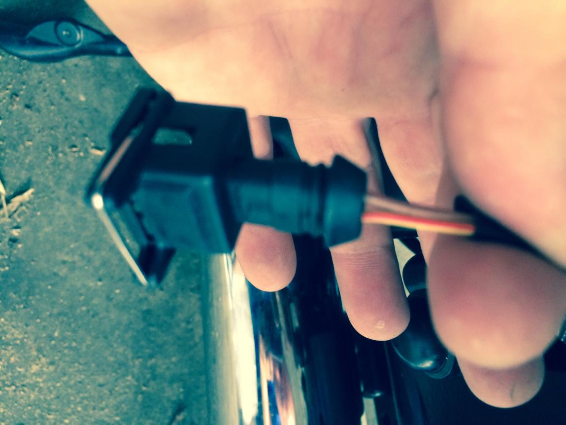

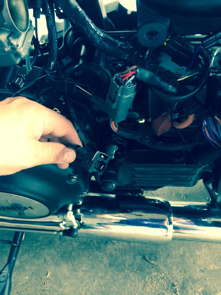

    Hi there can anyone advise me as I changed the airbox to kn filters on my triumph speedmaster 2013 and now won't turn over . Have checked everything and have this plug from the wiring harness and have searched everywhere and can't find where it goes image.jpg

    Was it situated somewhere hanging down/tied up between the carbs & the battery area or underneath the fuel tank?
    If so, it goes nowhere, I have a spare plug just like that on my America & i'm pretty sure it's something to do with California emissions only & connects to the purge valve for the fuel emissions canister. The purge valve & emissions canister is only fitted to bikes destined for the California market so the wiring harness is redundant & is either tied up out the way or just left hanging/tucked in somewhere on the loom on non California models.
    Hope this helps!
  6. Bigmac
    Bigmac New Member
    Jul 27, 2014
    Yes it's behind the battery and can't find anywhere for it to go , so that could be right . Now am really puzzled as to why the bike won't turn over !!
