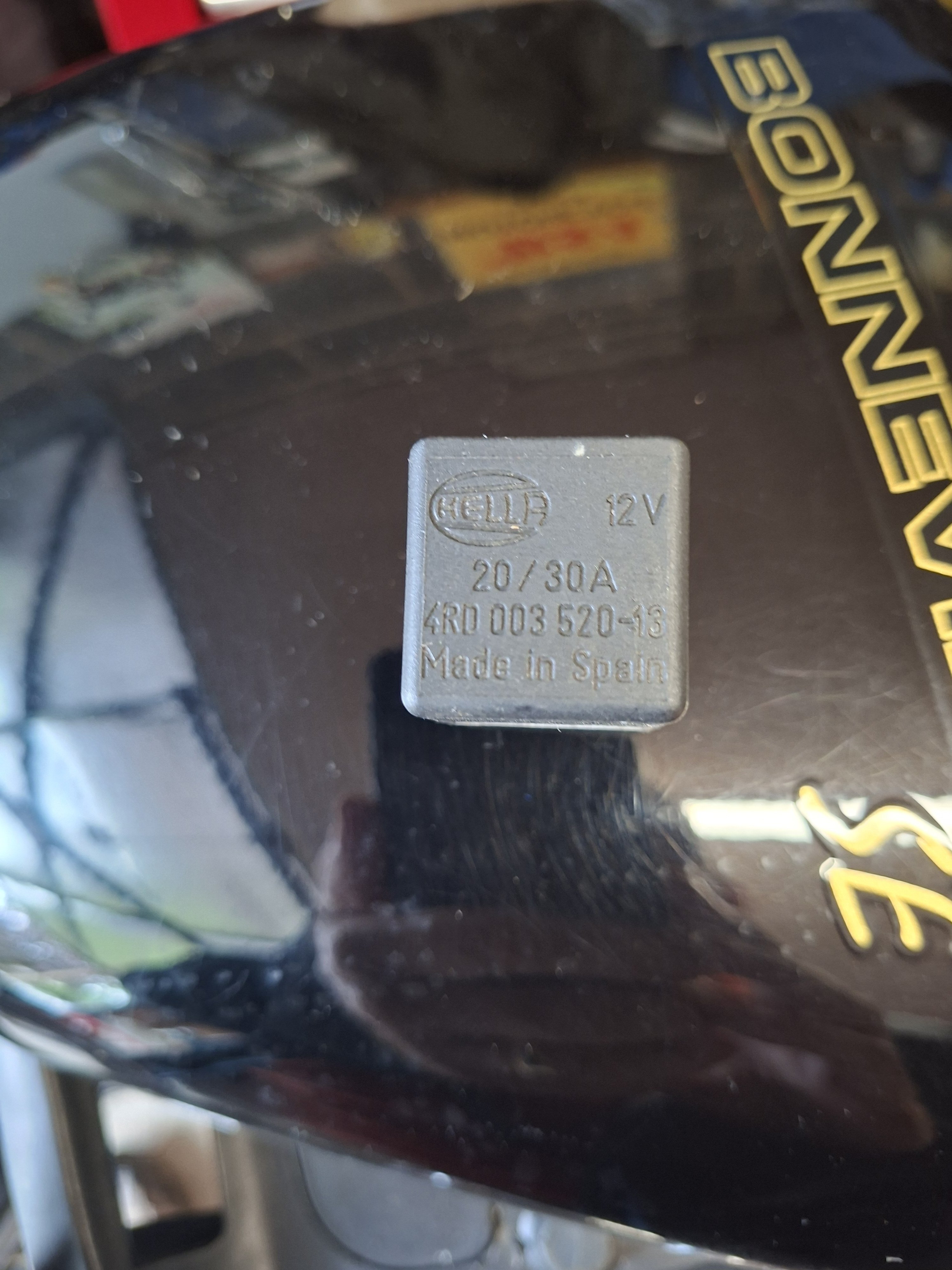

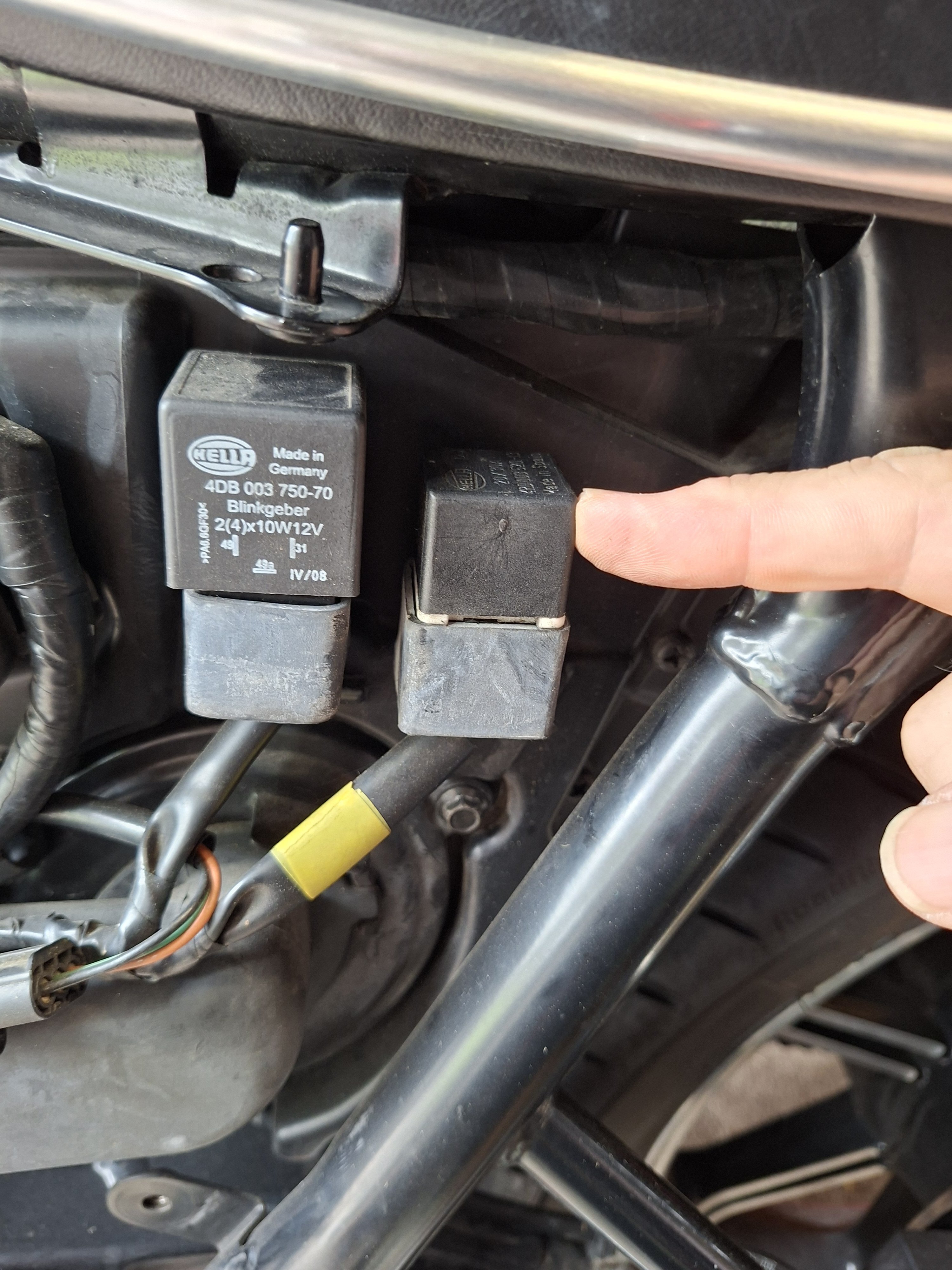

    And these are the relays. Only two and both different so no easy swap. I am pointing at the headlamp cutout relay which acts as the starter relay by the look of the wiring diagram.
    FYI this is the relay type
  13. Kernow
    Kernow Well-Known Member
    Jun 26, 2024
    61
    Cornwall.
    Mighty Boosh is correct that is the starter relay the other being the flasher relay...:)

    Nothing shown or mentioned in the manual. That relay turns off the headlamp whilst cranking and diverts the voltage to the starter relay according to Haynes' description, which in actual fact is the starter solenoid.
    BTW I found some equivalent relays on Amazon for 7.99 for two. A lot of Triumph dealers are showing no stock so I thought it might be prudent to get myself a spare or two....
