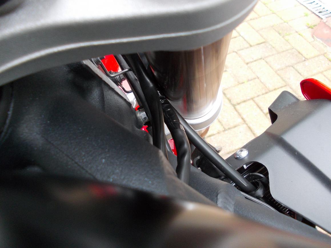

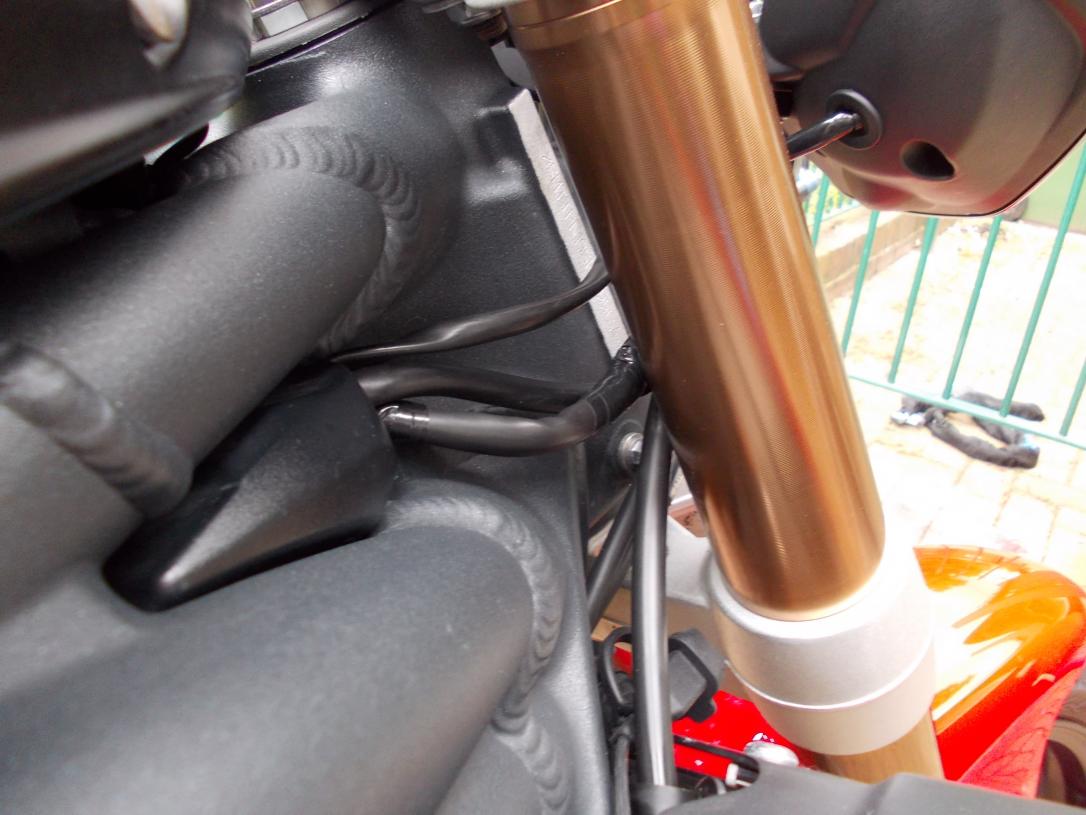

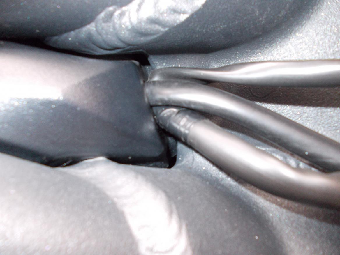

    I came across this today when I was cleaning the Speed Triple. The harness that runs to the ignition switch has split open. I'v been to my local dealer he took some photos and said when the service guy gets back from Ibiza in two weeks time he will send them to Triumph (happy days). Any one else came across this before, it's a 2011 model camera 026.jpg camera 027.jpg camera 028.jpg camera 029.jpg

    Not personally seen this before and got nothing like it on my 2012 Speed Triple. Its almost like the wires have been pulled too tight and then rubbed through or been trapped. Just a thought, has a previous owner had higher bars fitted previously?
    Can you see any of the cables rubbing or being trapped when you turn lock to lock?
    If the cables inside are not damaged I think I would get some new protection sheathing or tape over the damaged areas.

    Have you still got the lugs that stop the the handlebars going too far on the headstock as if either of them are damaged then the bike has been dropped and it may have pulled the the wires too far and damaged them that way.
    Just worth looking

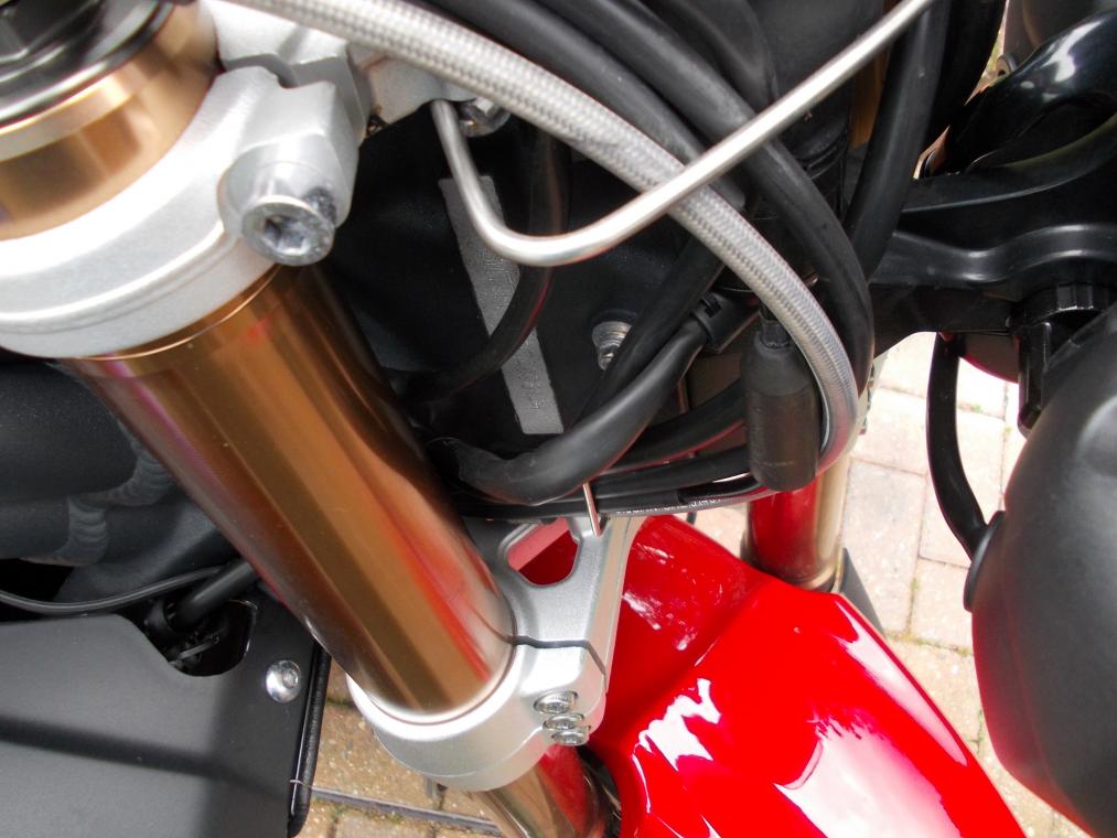

    Morning every one, All the lock stops are ok and it's never been dropped. What's happening is on Right hand lock the cable is bending at the places the cracks have appeared, I'v uploaded some photo's of it on full lock, (had to tape it up for now) The bikes 3 years old now so any one with a 2011/12 Speedy might want to keep an eye on it. Dont know what Triumphs going to do, It's out of warranty but still not a lot of miles on it, also if they replace the cable it's the ignition switch so they would have to replace the seat lock, petrol cap and the ecu because of the chip in the key. If it's left as is I think it's going to cause a few problems (Water getting in dirt etc).

    Hi Gerry after seeing your post and pics, I thought I would take a look at the state of sheathing on my bike.
    After close inspection I could see a scuff starting on the sheathing outer, it looks like the fork leg rubs it when using right hand lock.
    I have run some insulation tape along it to prevent any damage. Also the raised up piece on the frame carrying the frame numbers etc look like they could cause some damage if the cable passes and rubs, so I have stuck some foam behind to protect the outer sheath.

    Can't see why they would want to replace the cables as it is only a protective sheath - the routing of these can be a little tight and its worth j j j jiggling the cables every now and then to stop this sort of thing happening. An easy fix is some sparky's heat shrink that will cover it,seal it and help in the future. I do hope you find a triumph dealer that's more helpful soon as they are getting left behind in the new model stakes and good old fashioned loyalty soon wears thin IMO... Best of luck with the repair

    Thought about heat shrink but you cant get it over the connector block for the ignition and if you get the right size to clear the connector it would not shrink down to the correct size for the cables. The wires do'nt need jiggling they have plenty of free play, it's just that they bend in the same place every time the bike goes on to right lock (see photos). The thing is it's not often that it's on full right lock, only when parking, so it's not had that much wear & Tear.

    i have this problem on my bike, same model too, mine is caused by the cable rubbing on the edge where the chassis number is, its pretty tight when the bars are turned to the left, my bike has 3000 km's on it, just got it recently and noticed this, i had a similar problem with a GSXR with a cable on the steering damper, it wore through completely before i realised, not uncommon i guess,

    It's not a problem of too tight, on mine the cable outer has cracked where it bends on right lock and by the in fill panel on the frame tubes.
    Its got to be the material the outer sheaf is made of not being fit for purpose. (still waiting for my friendly help full dealer getting back with a reply from Triumph, that's if they ever got in touch with them to start with, and they are closed on a Monday :rolleyes:)
