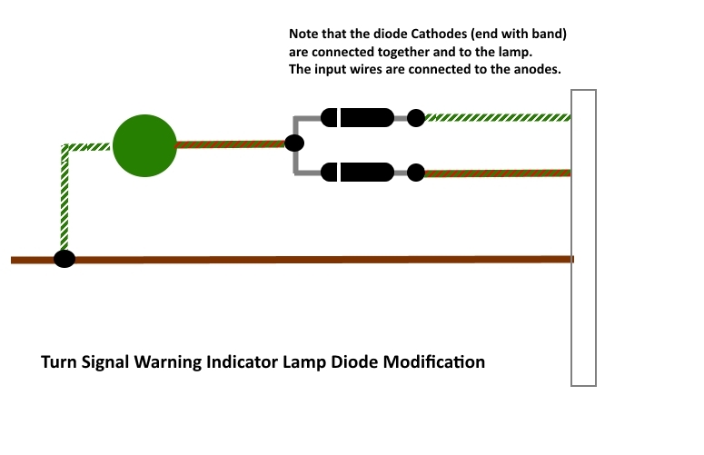

    You'll need a non-polarized LED - that is one that flows current in either direction (in essence it is two leds in same package)
    If you end up replacing the actual turn signals to LED at some point it will create further problems because of how that circuit to the turns indicator is wired (it is connected between the two signal)
    You can prevent both issues and use that polarized LED you have now, if you do the diode mod to the wiring to the turns indicator.
    Diode Mod
