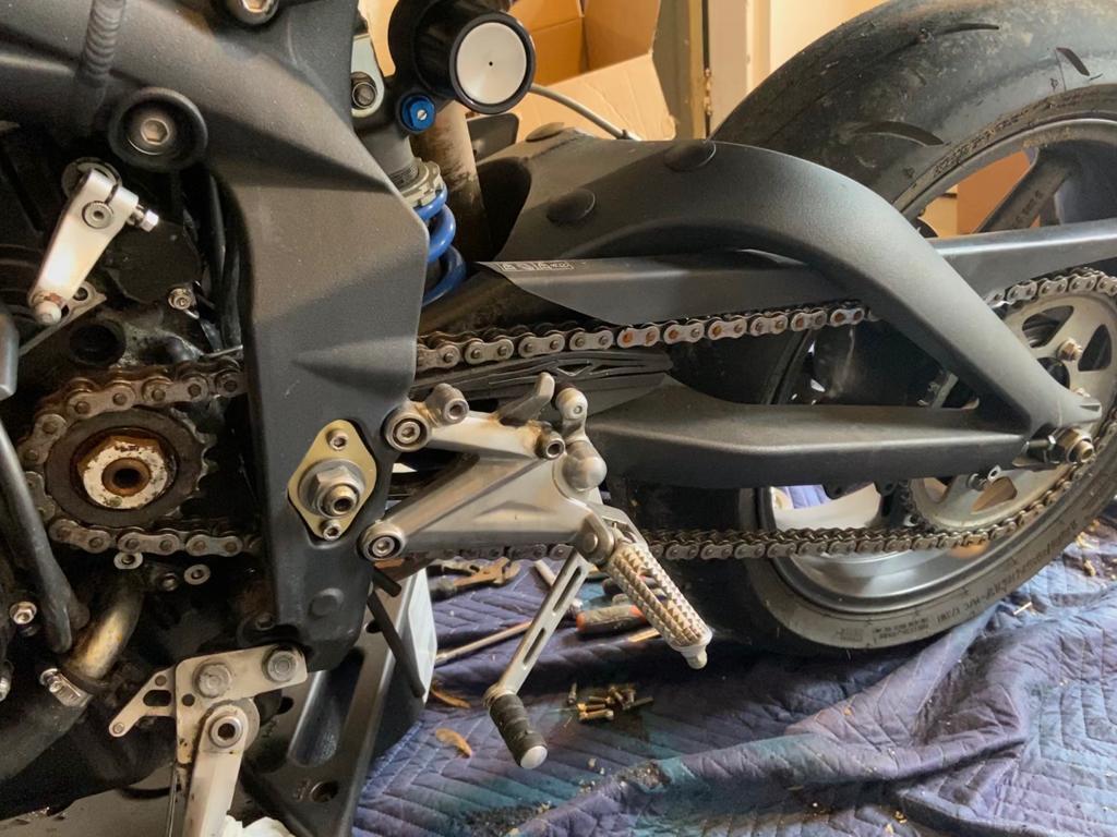

    1. if I put the bike into gear when it’s off I can still push the bike with no resistance.
    2. I checked the chain and sprockets, they are perfect.

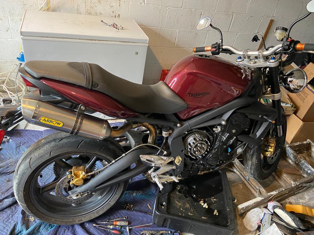

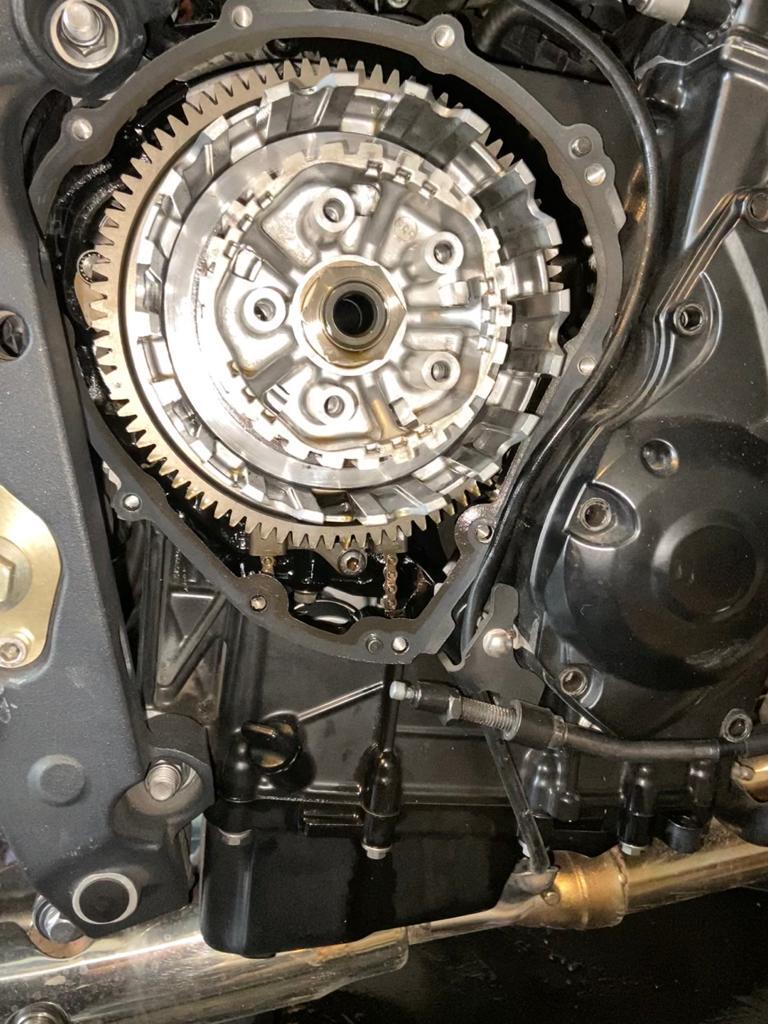

    Hey guys, here are a bunch of photos of my clutch plates, and the wear on my clutch basket.
    1. Does the wear on the clutch plates look bad?
    2. Does the wear on the clutch basket look bad? I felt across the worn areas and it felt mostly smooth, no deep gouges. should I change it/file it?
    3. Should I take the clutch basket off? is there anything to check behind there?
    4. If I buy new clutch plates, where should I get them from?
    Thanks !

    I will definitely look into loosening the clutch, but while I have it open and see that these clutch plates look pretty worn, do you think I should replace them?
  18. Yorkshireman
    3,401
    #18 Yorkshireman, Apr 11, 2020
    Good job on the bike there Mo. The clutch basket looks fine, those marks are to be expected on the inner and outer sections. As long as there are no deep grooves I’d leave it as it is. If you file anything down to remove any grooves you will end up with too much clearance when the plates are put back in and it will lead to premature wear of the new clutch.
    The friction plates look worn out from your picture and need changing. It’s critical to put them back in the right order so I hope you took notice of how they were originally fitted, (assuming they were right in the first place) and you must soak them in oil overnight before fitting them. As long as the steel plates show no signs of overheating or warpage they should be fine.
    Oh, and your bike needs a good clean and maybe a new rear tyre :cool:
    Best of luck.
    Ps. I wouldn’t go any further with the dismantling as there’s nothing behind the clutch basket that should need attention. Just spin the inner section to ensure it runs free with no nasty grating or grinding sounds and you should be good to go. The outer section is driven from the crank and the gear teeth look good in the picture.

    You might have adjusted the problem out but I agree you now need new plates and springs as Yorkshireman advises. YouTube is your friend!

    Hey guys, do I need a gasket for the clutch cover? When I took it off there was no sign if any gasket. If so, what is that part called?
    (see image)
    thanks again for all of the help, I’ll keep you all posted on if new clutch frictions and cable adjustment fix it.
