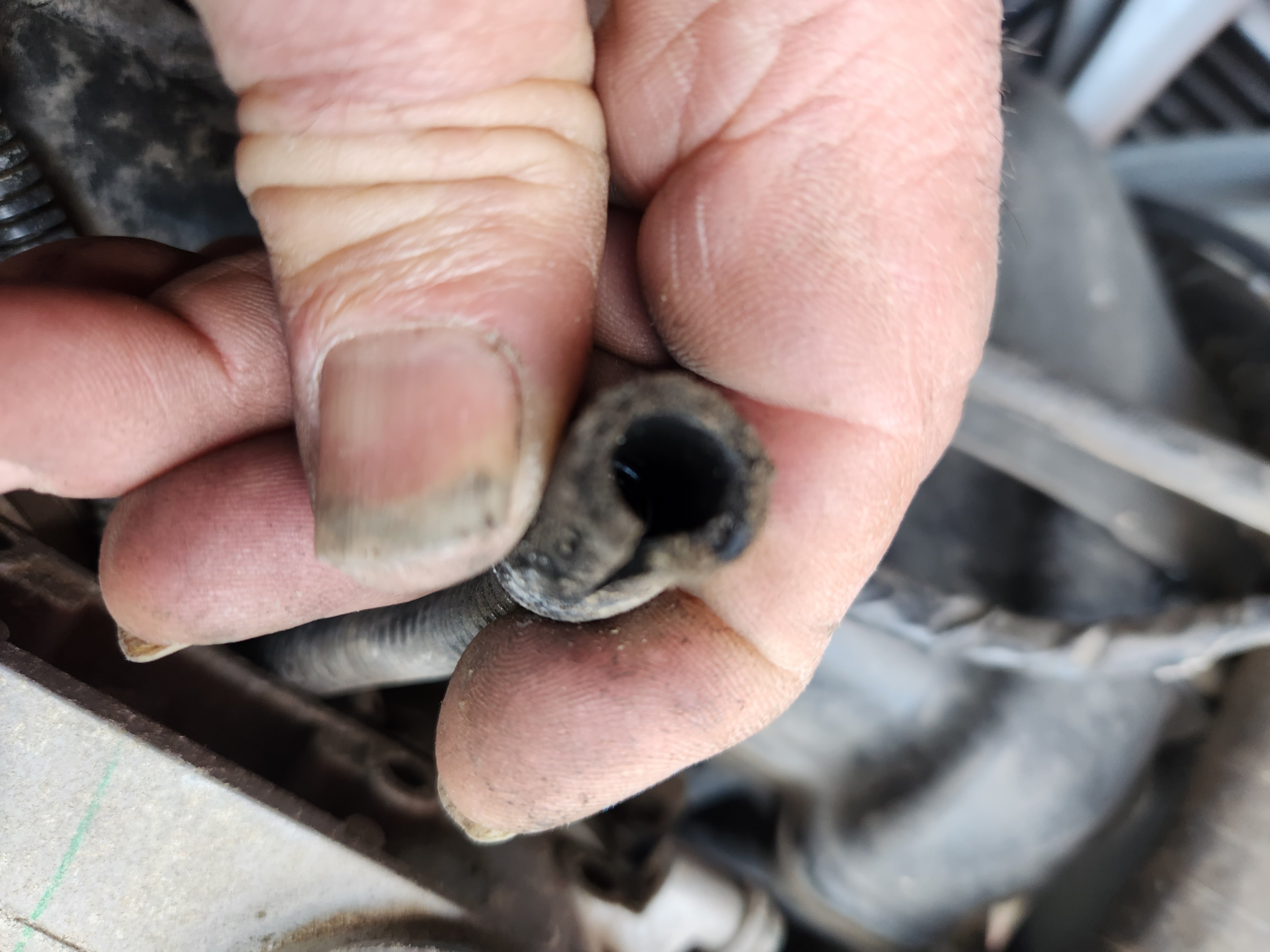

    Hi busy but finally got to have a look at the Sprint idling issue.
    What I have found is the rubber to plastic connectors for the lines from the air control valve to injector bodies have completely failed.
    I have a another bike for parts, so thought I might be lucky to find they would be ok, but alas they also had scummed to time.

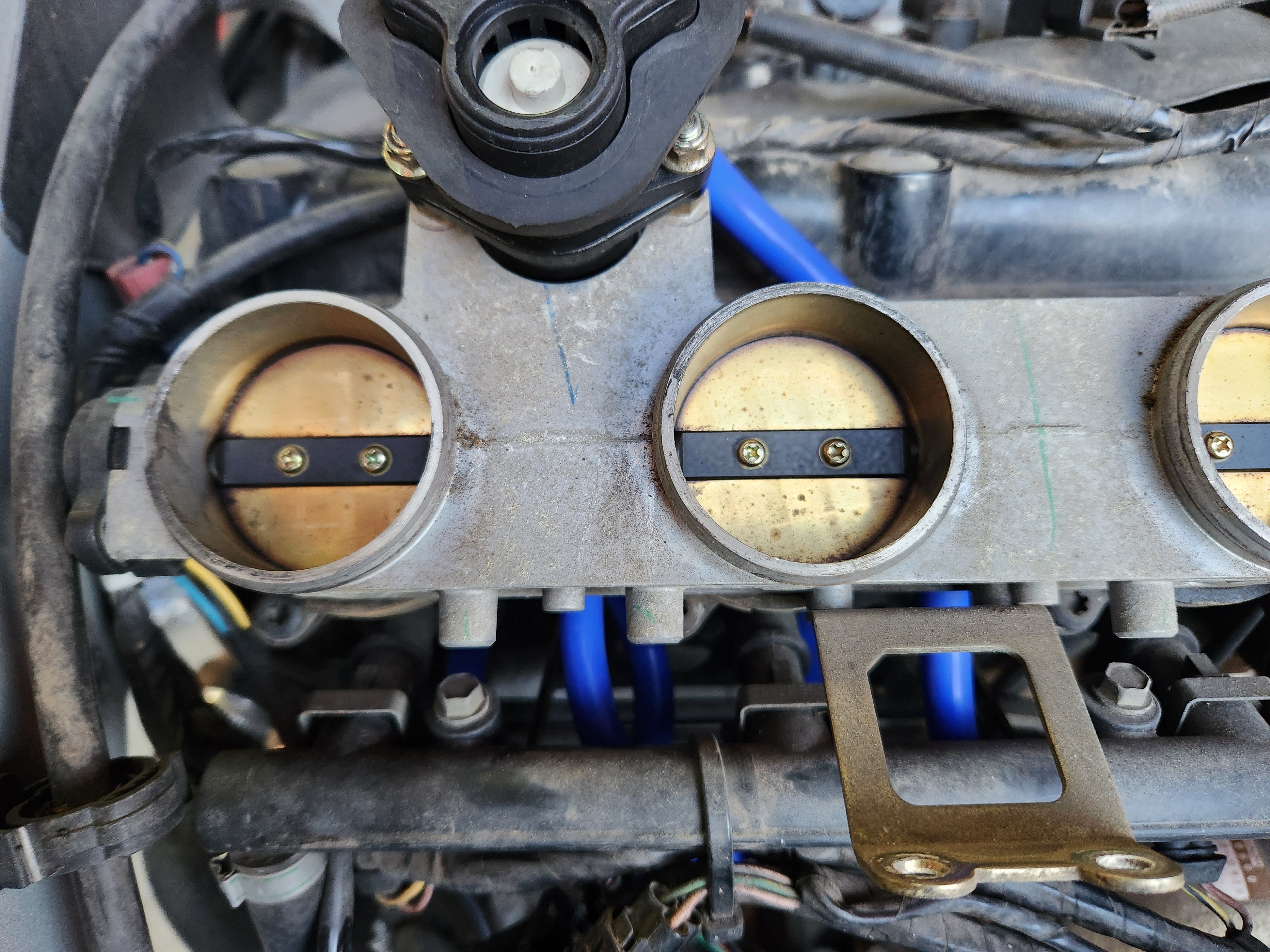

    Replaced the old lines with high temp Silicon vacuum hoses.
