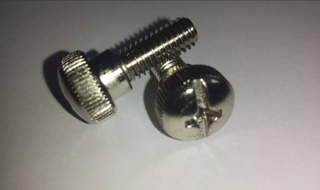

    can anyone explain how to remove my front seat please ........I cant find clips or bolts that look relevent
  2. SamTheExplorer
    Nov 26, 2017
    56
    Cambridge, UK
    Hi Mike,
    The rear seat is removed using the key. The front requires the removal of two bolts into the seat rails holding tabs at the rear of the seat.
    I hope this helps...
    Stay safe!

  4. Mike in it
    Mike in it Member
    Nov 30, 2020
    52
    London/Essex
    Thanks Sam , thats just what I needed

    No link or affiliation but there are helpful options such as these available from well known online auction sites (and surely found cheaper elsewhere?):

    When you take them clips off Mike and then you're finished and come to replace everything you need to spend at least 7-8 mins wondering where the feck you put the buggers!
    I can never find where I put them down, but I always, ALWAYS find them in the last place I think of looking!

  7. Mike in it
    Mike in it Member
    Nov 30, 2020
    52
    London/Essex
    Ordered these , thanks Sam

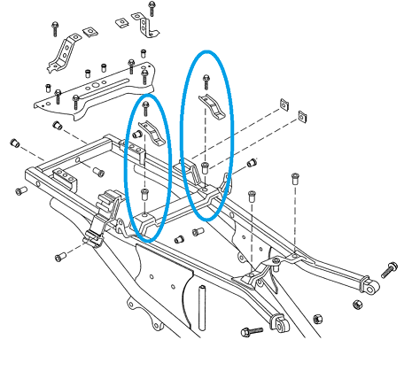

  8. Marc Beale
    Marc Beale New Member
    Feb 22, 2025
    Masterton NZ
    Can anyone supply a part number for the circled bracket/ keeper ? Im missing one
    Might have to make one yet ?
  9. sprintdave
    May 25, 2014
    1,713
    Birmingham
    T2072645 but fowlers and W.O.T. don't have any in stock. Try a Google search or
    Triumphhinckleyparts.co.uk
    National Triumph
    Or ebay
    If you need part numbers just go to either fowlers or World of triumph site, go to parts, enter your bike and go through the assemblies, you will find the numbers there.
