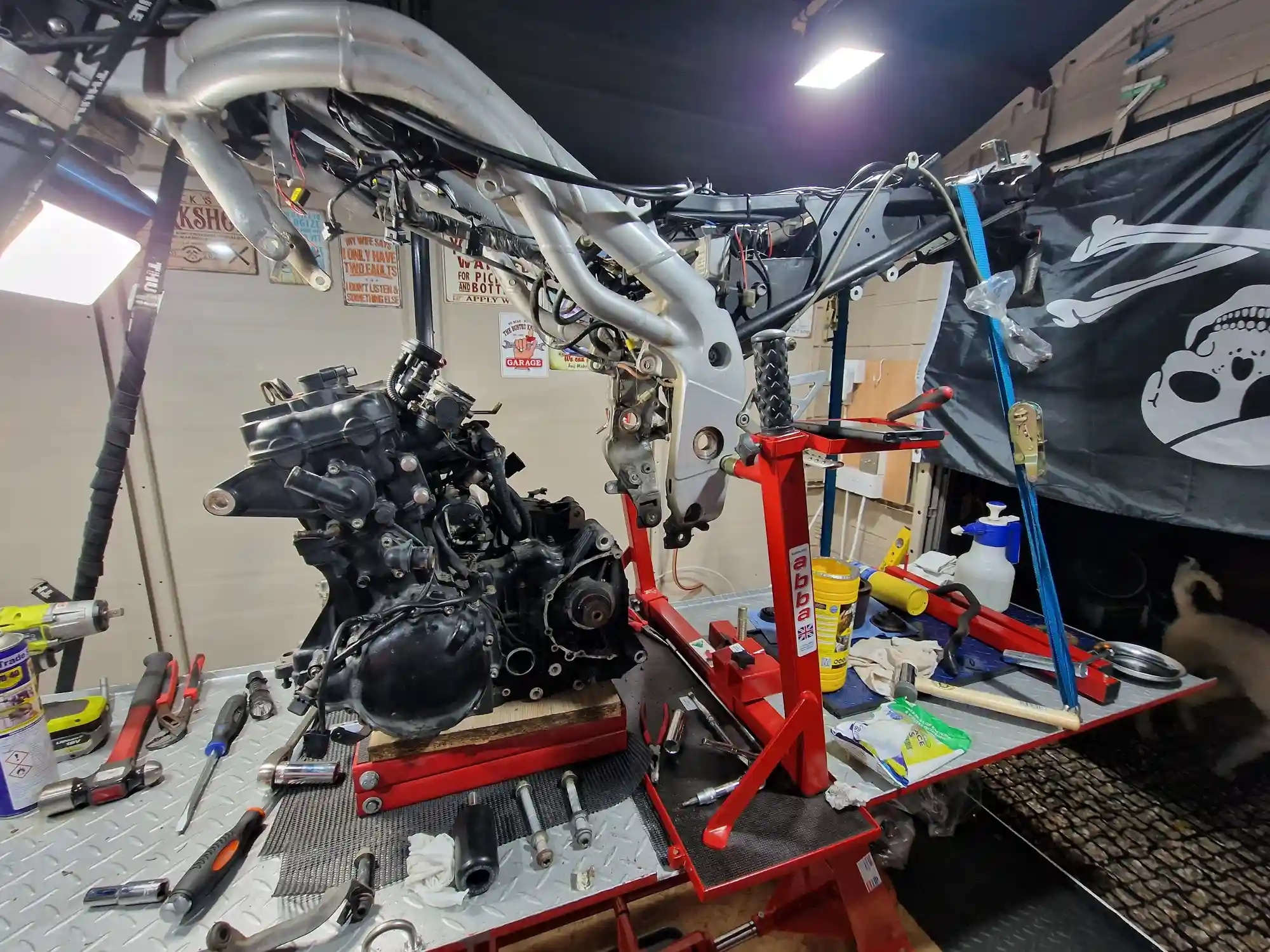

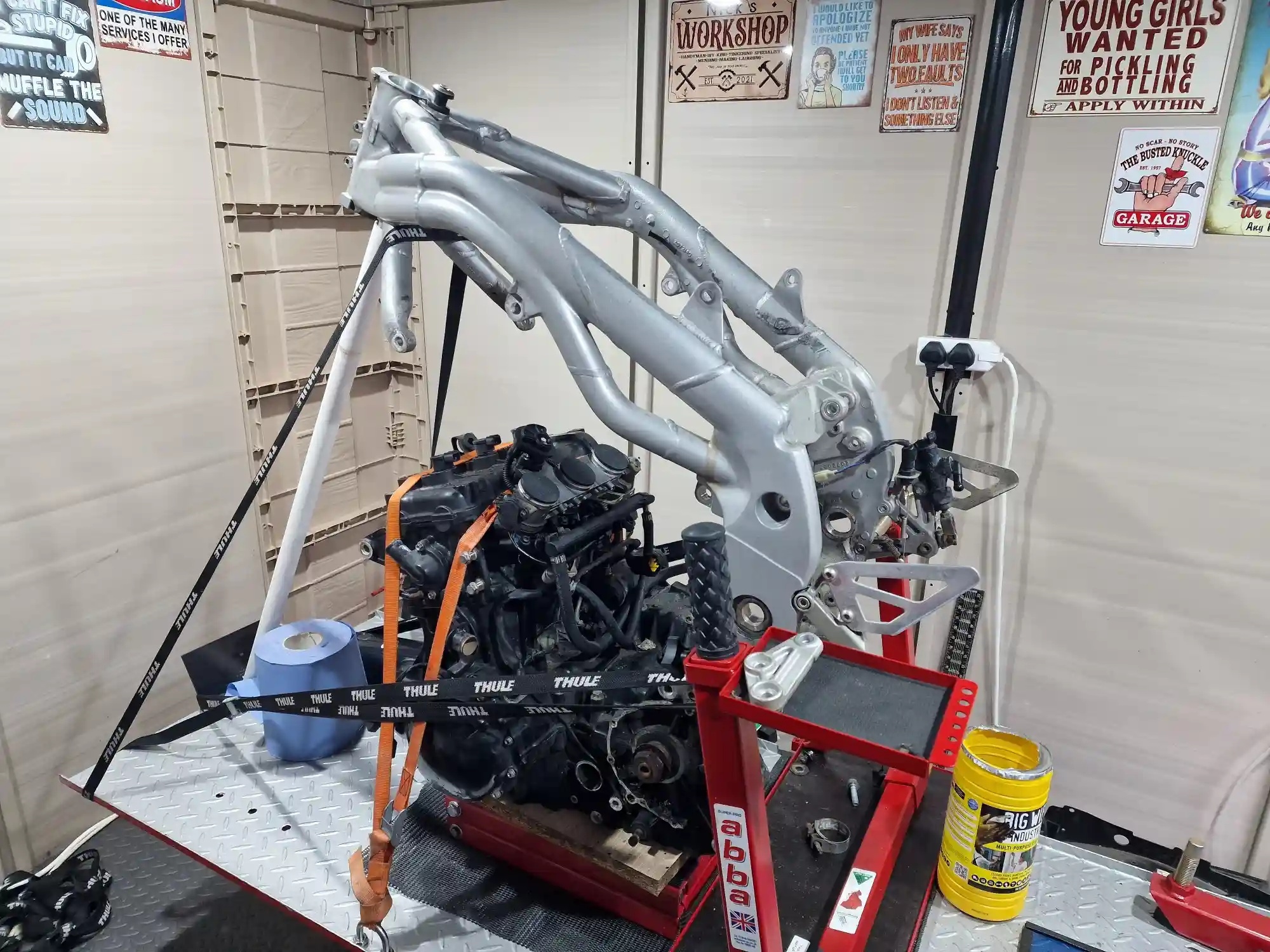

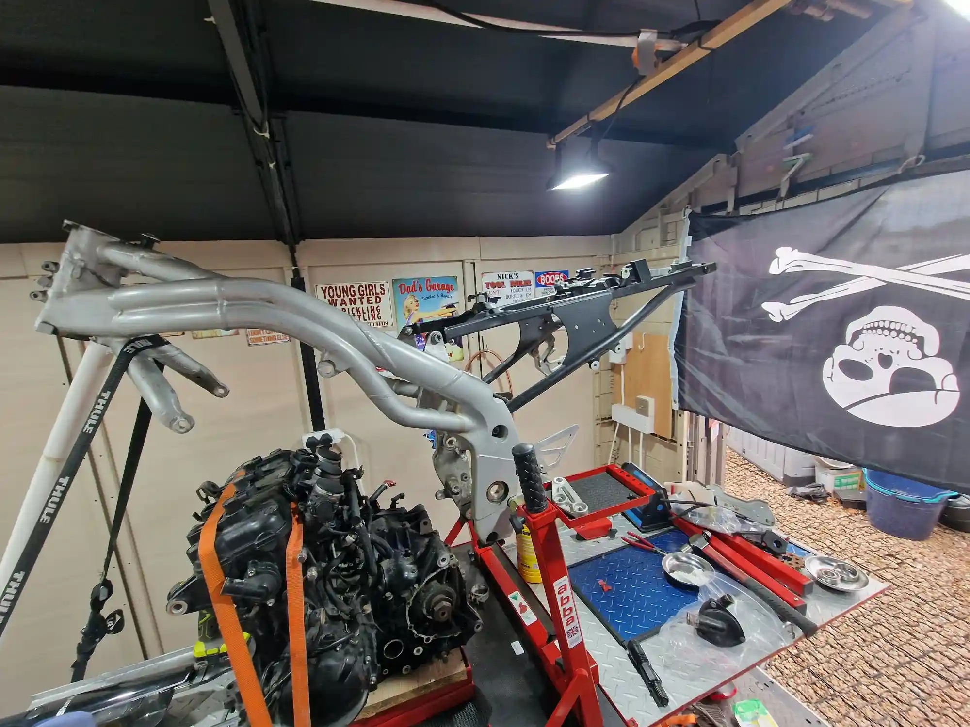

    So it went onto the ramp in my little hideaway
    Bits started to come off it
    More bits came off
    The exhaust studs were a problem
    But after hours of swearing I did eventually get them off without shearing any studs
    Dropped the engine out
    Cleaned off a lot of the corrosion and flaking powder coat off the front of the engine. (actually I did that after I took this picture)
    The powder coating on the engine has not fared well over the years...
    Stripped the wiring loom out
    Im just going to throw this out here.
    People tell me the ABBA skylift is a better stand than the normal ABBA stand.
    Well strip a bike like this on a skylift and come back to me...

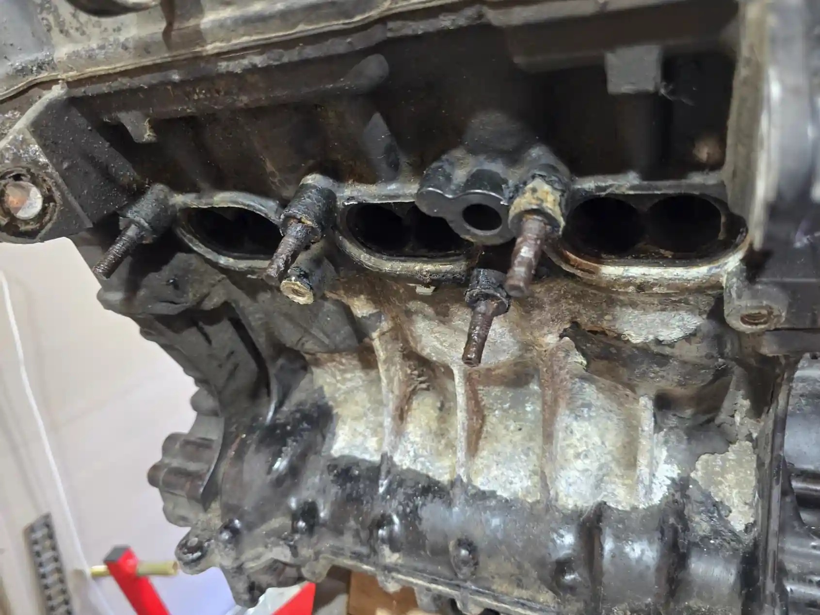

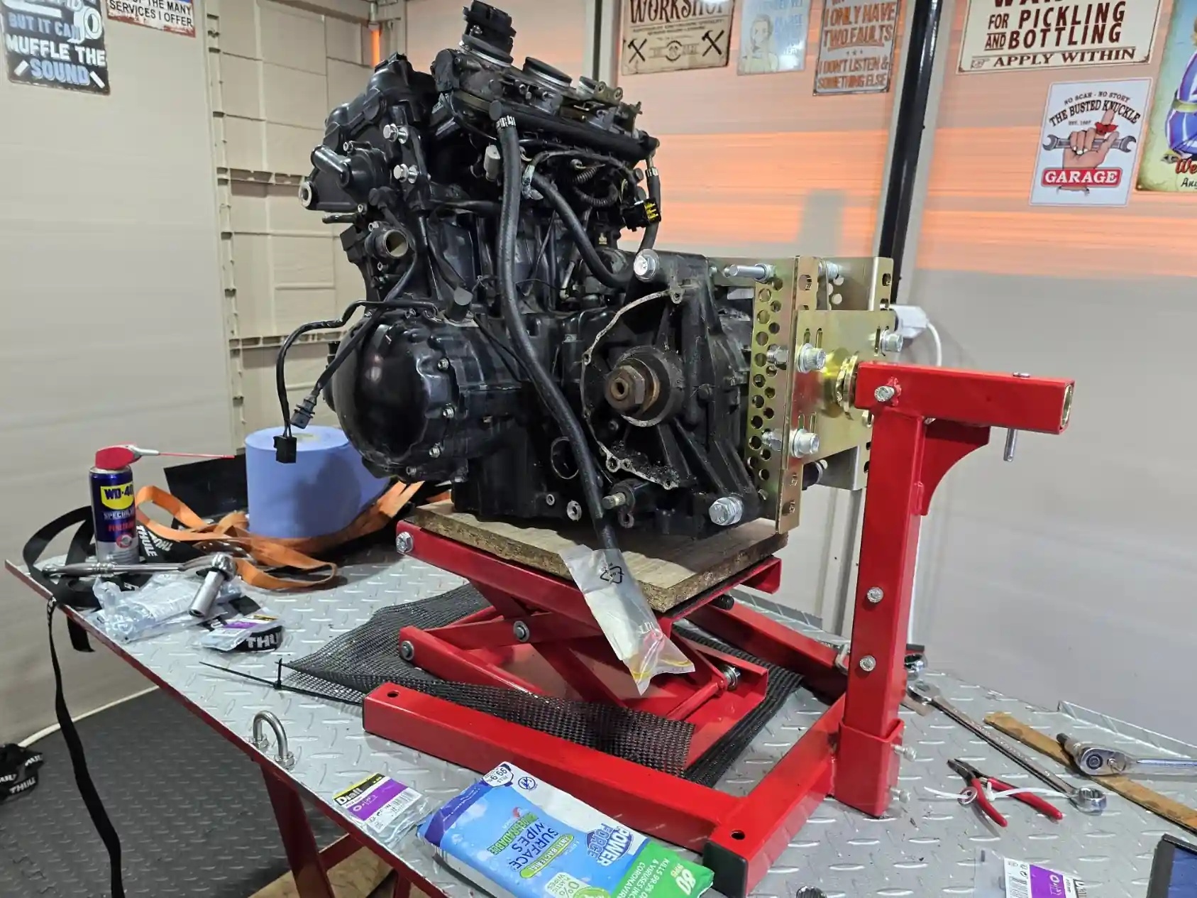

    So where Im at right now is this, with the engine on a work stand with the rest of the bike on various shelving systems.
    And Im trying to figure out how the fuck Im going to get these exhaust studs out...
    Ive been soaking them with penetrating oil for days and Ive managed to get 2 of them out in one piece with heat and a stud extractor and a bit of shouting at the dogs.
    The remaining stud on cyl 3 did move today, so I think I might be able to get it out with a bit more coaxing (but its still in there at the moment) which leaves the middle 3.
    The pictures dont really do them justice... they really are shit... the one thing I have in my favour is I have no time limits, so slowly slowly catches the studs in one piece.
    I think thats the saying anyway.
    So if anyone's got some good ideas or suggestions on how to get the rest of these bastards out please, I'm all ears here. All advice welcome.
    Except for cutting them flush, putting a washer over them, welding the washer on, then welding a nut on.
    Because I dont have a welder.
    Although... if I save for a couple of months and dont tell the wife, its a good excuse to get me one...
    I REALLY don't want to end up drilling them and re-tapping them or using heli coils. I just hate doing that so much... its just the worst job...
    If that does end up being the only way because they shear off, I'll leave rescuing them until the head is off so I can lay them flat and work on them from above.
  4. feckless
    feckless Noble Member
    Apr 16, 2019
    1,047
    Cumbria
    nice work, i think you are doing the studs the right way. i cant think of a better way, just heat n patience.
    i have just replaced the exhaust studs on my tiger 900 with stainless items so i dont have the same problem at a later date. my bike is only 2yrs old and they were a right bastard to get out.
    my stud extractor was useless and head to get them out using 2 nuts and plenty of heat as they have good thread locker on them
