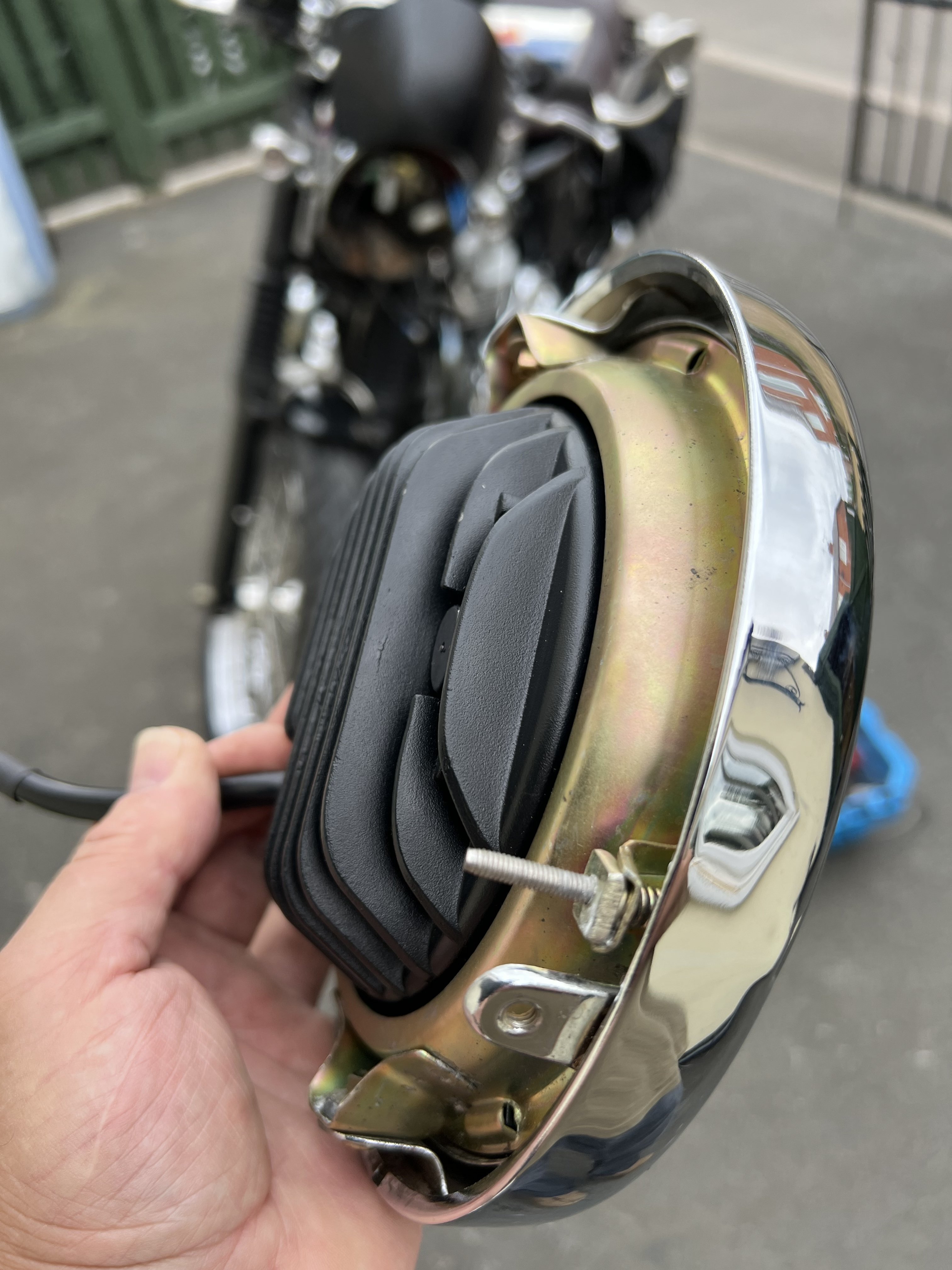

    Hi all just fitted a LEDperf LED headlamp to my 2003 Triumph Bonneville 790cc, been looking at them for a while and today took the plunge and fitted it. The headlamp was easy to fit even though there are no instructions at all, just remove the old headlamp from the assembly and fit the new LED headlamp in ,there are a few screws to undo, 2 with rubbers but they can’t be mixed up. The lens is easily scratched as I’ve found out so always keep a soft cloth handy to rest it face down on, all in all an easy job. Connect the white wire from the LED to the side light yellow wire for a white halo or to the yellow wire from the LED for a amber halo
    I ordered the headlamp from their site and it was posted from France within 24hrs I received it 3-4 days later.
