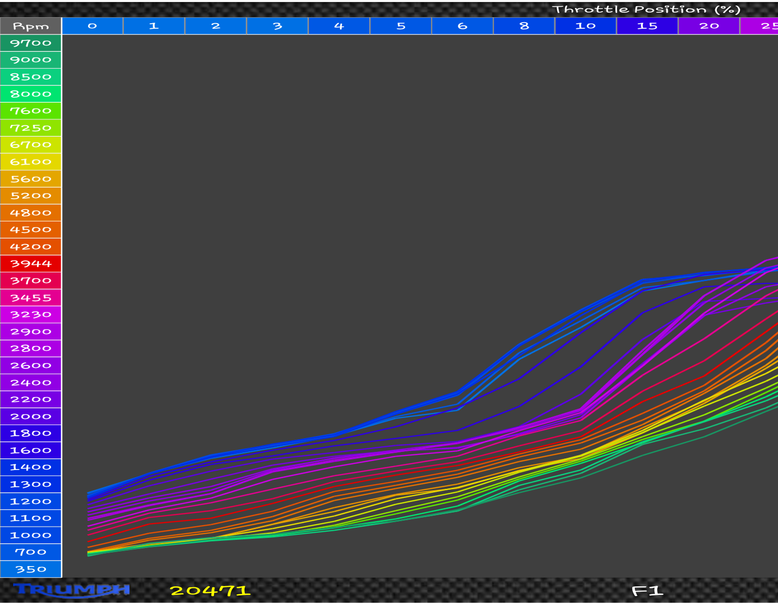

    Nosing with TuneECU last night I noticed that the OEM map has a big dip around 2000 compared to the Arrow slip on tune which is a lot smoother....
    Arrow....
    Standard....
    Might throw the arrow one in and see if the hesitation is still there....I appreciate it may run a bit rich but be nice to see if it still happens with a map without the dip in...

    Hi Jody ref the OEM map - do bear in mind that the dip slight dip you refer to is not just at approx 2000rpm but also at 5% throttle opening. This is where the ECU is swapping between AI system operational/closed and between the two tables of values.
    As interesting as it may seem I don't believe this is the source of your problem.

    I get what you are saying but If I try the Arrow map with a smoother looking F/L switch and it stops then I know the issue is with my standard maps F/L transition...
    If it is still there then I know it is hardware related
    Both maps have a F/L transition value of 4 across the whole rev range
    Is this value definitely displayed as throttle % in tune ecu ?
    Some Triumphs have the F/L value as high as 31 which would be a bit high for throttle % I thought ?

    Threw in the Arrow slip-on map this morning
    Rode to work and the results were....
    1 or 2 misfires around 2000 (when using too high a gear after rolling up to a roundabout and deciding not to stop) so that issue is still there
    But....
    Part throttle cruisung is smoother
    MPG on the dash shows higher sat at 55mph than before
    I can pull away from below 2000rpm and there is only a very very slight hesitation, nothing like before
    So in conclusion I probably have got a coil related issue which the fuelling on the standard map must have highlighted more....
