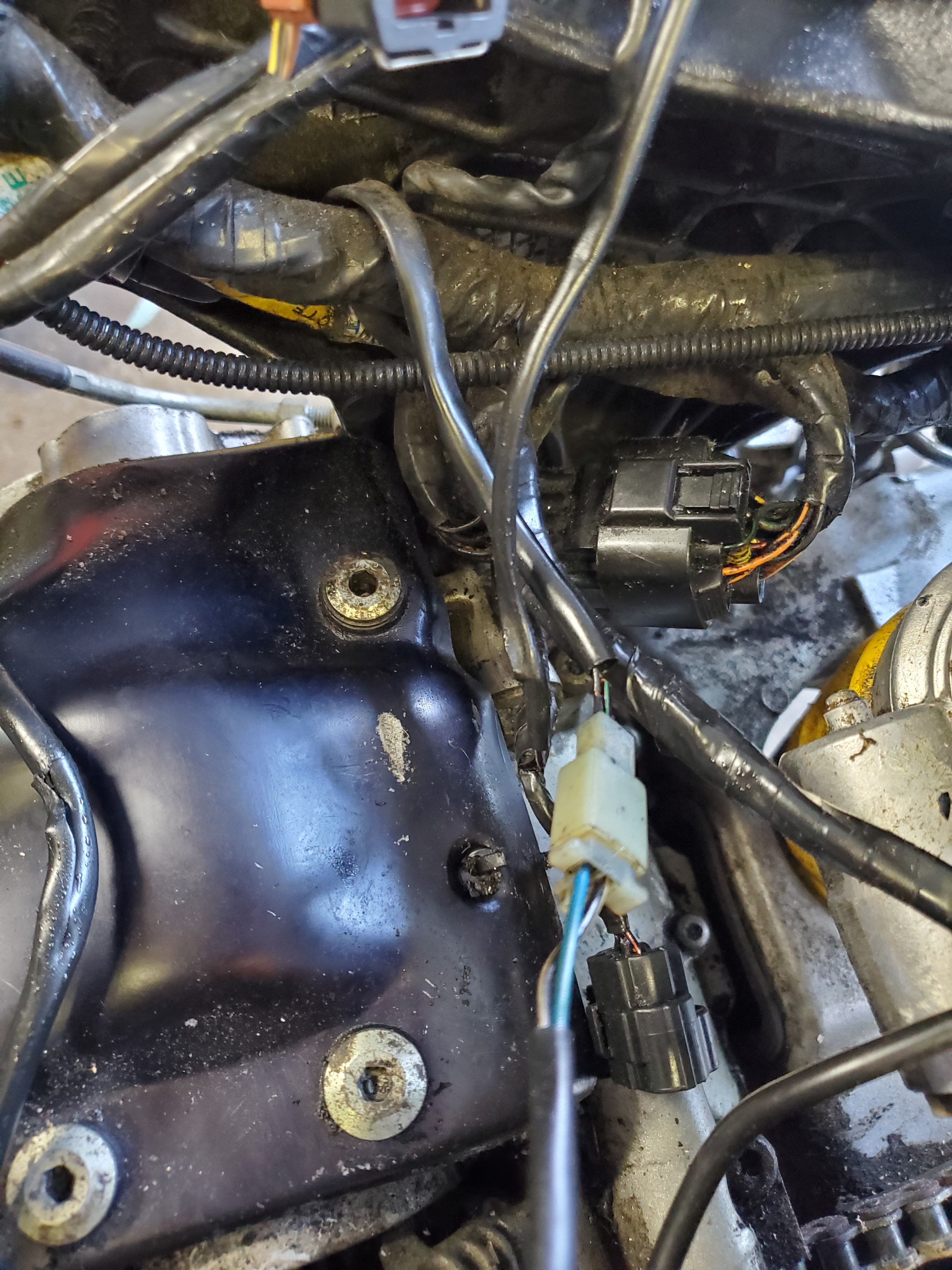

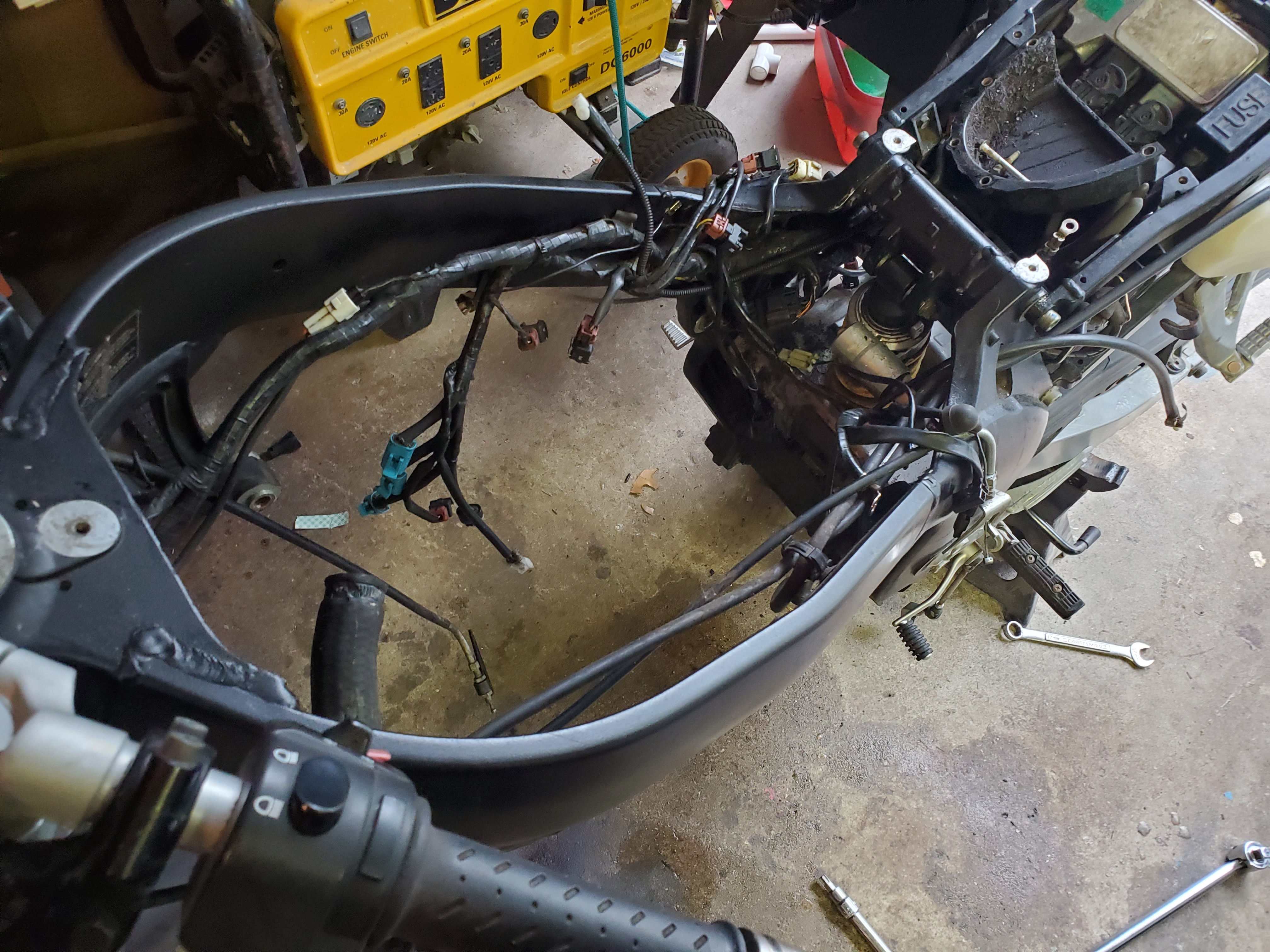

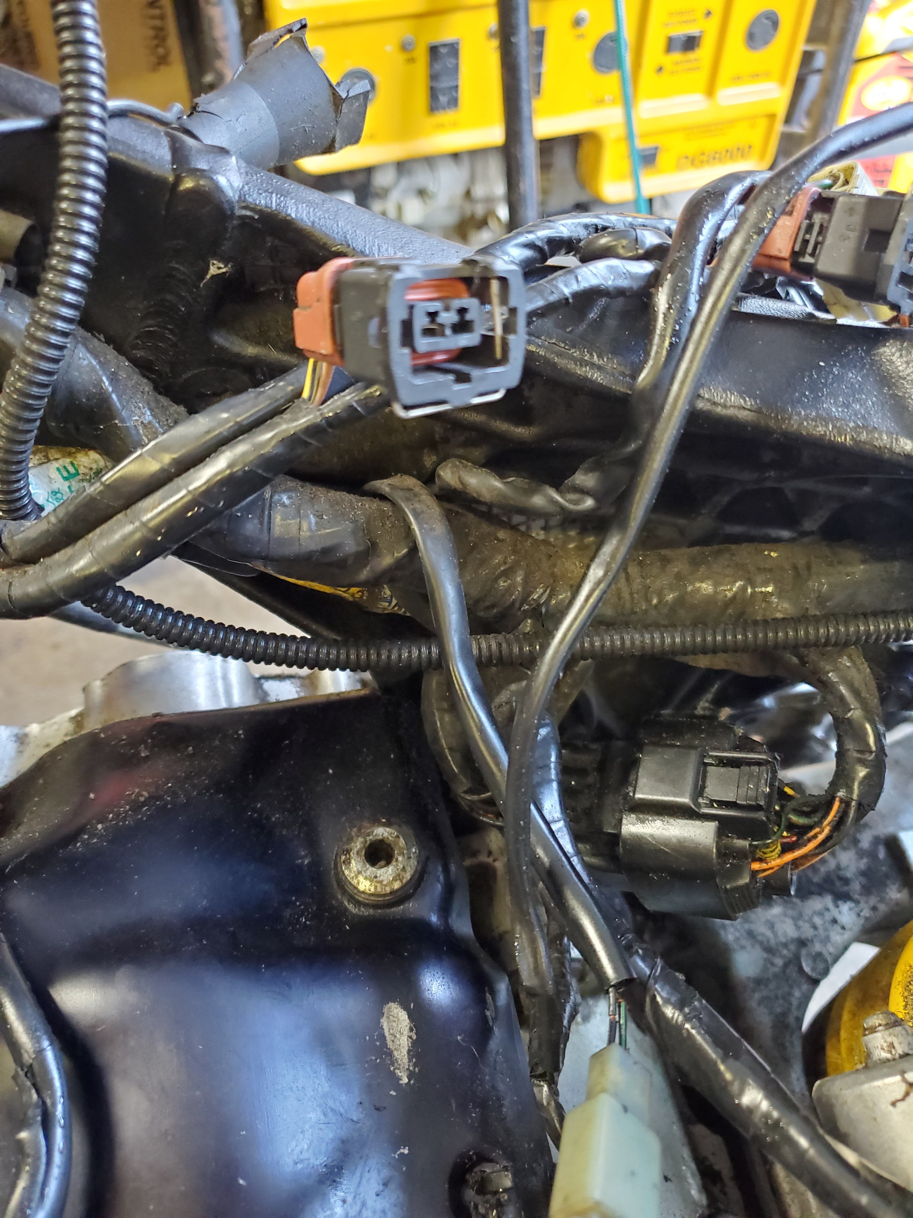

    Its me again! Lol. Stressing you folks out yet? I am ready to lower the motor out of this puppy and have a friend coming over Sunday to help me do so to play it safe. Everything looks to be good and disconnected. While removing all the connections I stumbled across this little gal and I dont see any missing connections and or places where it may have been spliced in. Kickstand switch and neutral switch I think are accounted for. So not sure where this belongs. I did not remove this connection, I simply stumbled across it. Sadly I got the bike not running so I can't use previous misfunction to trouble shoot what isn't working.

    Looks like what's left of the low fuel indicator sensor connections. Check the fuel tank bottom to see.

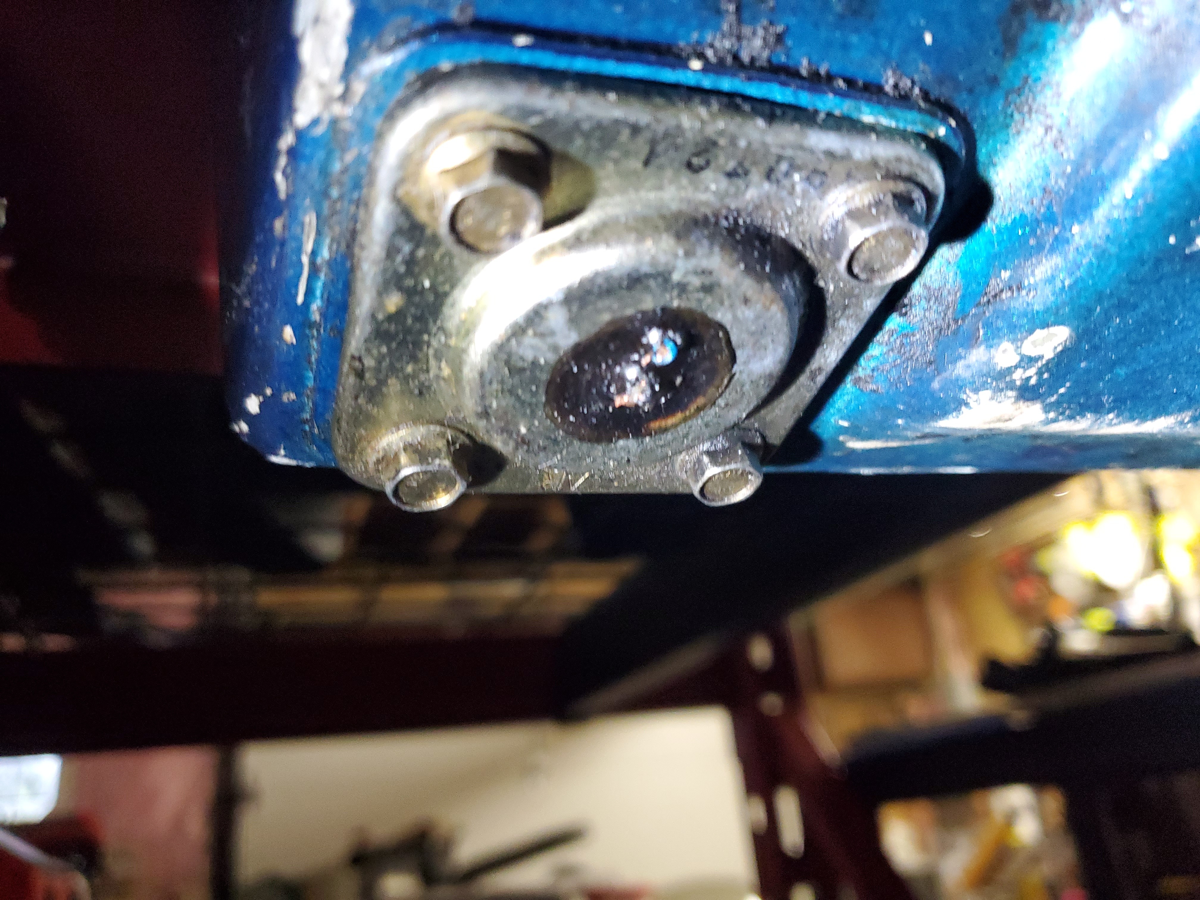

    DING DING DING we have a winner! There is so little left to the ones coming out of the tank I missed it on the first once over. I took that plate as a bung or something. Then after your response went back over it and you can feel a few copper strands poking out of that sealed area of the sensor. What a weird way to do it! Just two copper wires sticking out. Im assuming thats just for a low fuel idiot light right and not a shutoff of any sort?

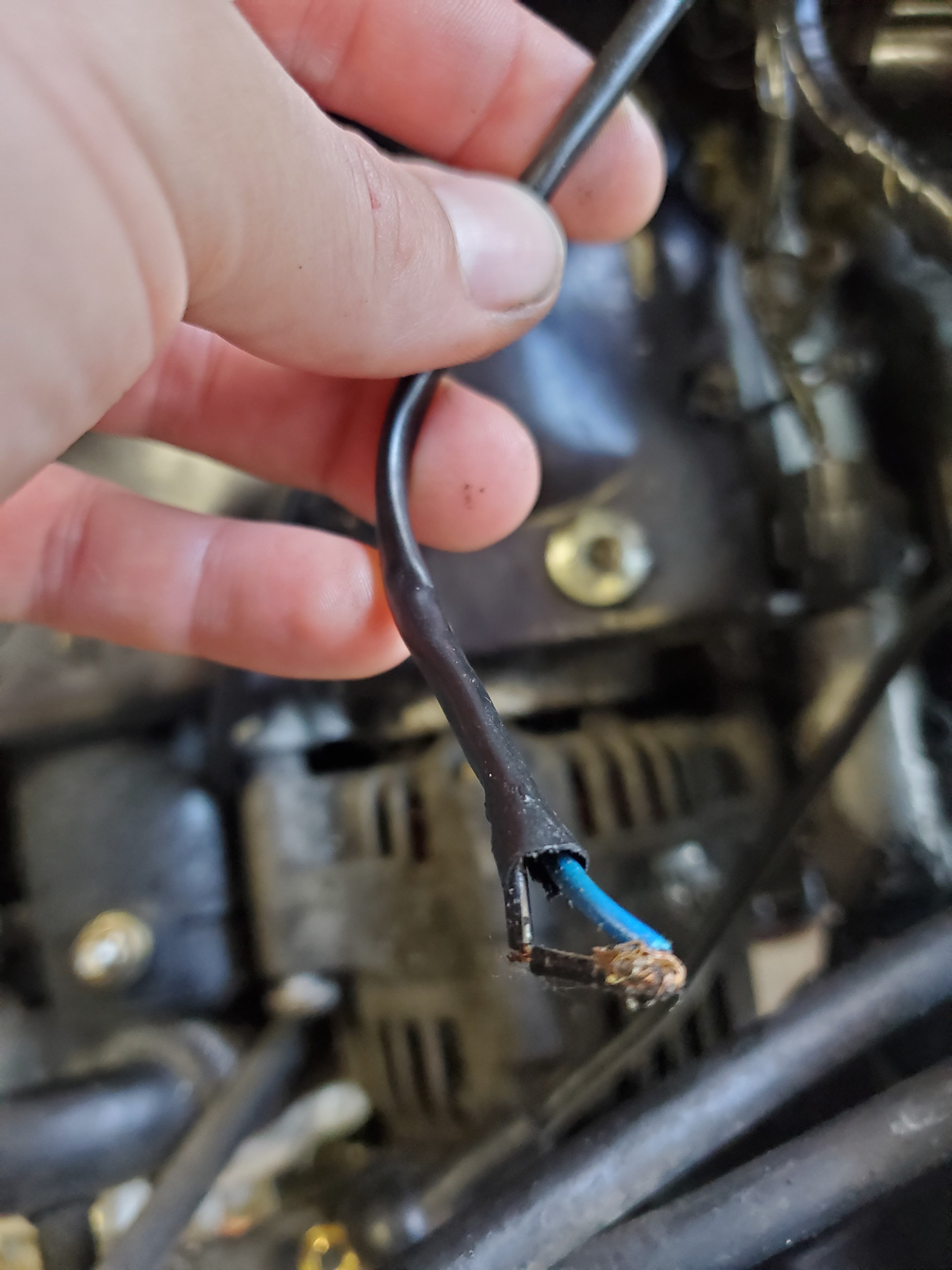

    I wish but he was correct. They were broken off at the sensor and there is no possibility of reconnect :( So I have to replace that sensor it looks like.

    Yeah I've got plenty of those connection to redo for sure hah. But the one in question is white that I show in my first pictures. The problem area is here on the tank. They literally broke right at the tank. :( But I'm at least happy someone was able to tell me to look there lol

    The low fuel indicator will not cut anything out, just it lights the indicator on the dash. Tape them off or, unplug and discard. I filled the bottom of the tank with epoxy to seal things off. Not positive it makes any difference. No worries.
