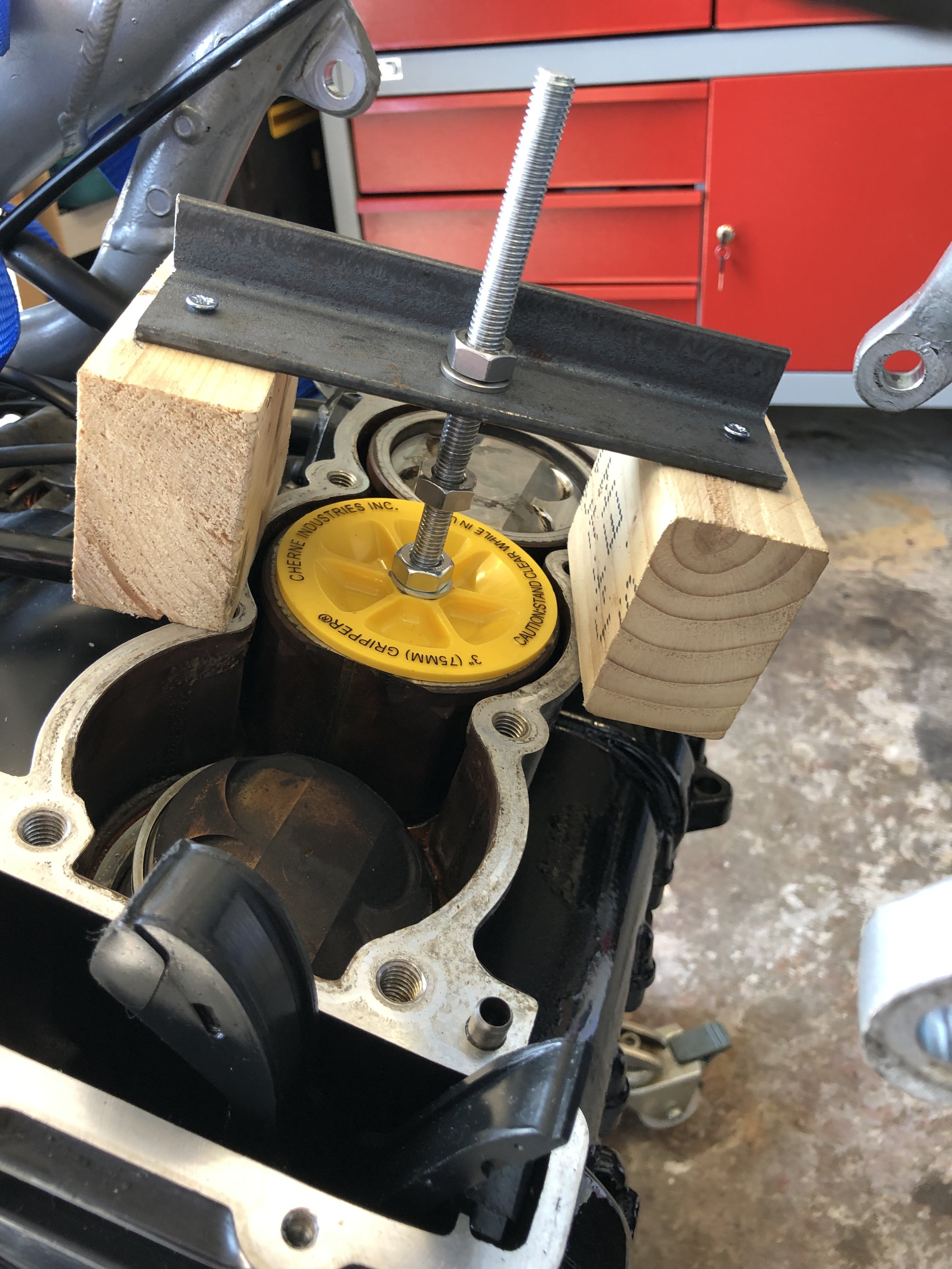

    The only other resources I used were a variety of posts on this and Triumphrat forums where I got information on making a homemade liner puller. (shown below).

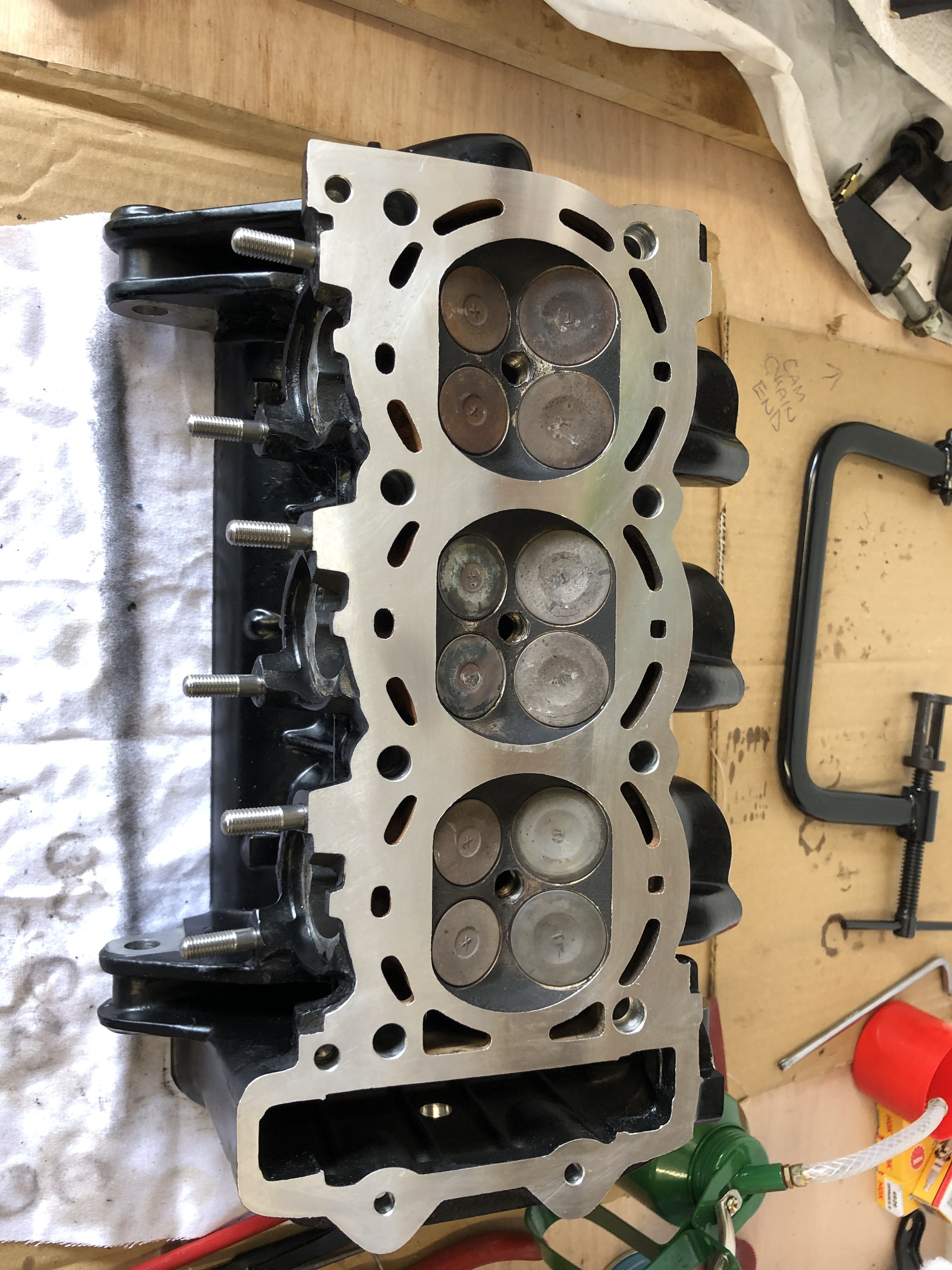

    A couple of tips I would definitely give you. First is to invest in a set of top quality Torx sockets; the head bolts need a lot of torque to undo and then refit. The other is to have the head skimmed. Mine was a couple of thou out and there were a couple of areas where water jacket corrosion had occurred; the skimming got rid of this.

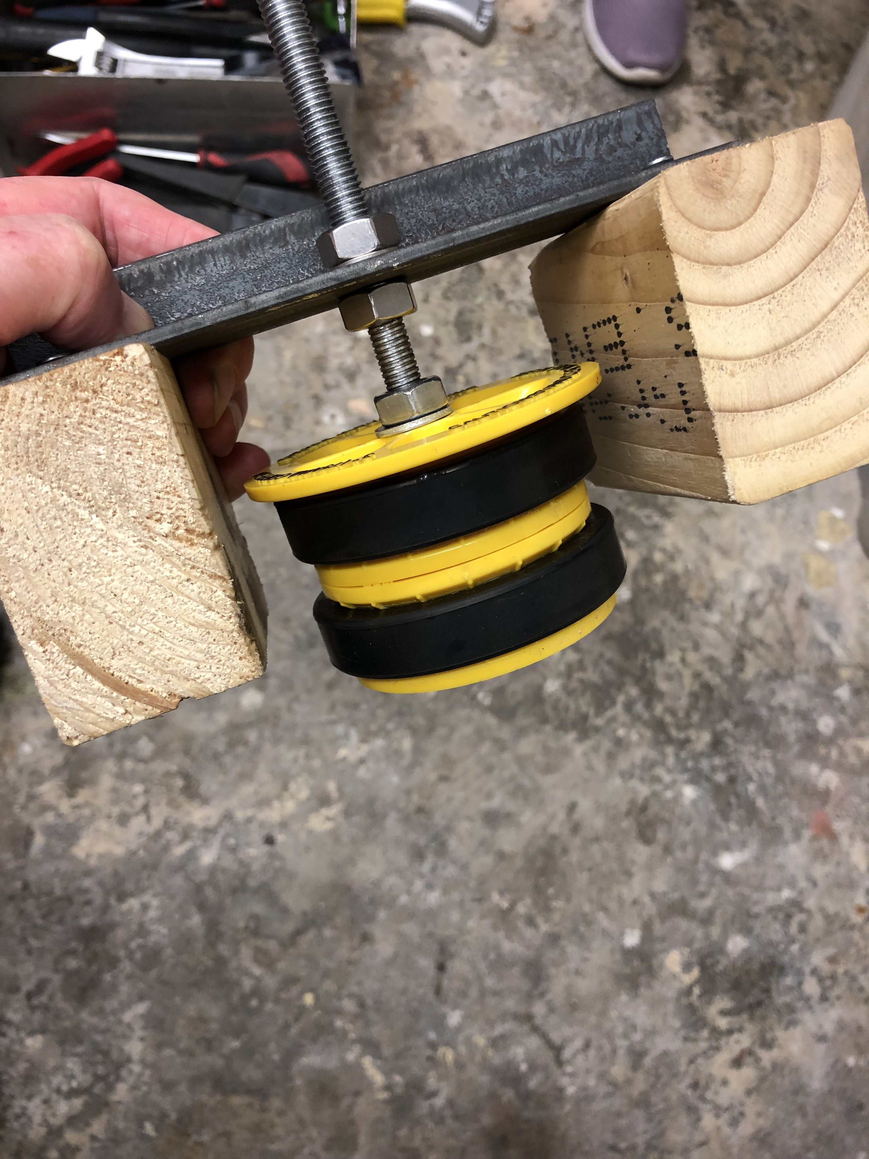

    So sealing them, effectively means coating the outside of them that contacts the block and putting them back in? What are we using as a sealant and what is that fancy yellow part you are using for your DIY remover? lol

    The liners are sealed with Hylomar silicone sealant or similar, applied below the shoulder. It shows you in the manual how to do this.
    The yellow tool is a homemade puller I used to get the liners out. It’s actually made from 2 pipe plugs from a plumbers merchant.
    It’d certainly be an easier job with the engine out but it is doable in situ, just a bit more awkward.

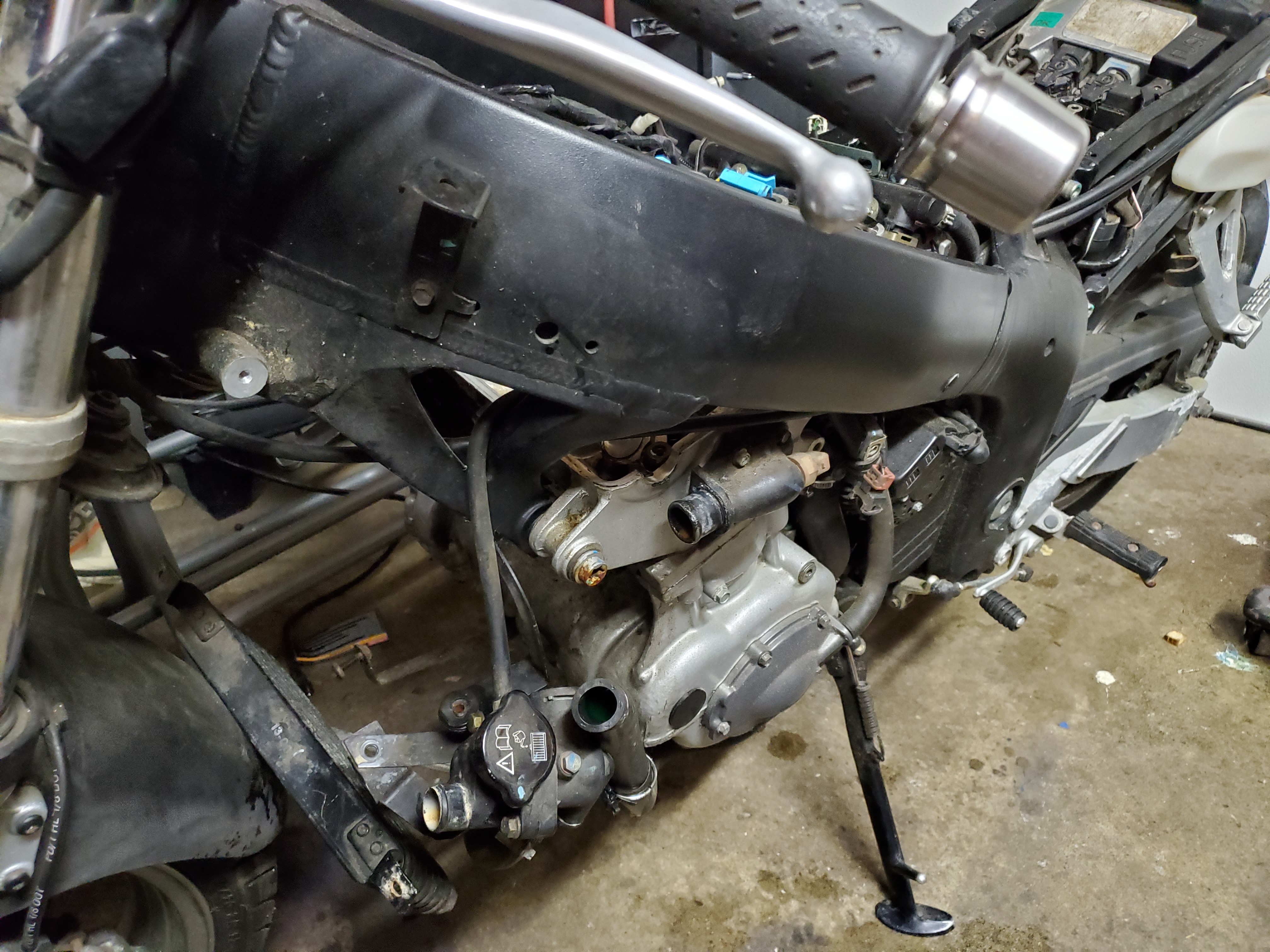

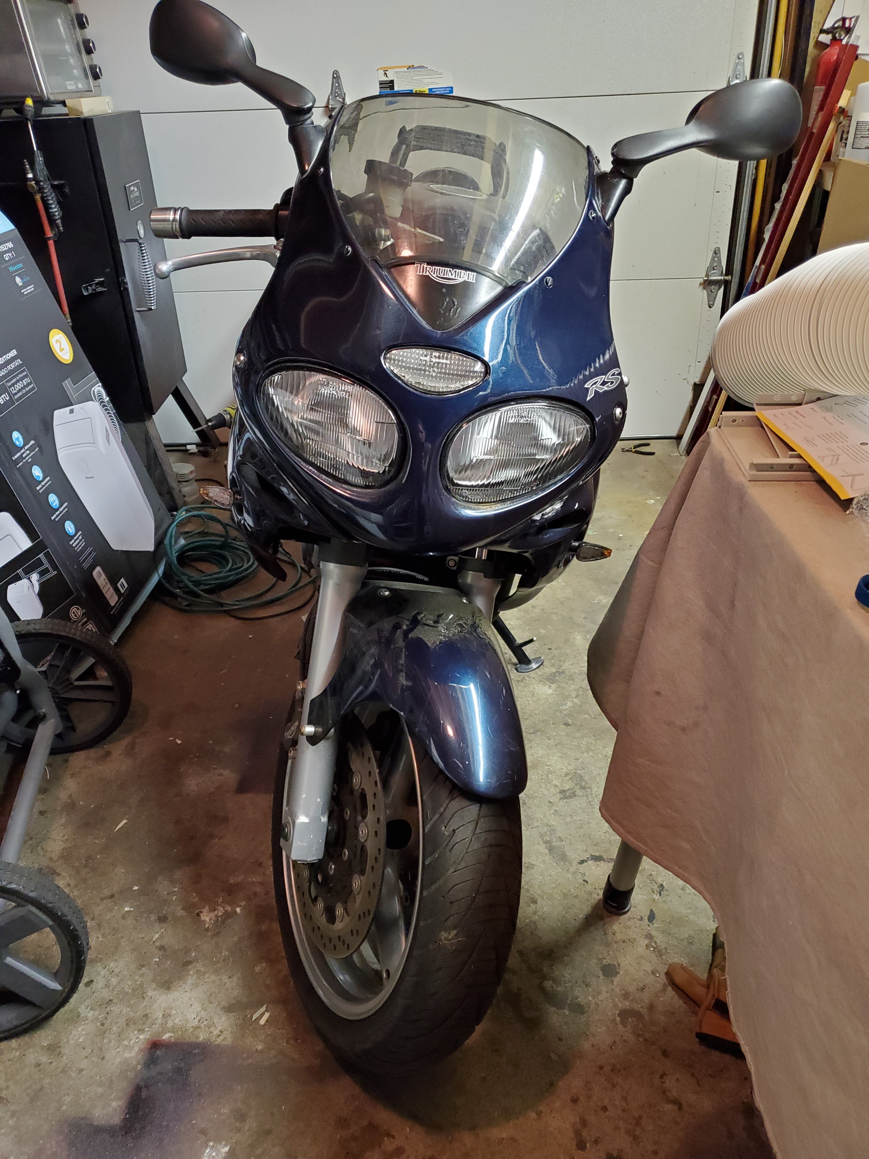

    I'm throwing in a few pics of the bike last night and its current state lol. I got this bike from a friend of a friend. The guy said he took the head off to repair it and saw that it was scored. I had no knowledge of where or how bad but took the bike anyway because as I said in my intro post, I did get the bike with a nice replacement head, and cams. The bike is 20 years old and in fairly good shape....minus the jacked up head. I've got her all apart and almost ready to pull the head. Just have to remove the two large bolts in the head supporting the engine and the smaller torx bolts for the head itself. Cam cap or clamp (forgetting the correct term) on the exhaust cam closest to the gear is in bad shape. And so is the surface of the head. I dont imagine reusing this head and clamp is possible? With a machine shop resurfacing perhaps or is it too far gone? Either way if that isnt possible I can swap the heads for the other (fear there is that its not ok to use the replacement cam clamps on the new head because the ones it had were not included) thoughts?

    Hi Freck,
    How did you find the access around the pistons for cleaning the liner’s sealing face after they were all removed?
    Keeping the crud from falling into the engine must’ve been an absolute nightmare?
    I’ve just made a similar puller and cannot budge mine at all, even with ‘significant’ pull/force, they are seriously locked in, making me wonder whether I should just leave them well alone and refit the head? I was only removing them as a precaution to leaks.
