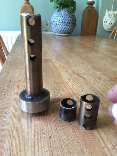

    Well the saga goes on, baffle in, too quiet, baffle out noisy but I don’t like the sound so I drilled an extra 4 holes in the baffle but no noticeable difference so took an inch off the end, slight improvement so took anothe couple of inches off
    I think I might have got there
