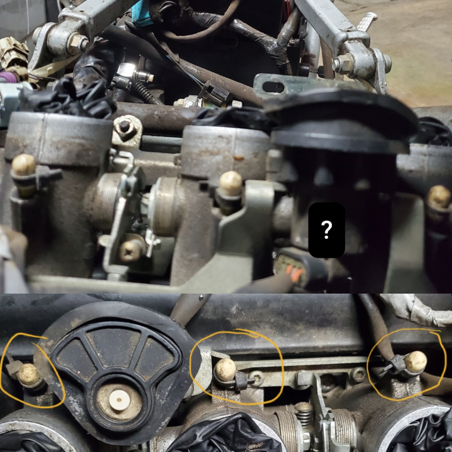

    Anyone have any idea why the previous owner would have capped off the throttle body connections to the stepper motor? Would this have caused the cold start issue? Since I've owned the bike I had to supply some throttle to start & until warm so that it would idle.
  14. Col_C
    Col_C I can't re...Member
    Aug 5, 2015
    1,438
    OEM pipes were corrugated plastic and would split causing problems. I would suggest reinstating with rubber vacuum pipe.
    However cold starting issues is also a classic symptom of valve clearances closing up. Some years back I had a 955 SprintST, developed rough cold start, all inlet valves had zero clearance, they'd supposedly been checked a couple months previous by the stealer. :rolleyes:

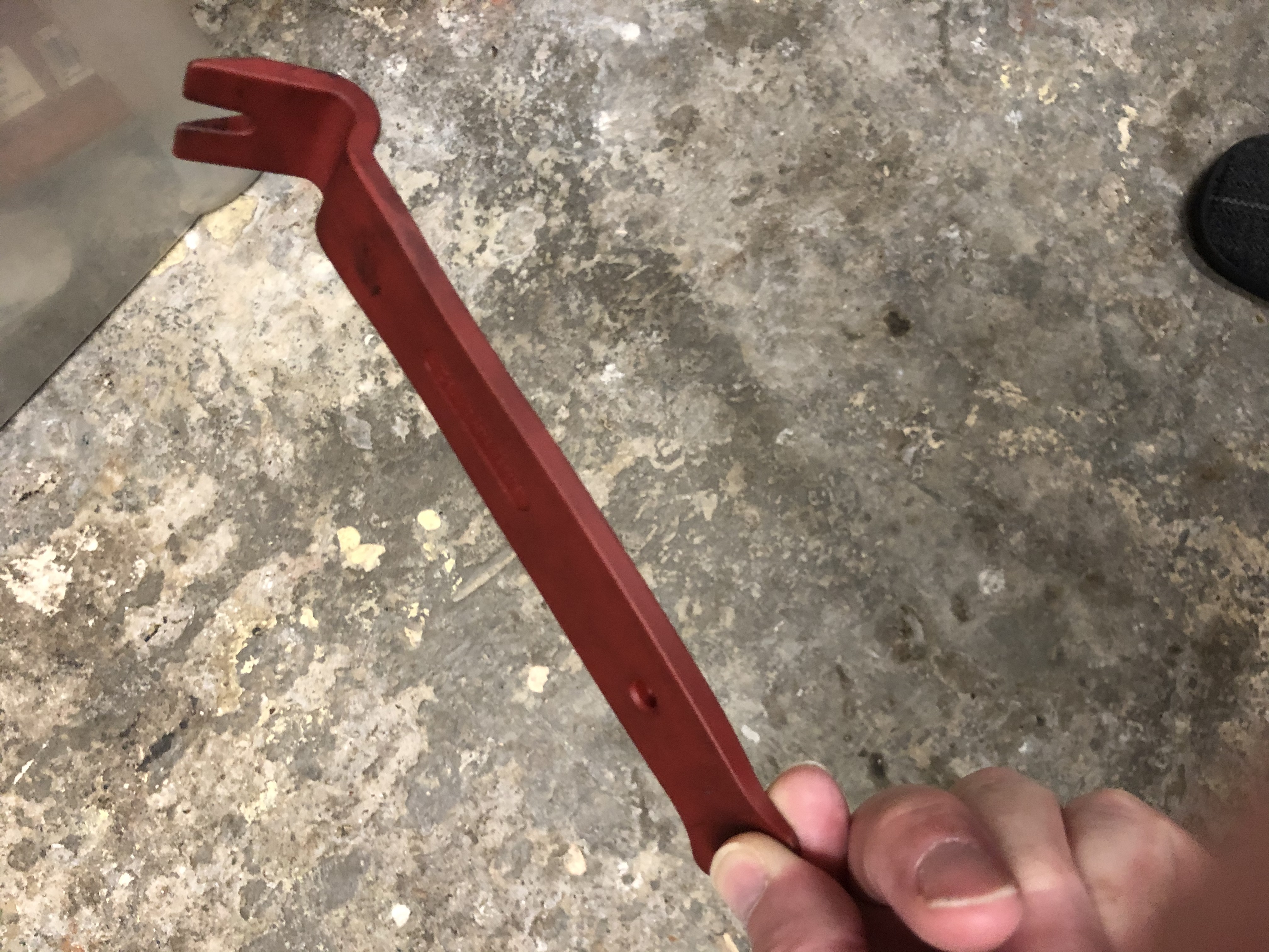

    Okay all the bolts are out and marked in the sequence the manual suggested the order of removal. Next the manual simply says remove the cover.:laughing: It won't budge and I suspect it is soft magnesium so I haven't tried prying. Tips?

    You’ll have to prise it up, there’s a rubber gasket which should have been fitted with silicone so will be stuck.
    I used a plastic pry bar when I did mine, like this:

    As for these TB connections, as @Col_C says, the pipes probably split causing idling problems so have been removed.
    It might be that the previous owner has altered the fuel map to compensate but I’d be replacing them with either vacuum tube as suggested or thick wall silicone tubing as I’ve done.
    You just have to be careful with the routing to avoid kinks, especially when refitting the airbox.
