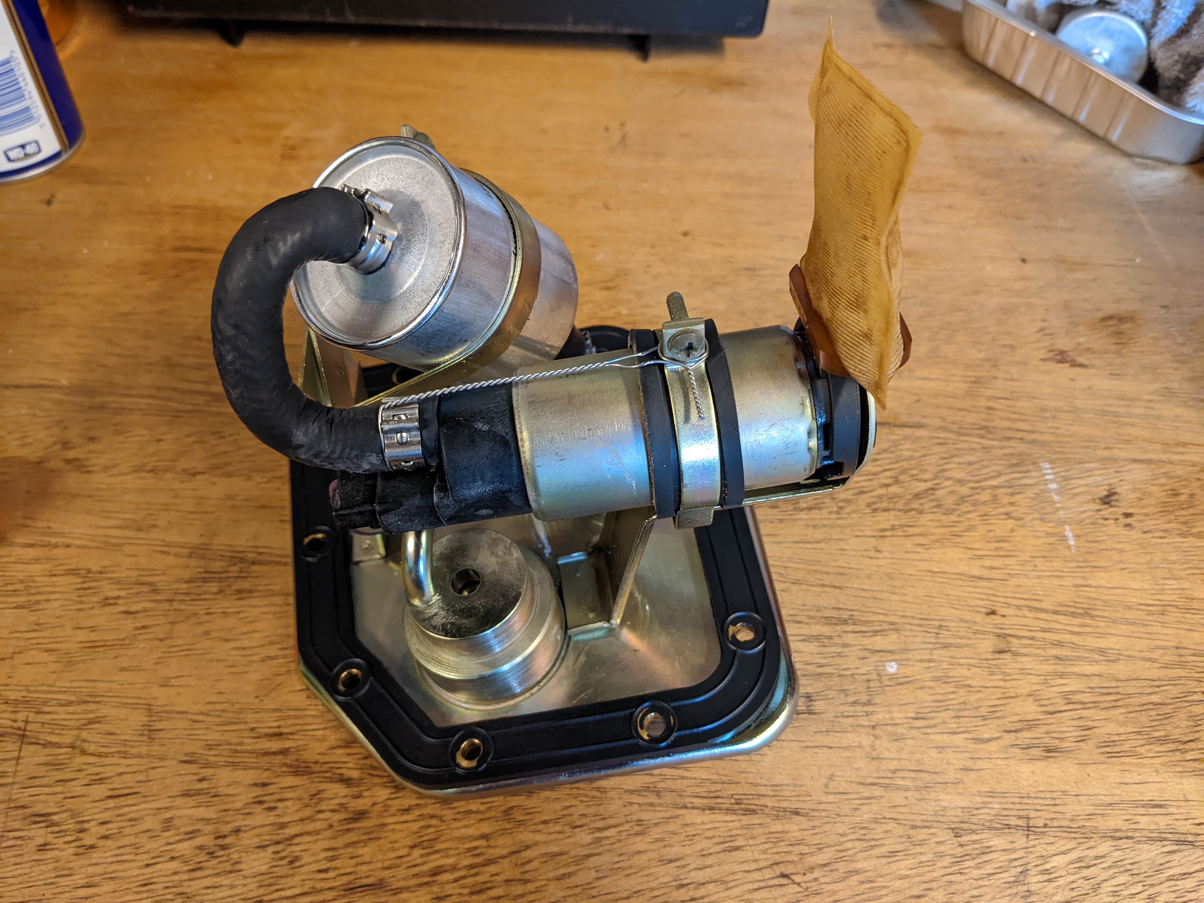

    I completed this job today at long last! :cool:
    @Iceman Thanks again for the advice.

    Did this for my 2008 America , hardest part is getting All that back in the tank ;):rolleyes: not really hard but more of a faff than I anticipated :relieved::p

    Bit late now but I would have replaced the gasket between fuel pump unit and tank - still if yours isn't leaking then all good!

    Good shout thanks, the old one was perished so did get replaced as well.
    There has been 5 litres of E5 in there for a couple of weeks now and no sign of any leaks.
