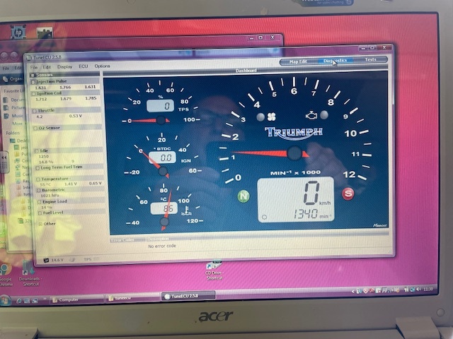

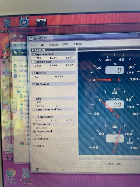

    Still not getting anywhere with solving the problem, these are some images but every think looks fine am I wrong. The bike won’t tick over long enough to do the 12 minute reset
  7. joe mc donald
    16,004
    @Buellbaker How did you get on with the bike. Seems you may need a carb strip and sonic cleaning perhaps rejeting. Also check all the safety switch's and ignition for faults and all earth points.
