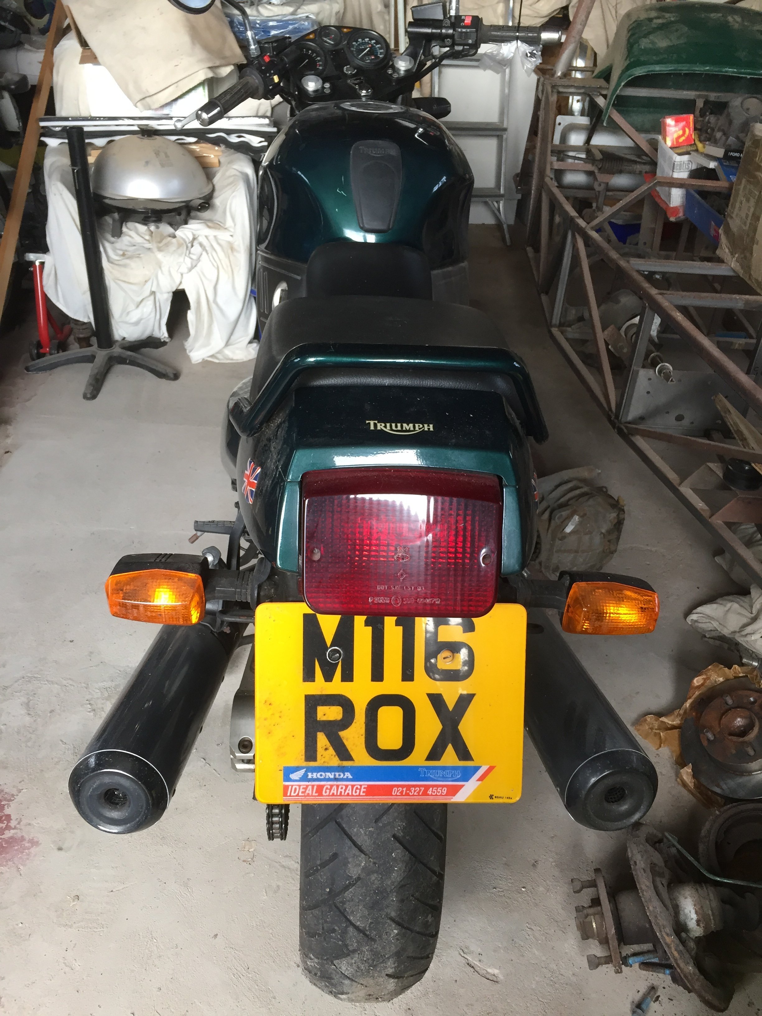

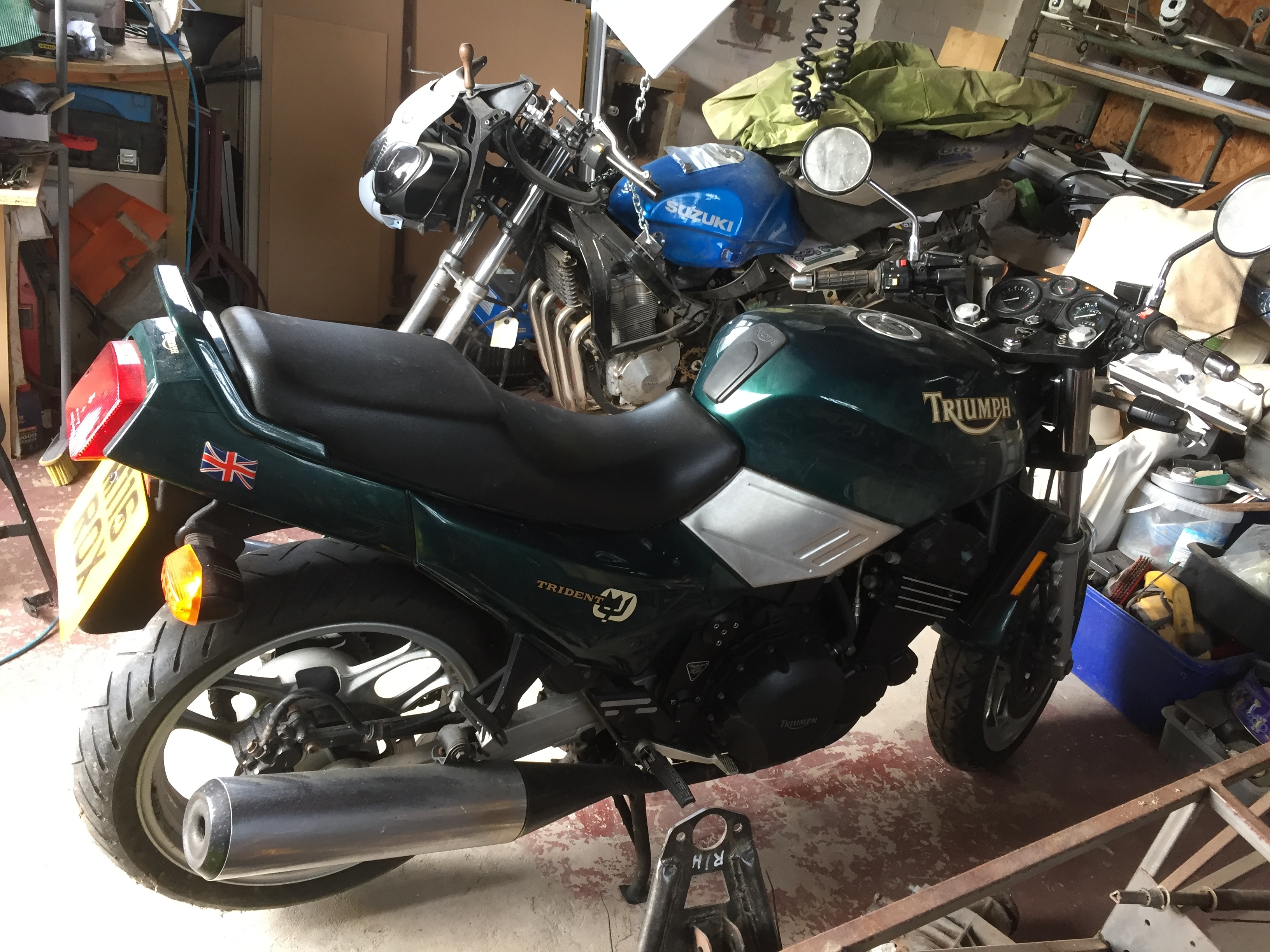

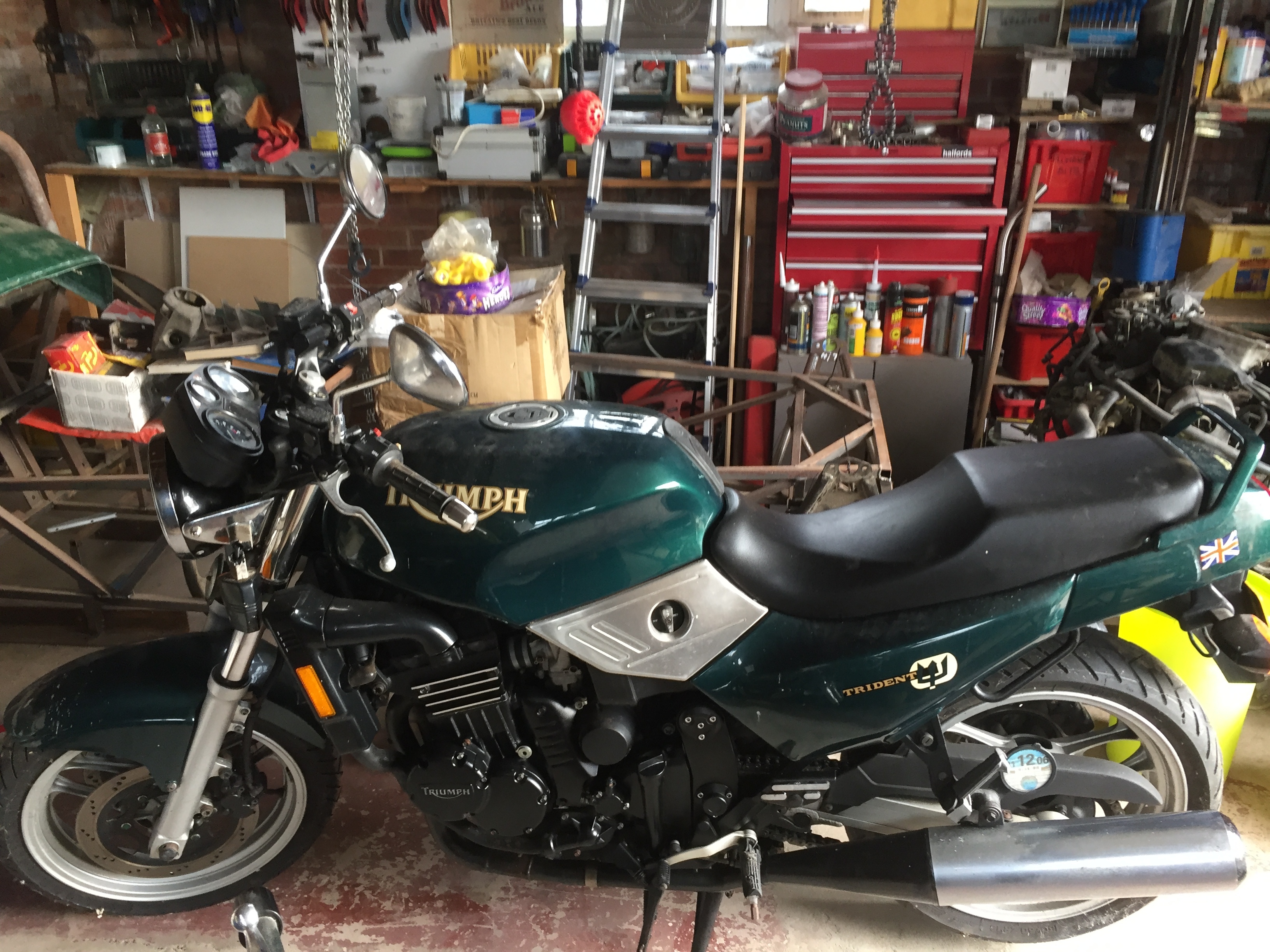

  4. Tony Hayden
    Tony Hayden Member
    Dec 9, 2019
    31
    Leicester
    Thanks for that. Some photos attached.
