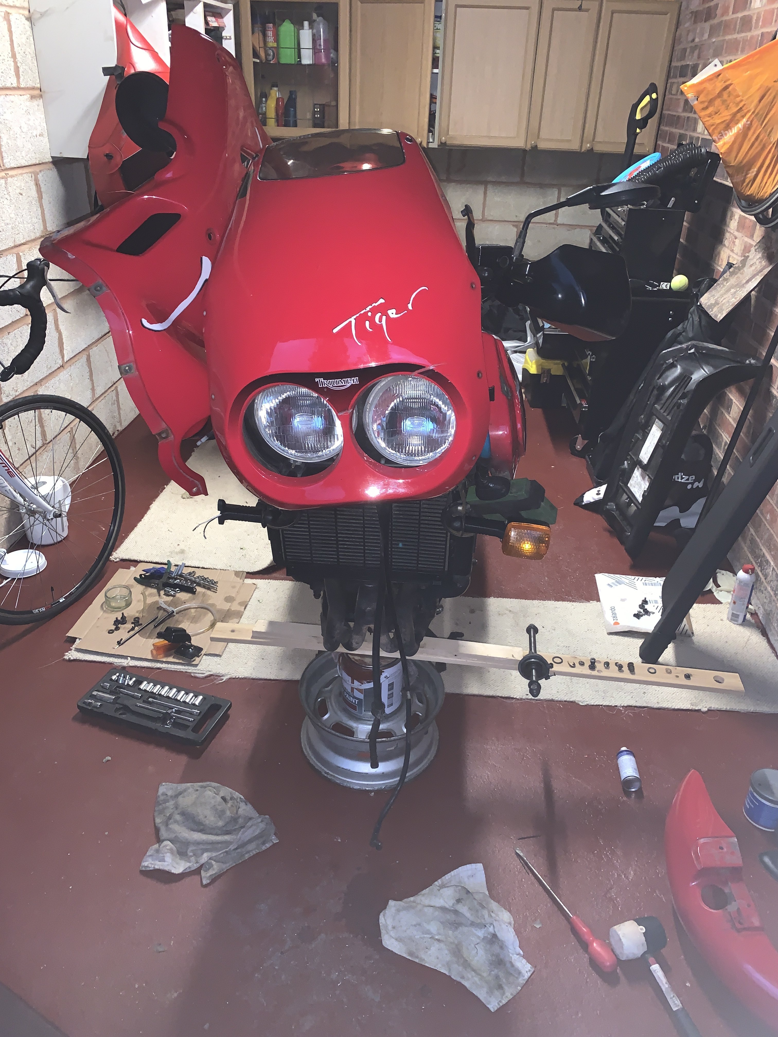

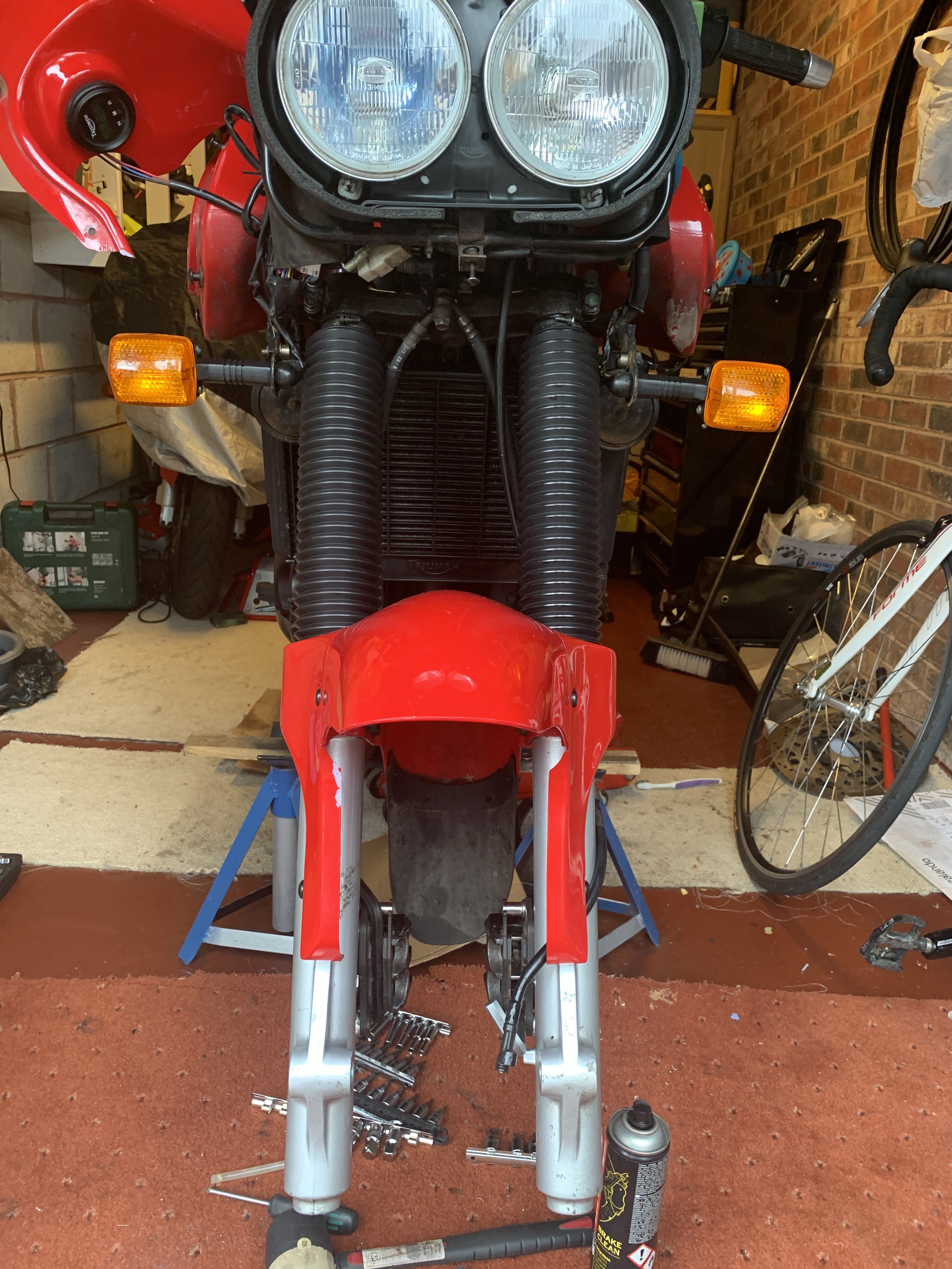

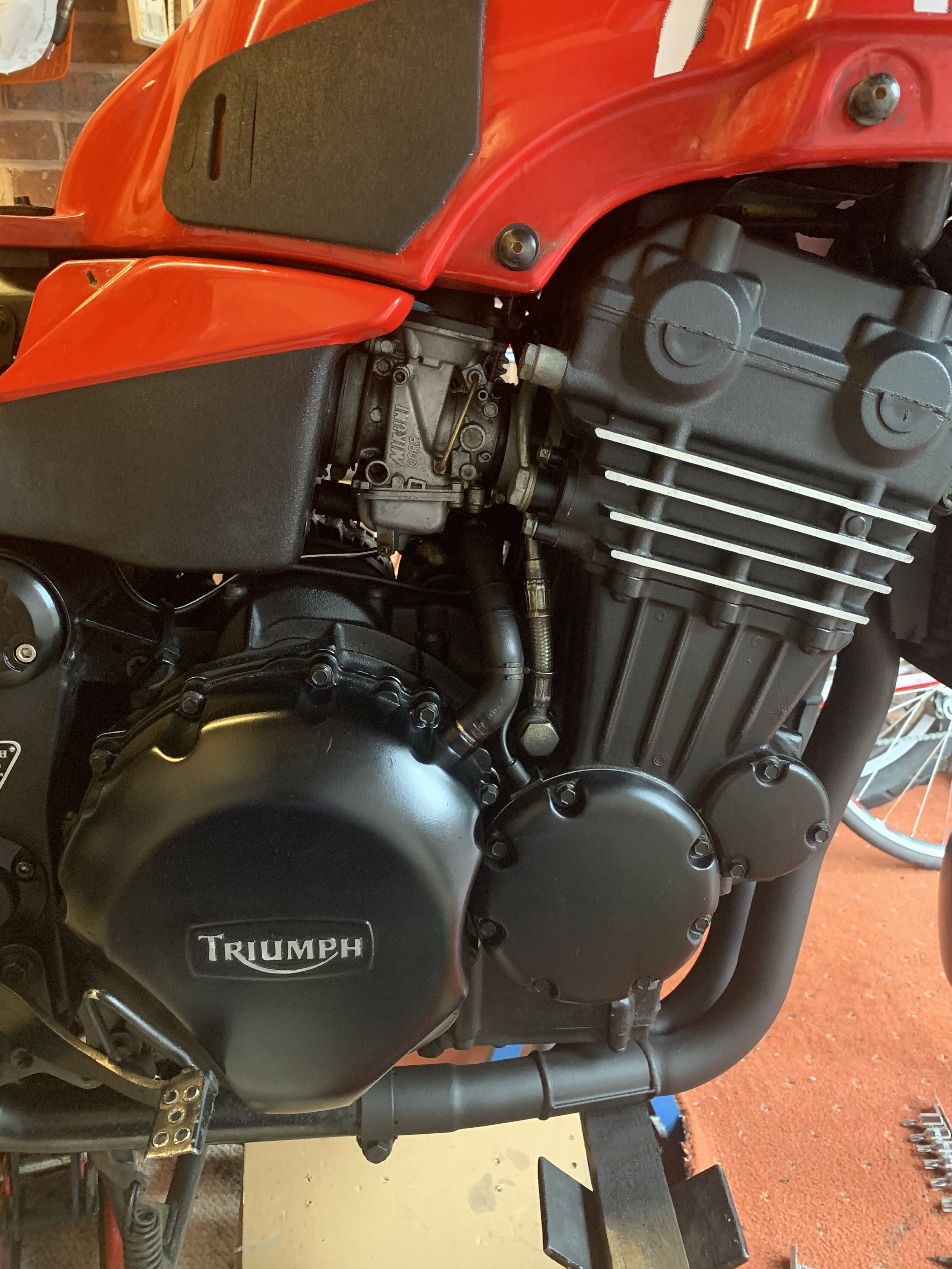

  9. Simon Logan
    Simon Logan Active Member
    Jun 13, 2020
    138
    33
    Sutton Coldfield - UK
    ......so that was before and this is during and after
  10. dilligaf
    Looking smart mate :cool:
  11. Don the Don
    2,947
    It's coming along fine mate be nice when it's done
